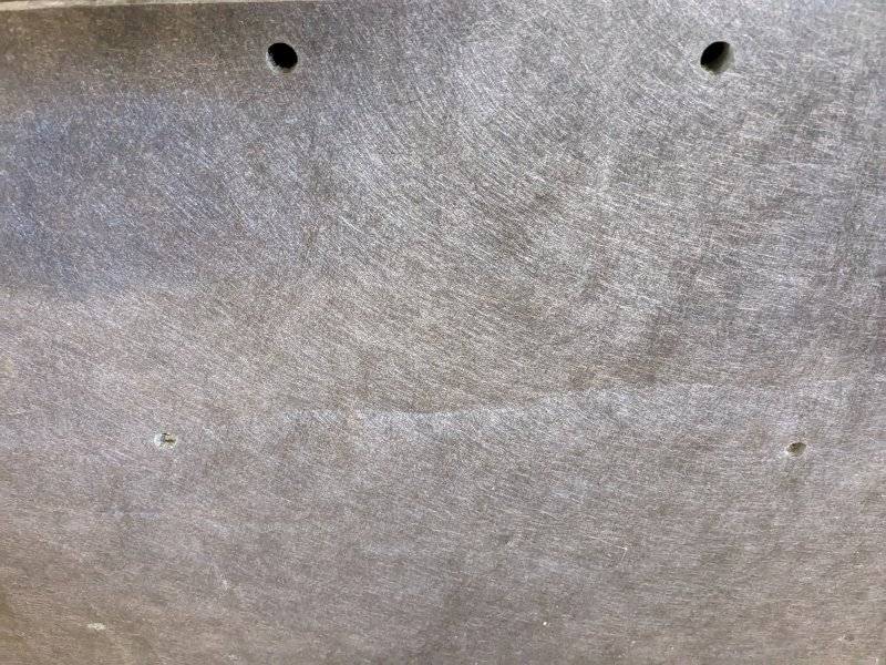

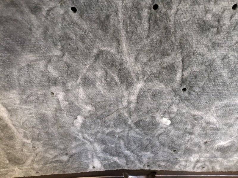

which side goes against the hood ????
smooth black or textured gray
Smooth to the hood.

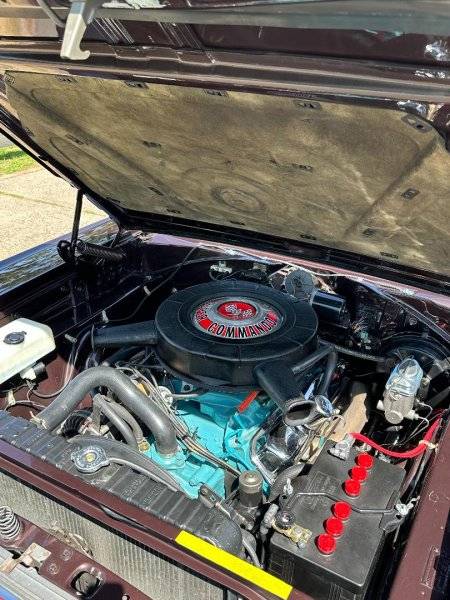

That is a generic thick one, it can rub your aircleaner if it sits up high. Now they sell a molded hood pad which is closer to factory and not as thick.

Hold it up to the hood with the smooth side visible, then flip it over. Whichever side looks best to you is the way it goes in.
I'm guessing lumpy side facing the hood is going to look cleaner.
why would the smooth side go up?
Why? Because the factory part doesn't have a smooth side, both sides are rough. And it's molded so it can only go on one way.
That aftermarket piece of **** he has is 2 inches thick, it will be like an SOS pad on your 440 GTX pie tin, and that's a $500+ mistake these days,
Even with the molded hood pad if you use any type of spacer on the carb/manifold it will be a brillo pad....prev owner did just that with mine :(
