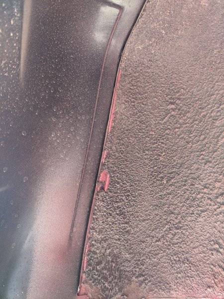

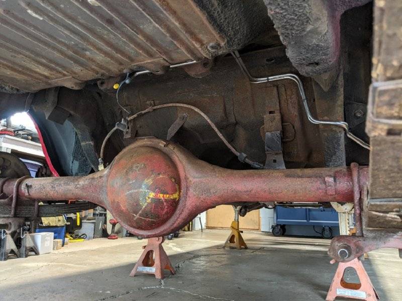

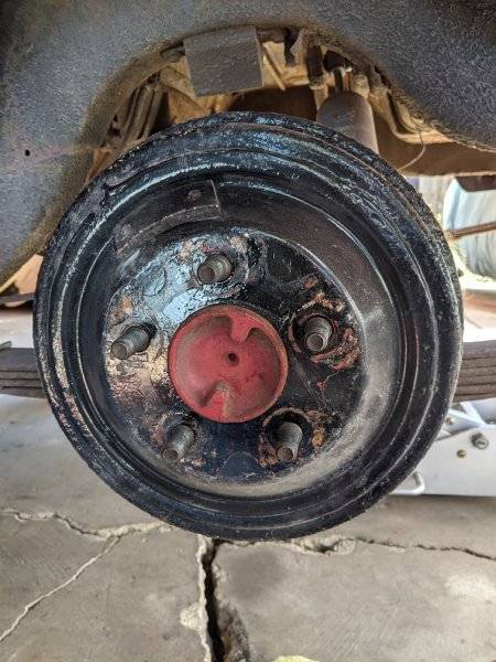

It could have been. The owner daily drove this car since new until the mid-eighties. We are (unfortunately) in Illinois, so the salted roads really took effect. Between the undercoating and the oil leaks, most of the floor was in great shape...lol
Back in the day, no manufacture did any type of corrosion protection. Didn't matter if it was U.S., Japanese or Euro. Is the shop applying and inner coatings as they work?
This car was completely undercoated when he purchased it. Much of that has come off already, but I assume the dealer did it as he told me he has not had it done. The shop did not coat anything, but I will be applying some undercoating to the inner and outer wheel wells, as well as the inner fenders. At this point, the car will be driven to shows and for enjoyment, but not during winters or even rain for that matter.
Not just undercoating but rust preventative sprays/inner frame coatings/cavity wax etc. Get into those inner areas that undercoating doesn't touch. Many of the products have long wands with multiple spray nozzle heads. Great for slipping into inner areas through various holes. Eastwood is a great source and there are others too.

Some of your undercoating shots look like mine. Snow drifts.
Most of that undercoating I believe was applied at the dealership back in 1968. I'm not sure if any of these cars were undercoated at the factory. I am just touching up what I can with the spray on undercoating from a can.

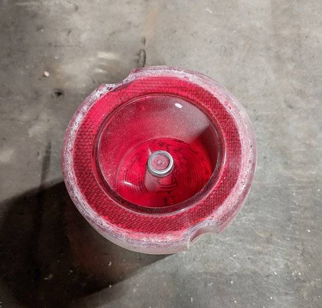

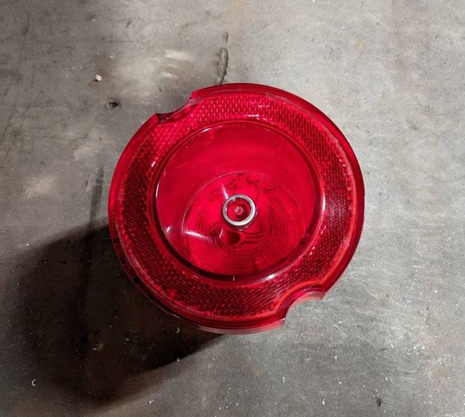

....and a few more. The factory taillights have seen better days, but the owner is not ready to drop $1500 on new ones, so I cleaned them up as best I could.

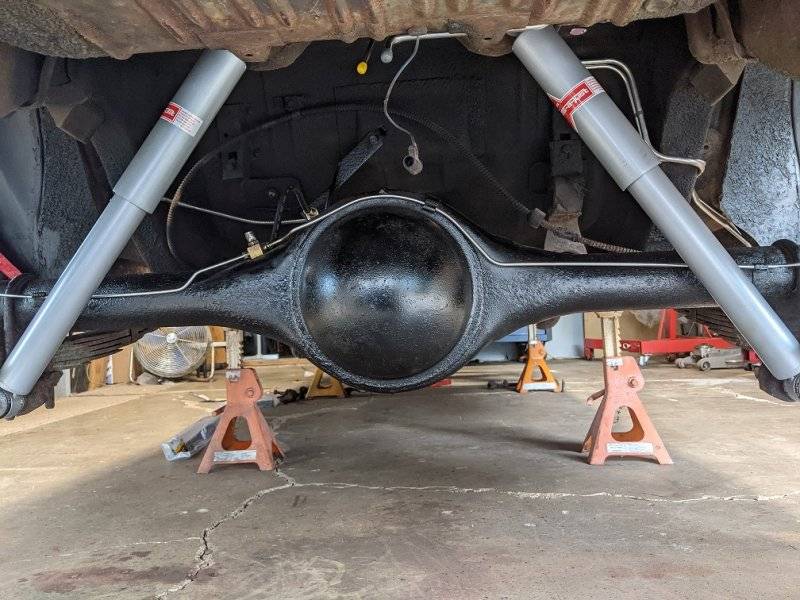

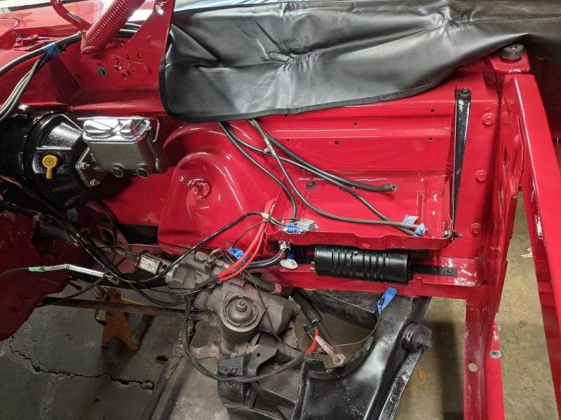

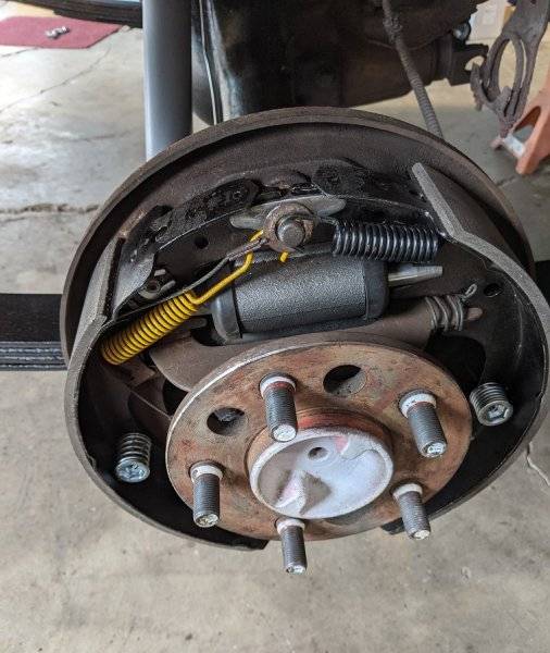

Looks good, but please clean the paint off of the upper shock hardware and heater box retaining nuts. You're doing yourself a favor by doing so.

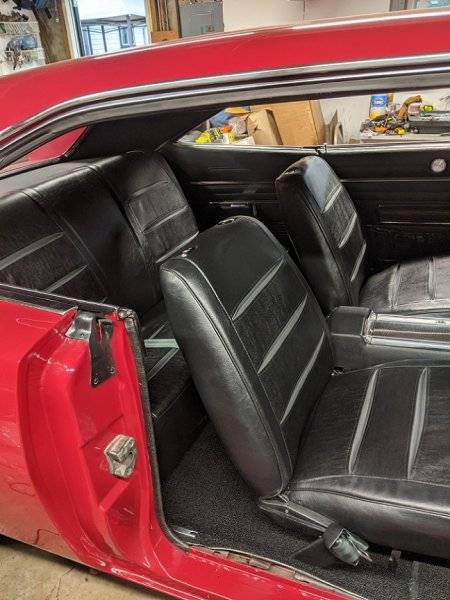

Hey everyone, sorry for the long delay in postings. The car was just delivered to the owner this past Sunday, so now I can finally share the rest of the photos. We had some hiccups along the way, which is the reason why I have not been able to post until now. Enjoy!
