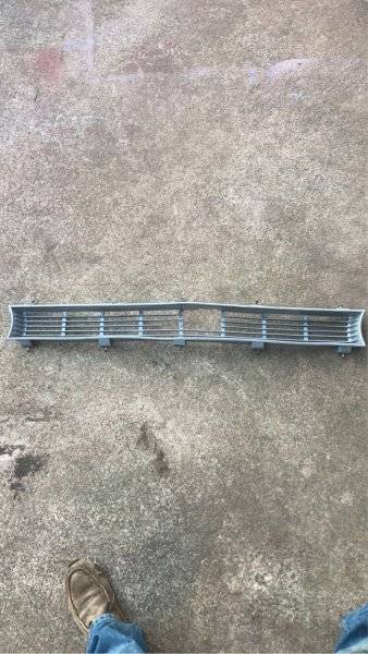

Can anyone tell me the proper paint color of the SS/GTX grille? Ive heard its two different colors.
The car is just a driver, its not a fancy resto job. I just wanted to know if theres a proper color before I paint the entire thing Argent Silver.

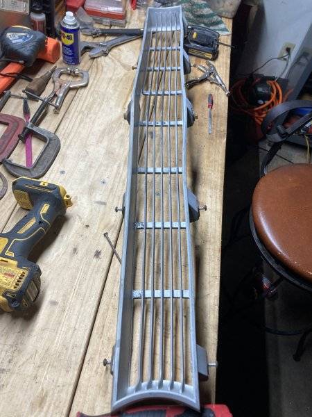

I just got done replacing about 5 fins in it and a couple cracks.
My buddy has a 3D printer and was able to copy the fins after I gave him the dimensions. Worked out well. Clamp into place, JB Weld, and plenty of dremel work and a small file.
The center fins should be dark argent. Some good pics here:
FOR SALE - 1968 GTX grill - nice condition
Just FYI, I tried the 'dark argent' from a few different sources and ended up going with the one from Herb's as it was was noticeably darker than the others, even though they all made similar claims on correctness...of course your results may vary so it might be worth it to get it from a couple of vendors and pick the one that looks best to you.

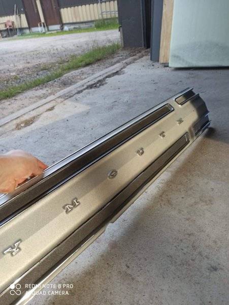

I did my own paint match with just random spray cans because couldnt get argent in finland.. Used grey wrinkle spray, then aluminum and matt black, skiped black for lighter shade
