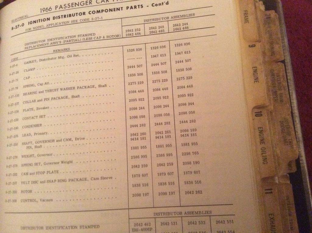

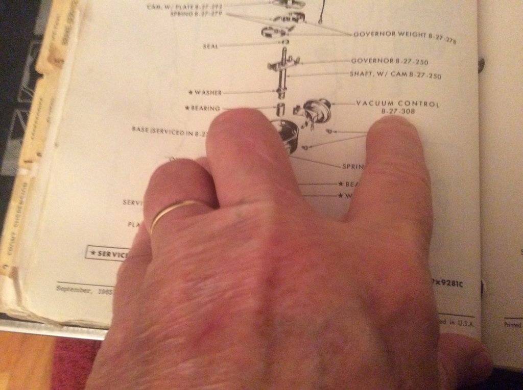

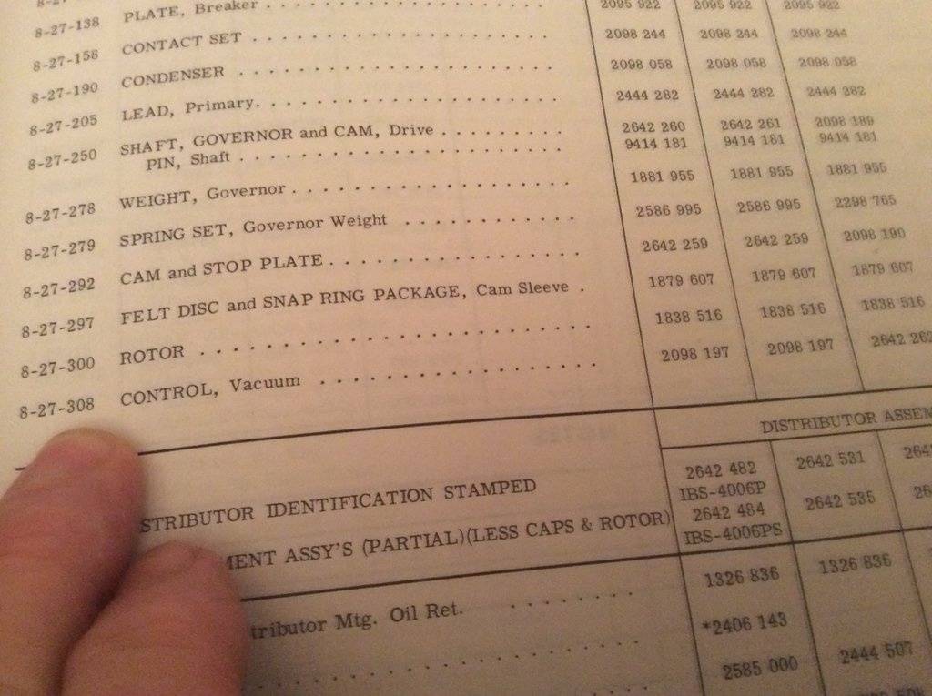

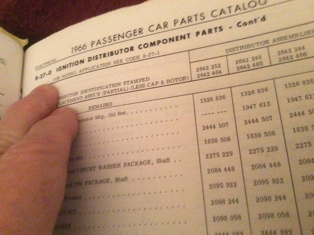

You use those numbers locate the section where the part numbers. If you look at any distributor in the picture section it will have the same number. You'll have to flip pages to the part number section. It past the picture section. You'll see 8-1-1 then 8-1-2 etc until you get to what your looking for. You might want to jump 20 pages and look for the codes. I have a 66 parts book and downloaded a 66 parts book from my mopar and found it hard to use. If you don't have any thing else...
Hope pictures help? this is out of my 66 parts book. Last pic is a full page of where p/n is. At the top of page you'll P/N's of distributor's assembly's find your's and go down that column.
