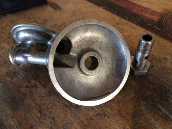

The cheap summit brand headers had the steering shaft running threw the one. As for the oil filter you had two different setups straight on or 90° I always kept the 90° deal as I found them you just unscrew it then the straight one will work some headers required one kind others required the other .
Just order summit headers for 318 71-74 b body get that fixed then go from there I'll look to see if I uavevan extra adapter!
Ok there's one on eBay here's pictures too
