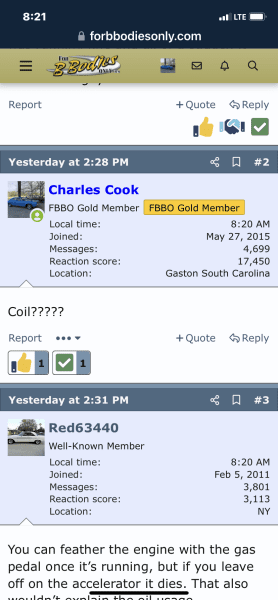

You can feather the engine with the gas pedal once it’s running, but if you leave off on the accelerator it dies. That also wouldn’t explain the oil usage.

Coil???? Not bad coil. Lol
