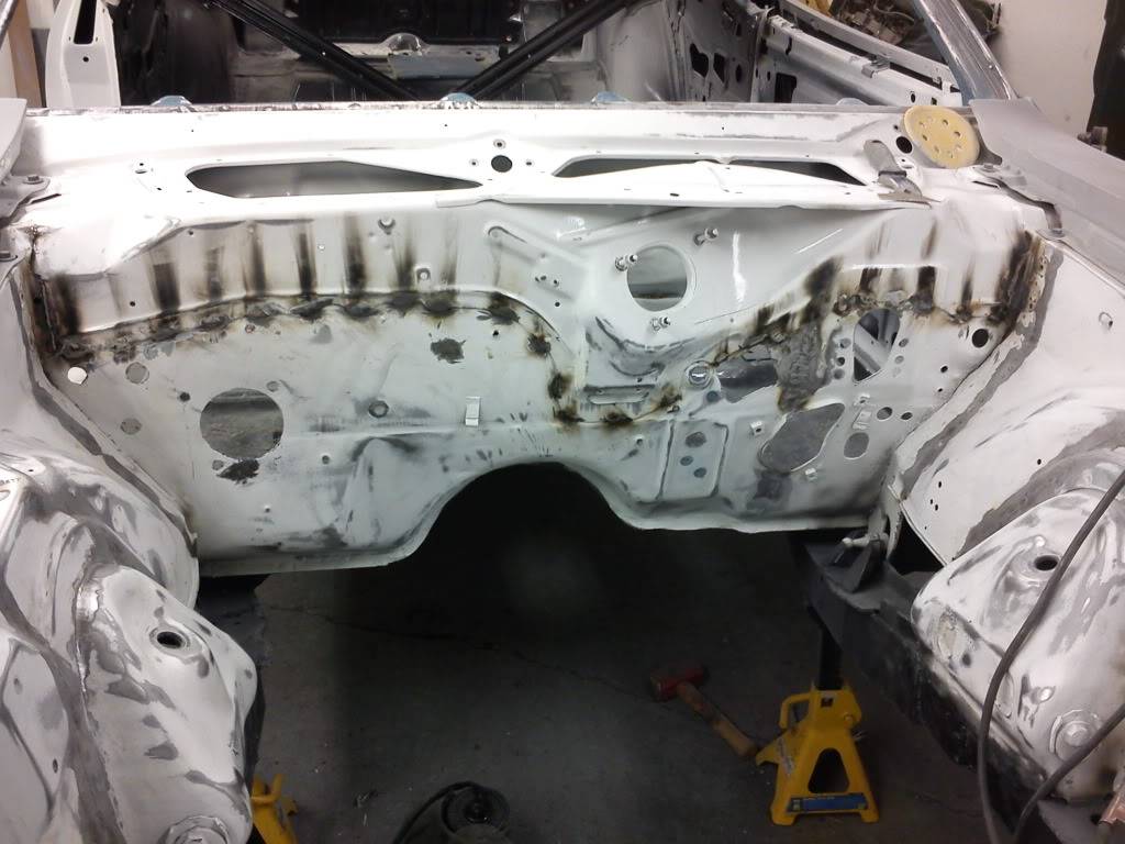

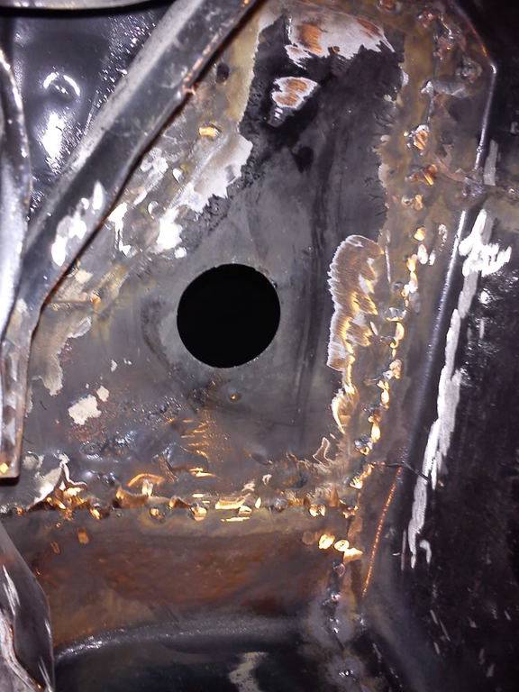

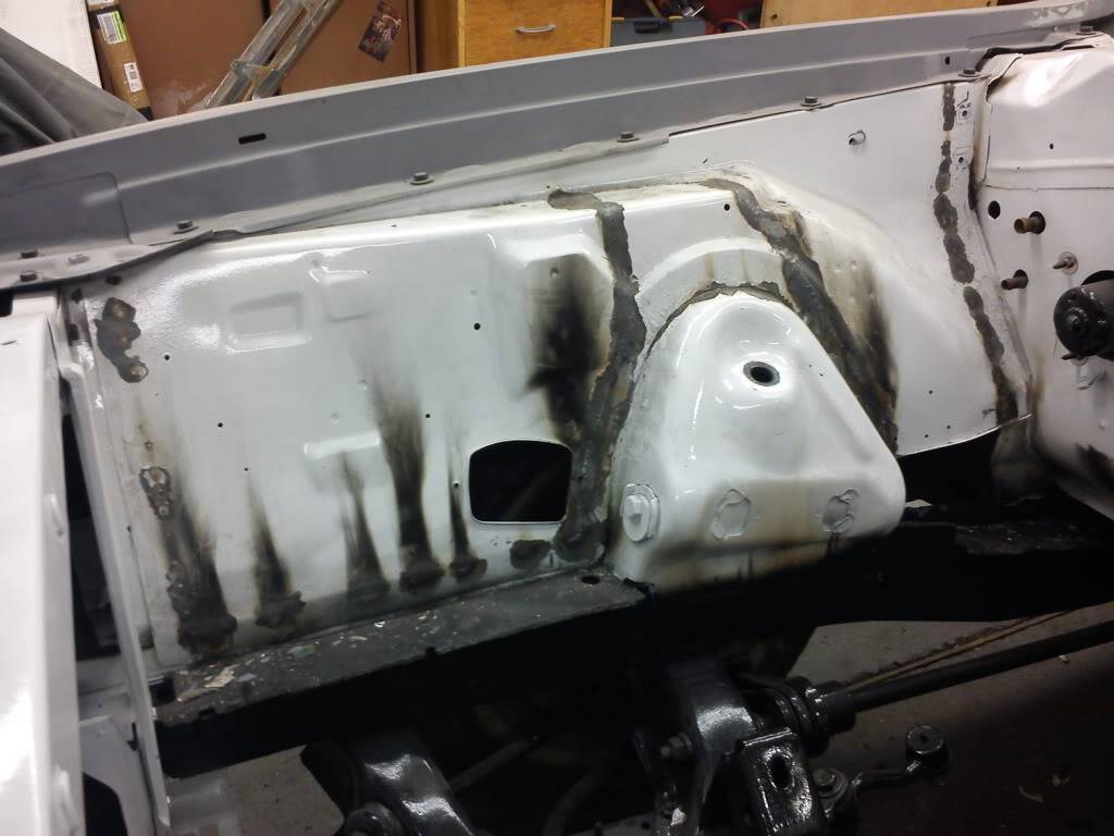

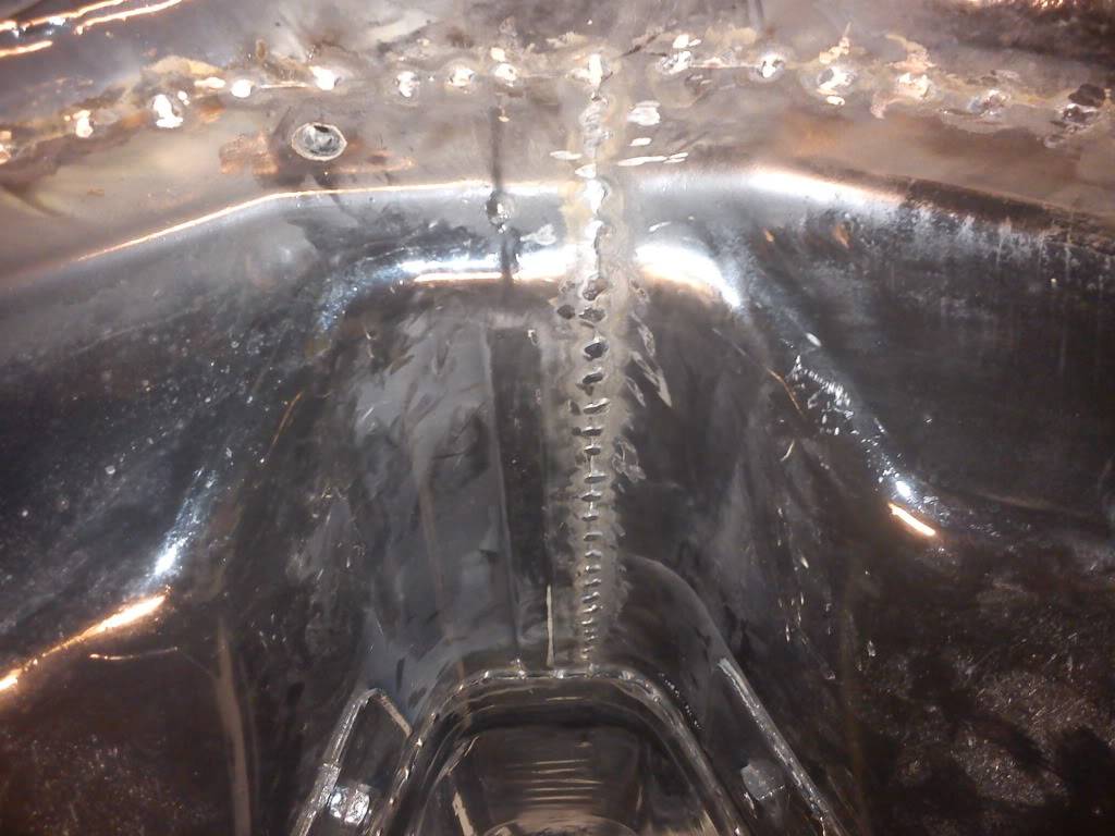

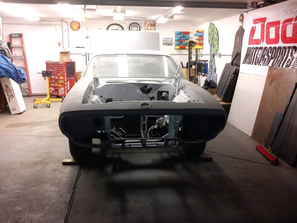

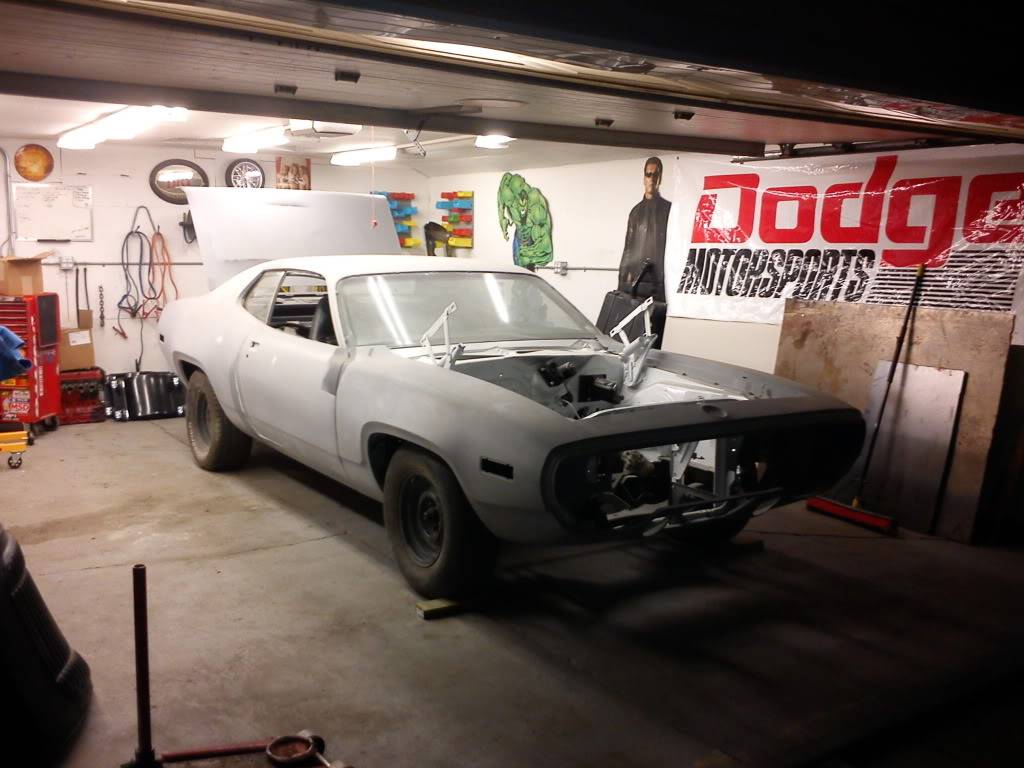

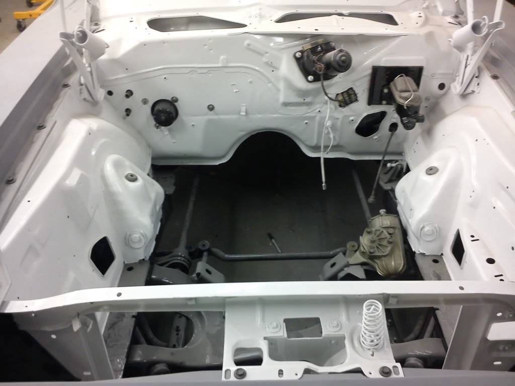

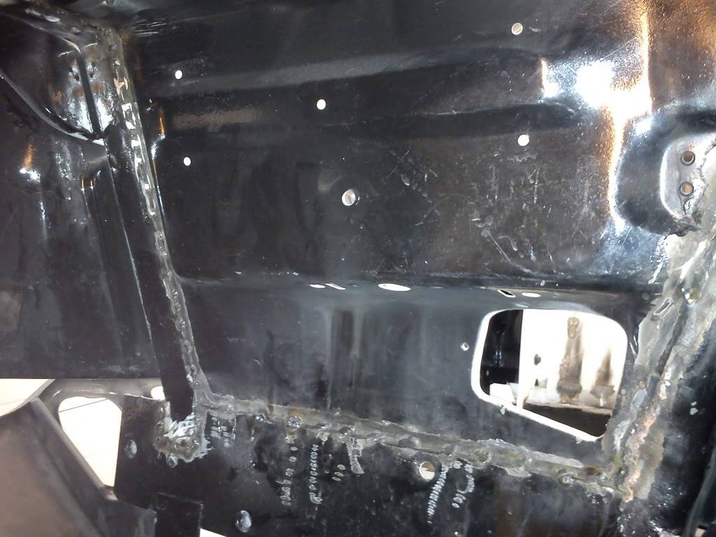

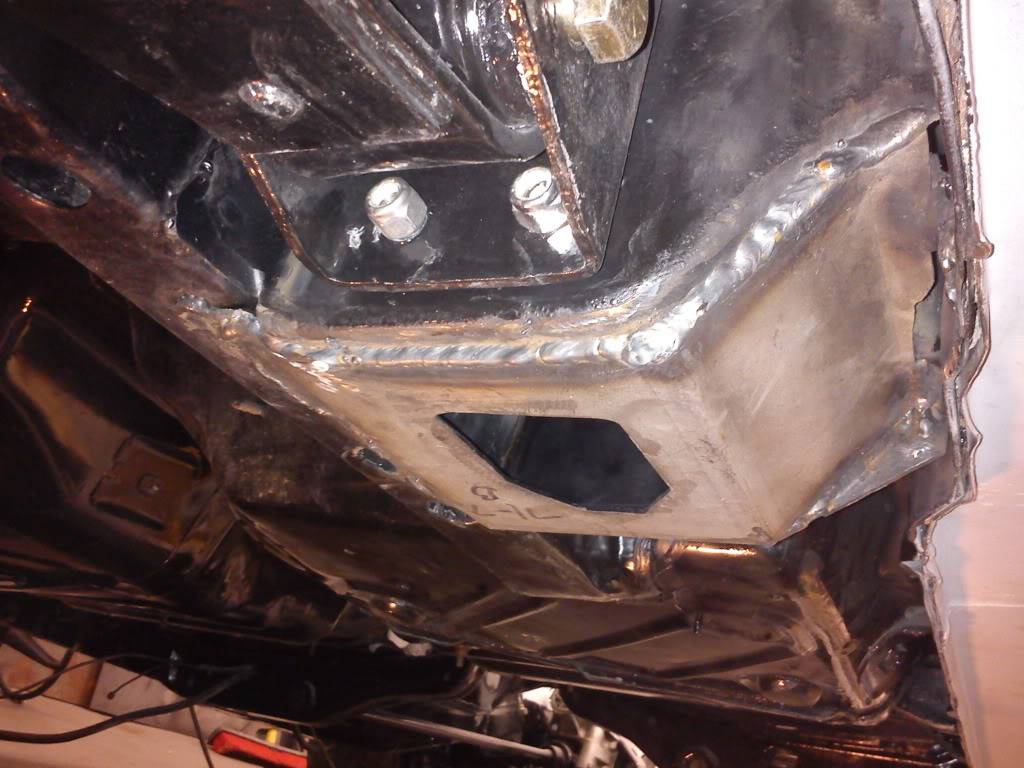

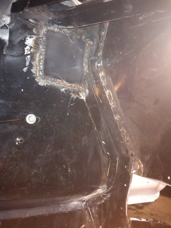

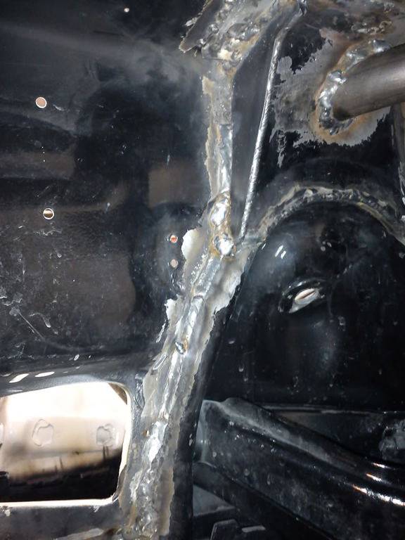

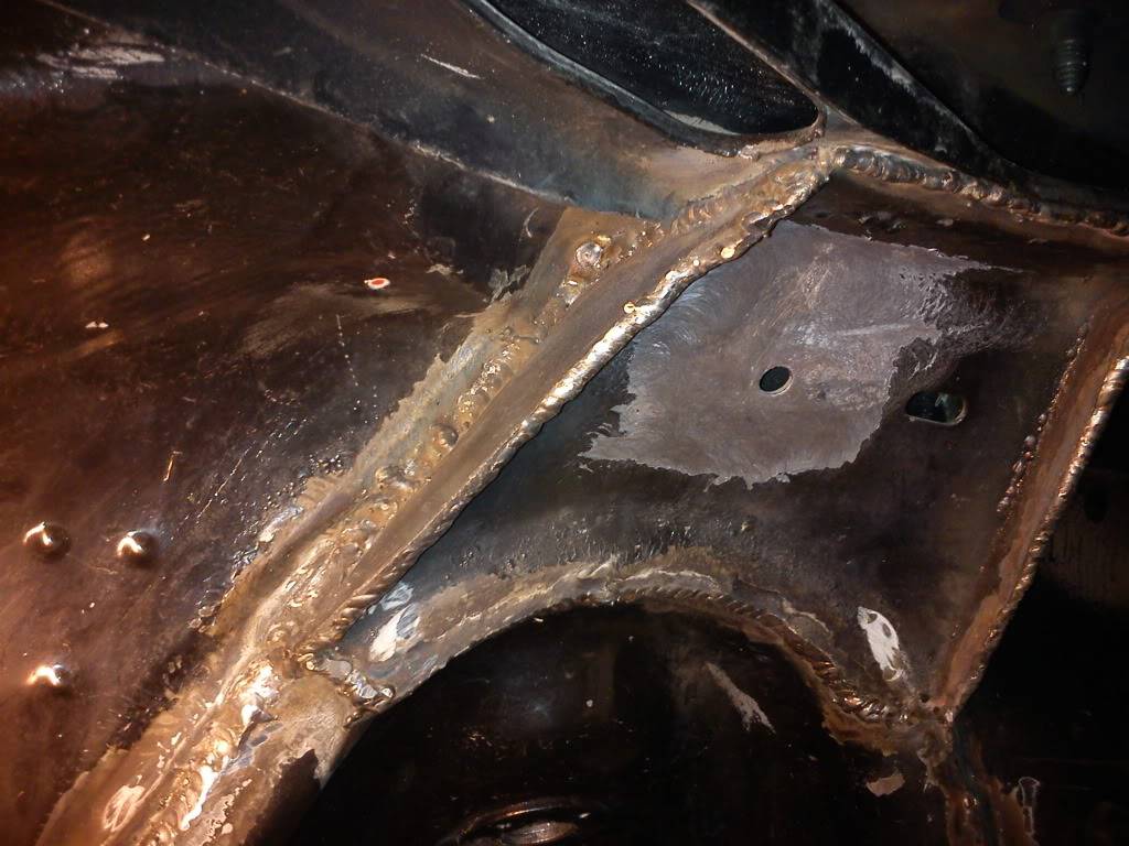

Its officially at the body shop to finish some body work in the engine bay (due to me spot welding, boxing strut towers ect.) and some body work on the rear to get the lines perfect around the wheel wells. Then It will be painted!!!!:)
Its gonna be quite the thread dump of pics - I've been way to busy with work, renos and this project, Now i can actually post more regulary with all the some things that have to get done before the car returns - but here you go:

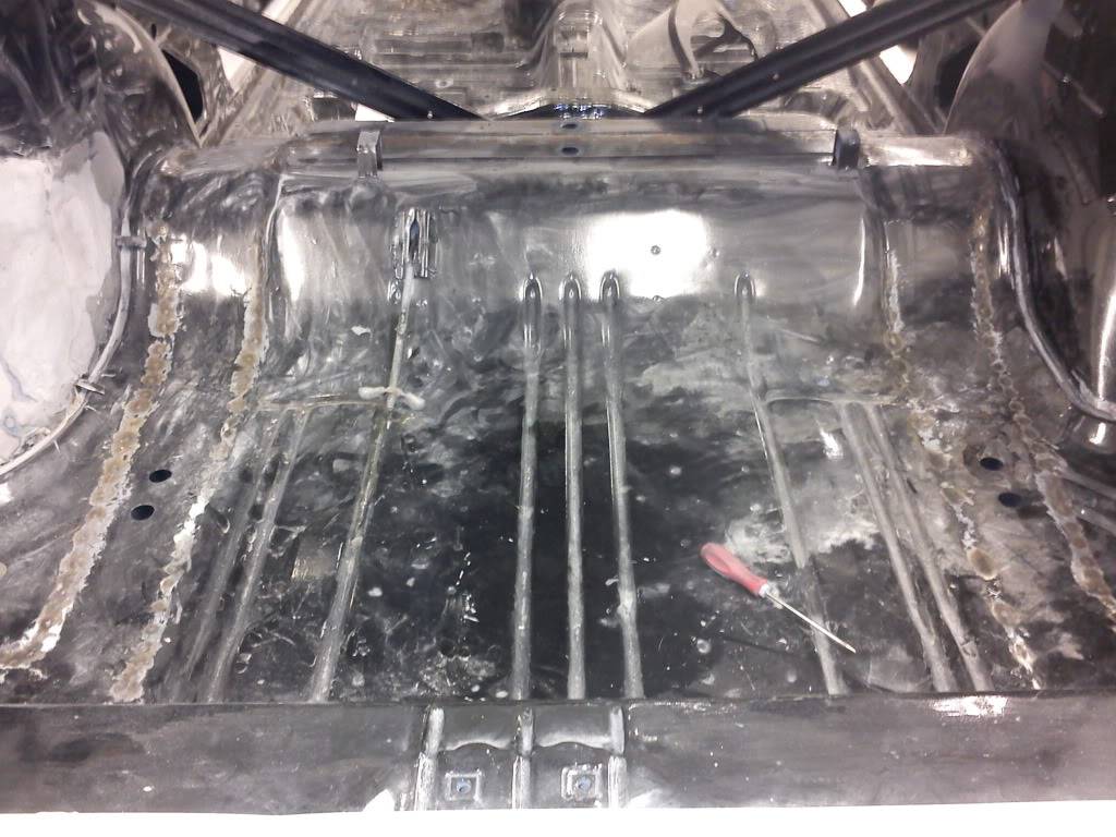

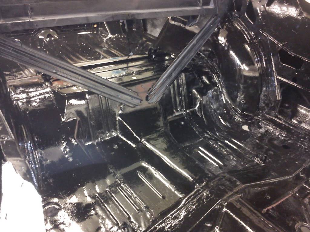

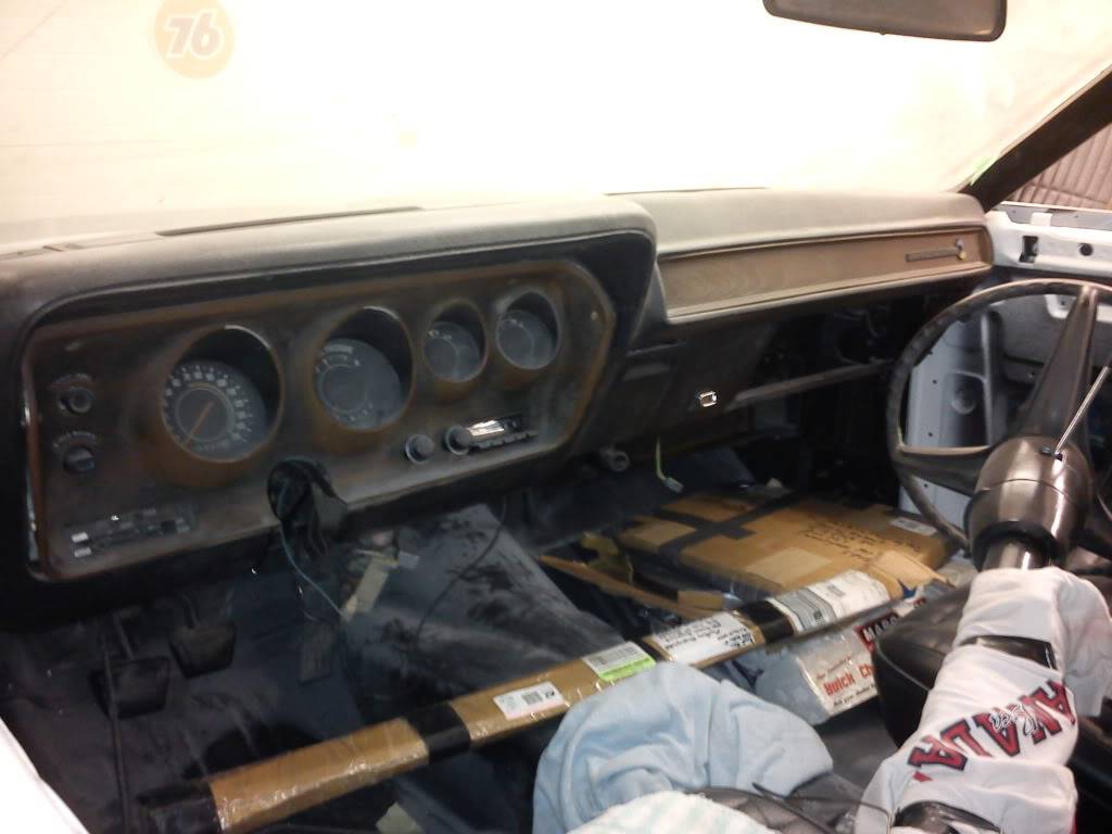

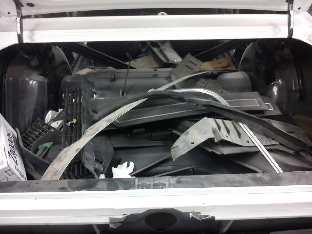

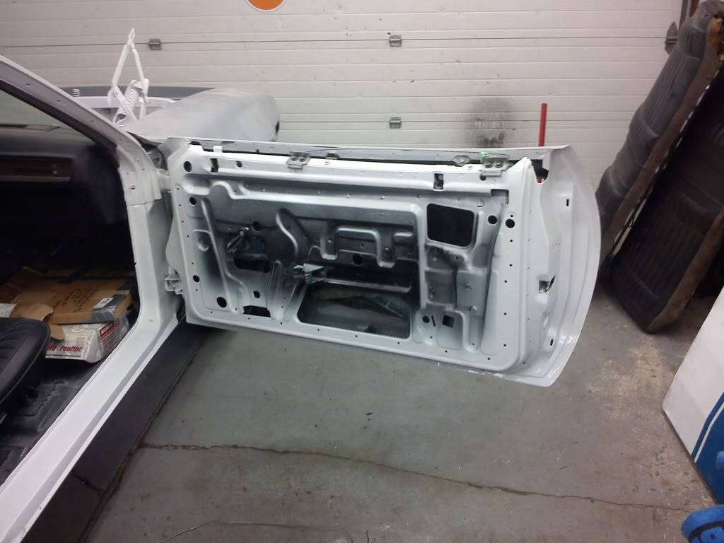

Pulled the windows, dash and everything out so i can por-15 everything, doors, innerfenders, My hands and arms had por-15 on them for 2 weeks! that stuf just wouldn't come off:
(these pics for my own reference lol)

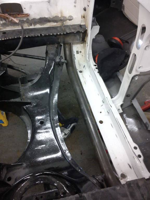

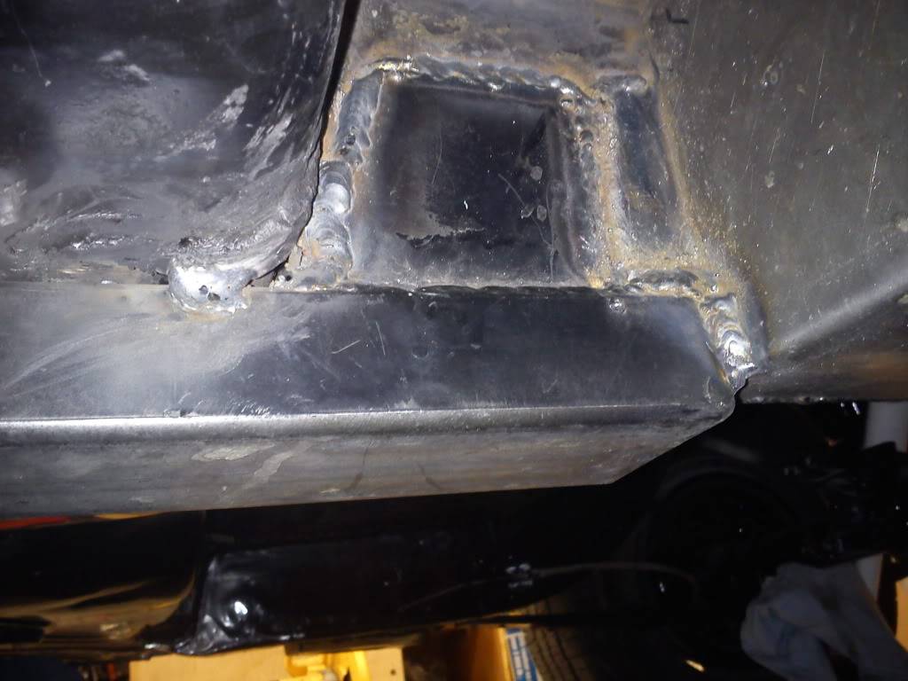

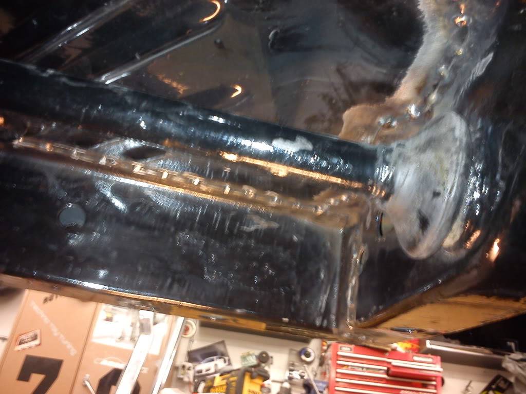

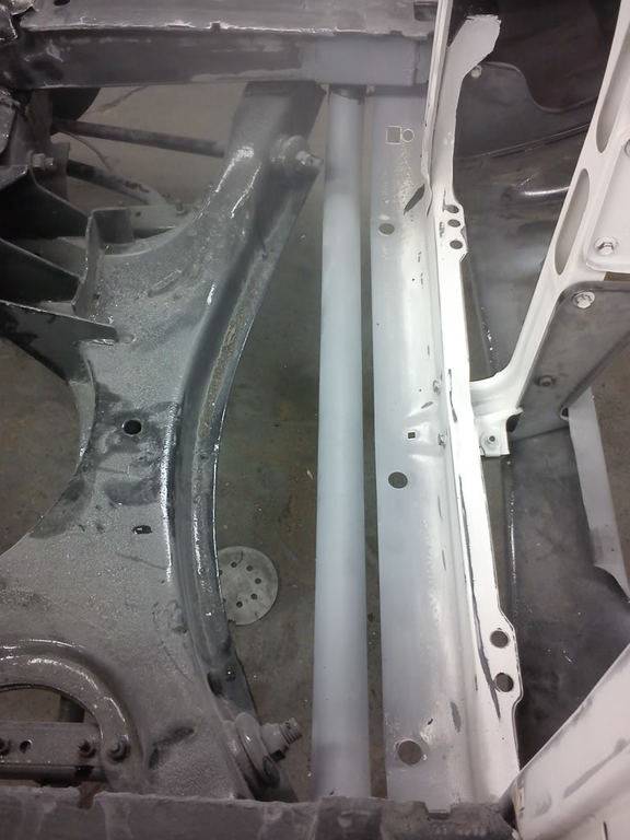

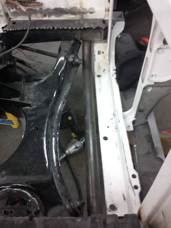

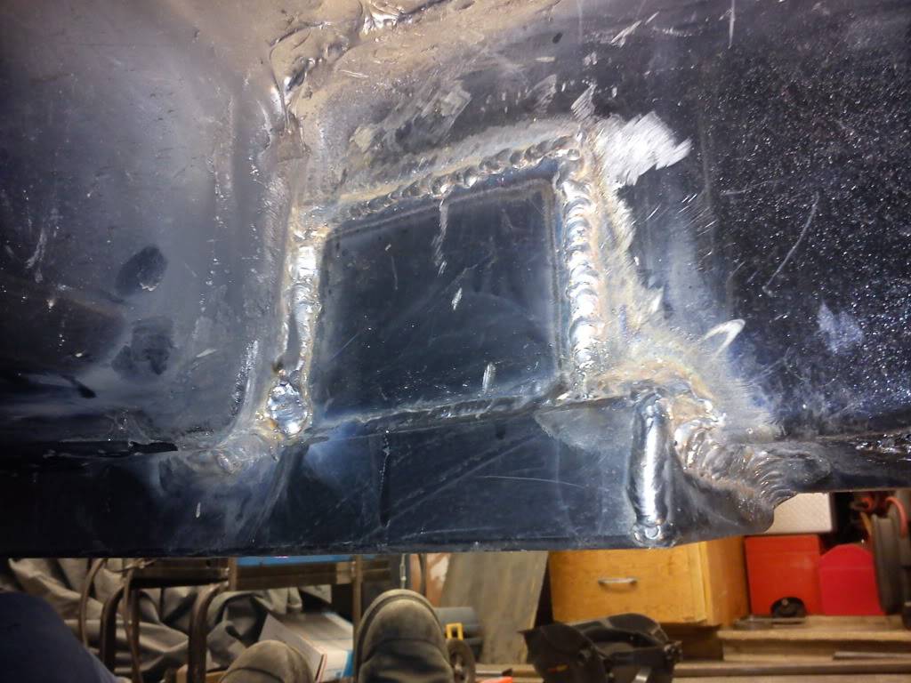

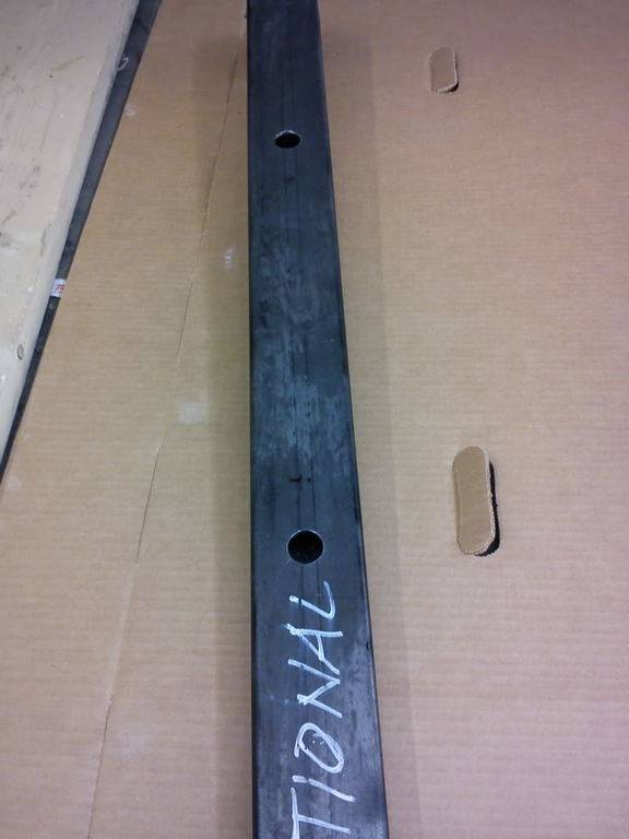

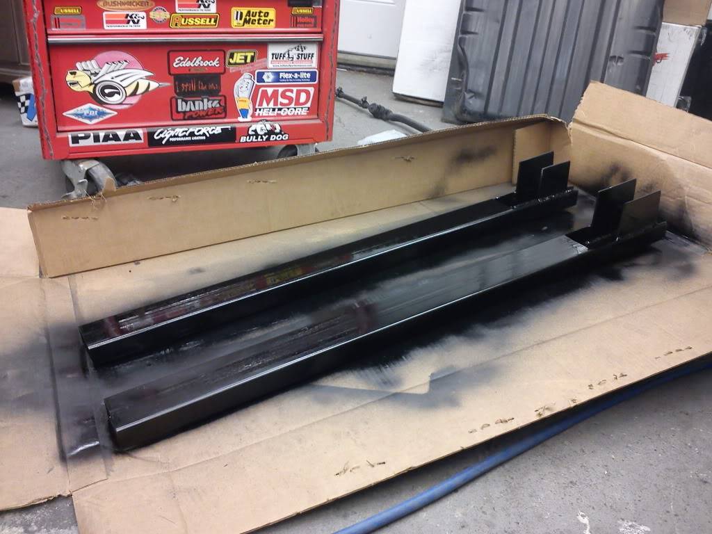

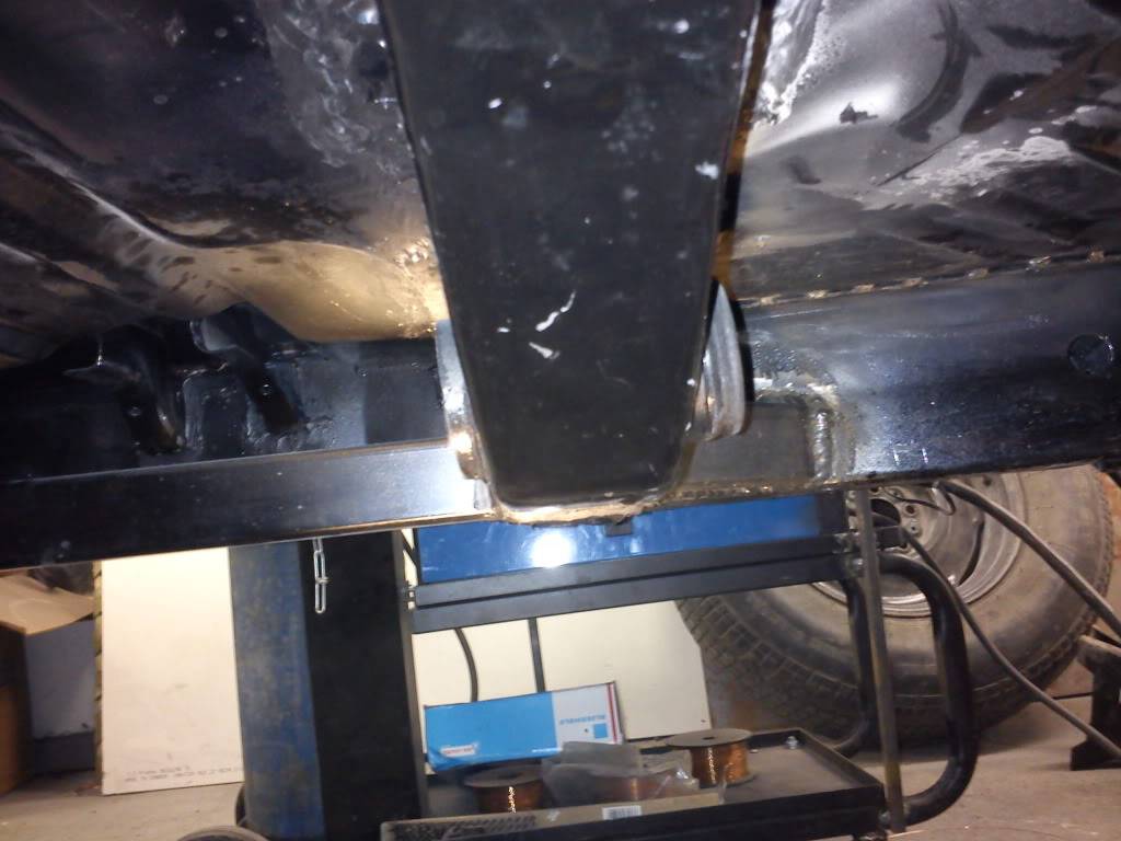

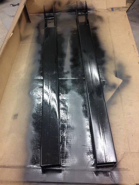

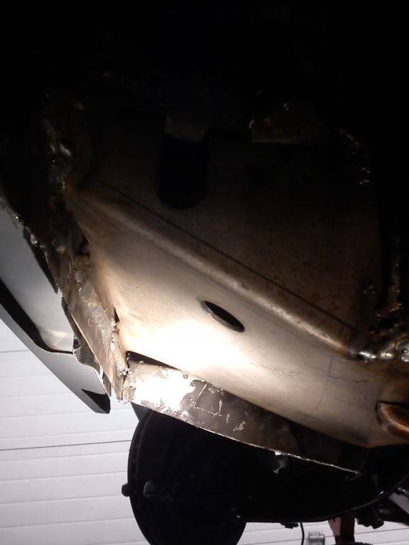

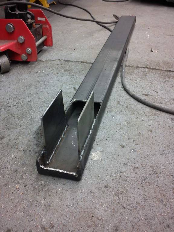

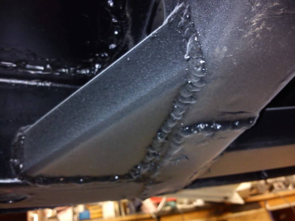

subframe connectors made from 1.5"x3" .120

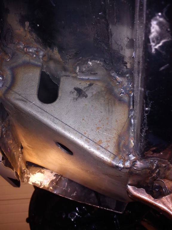

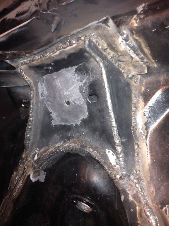

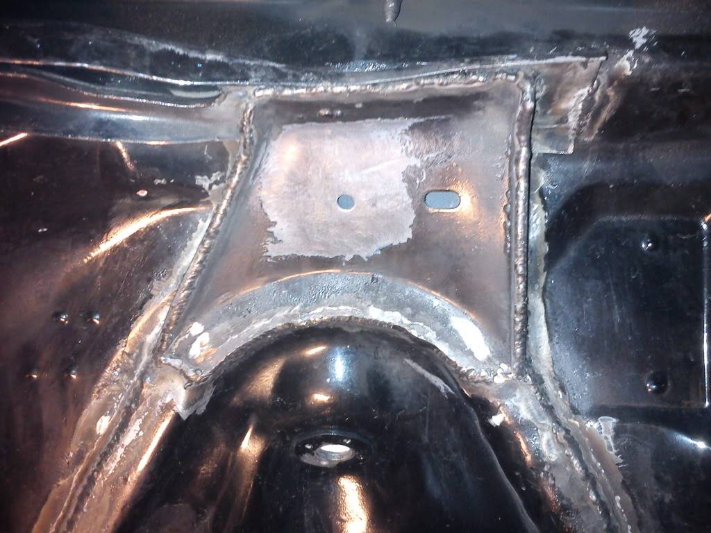

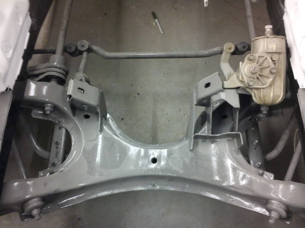

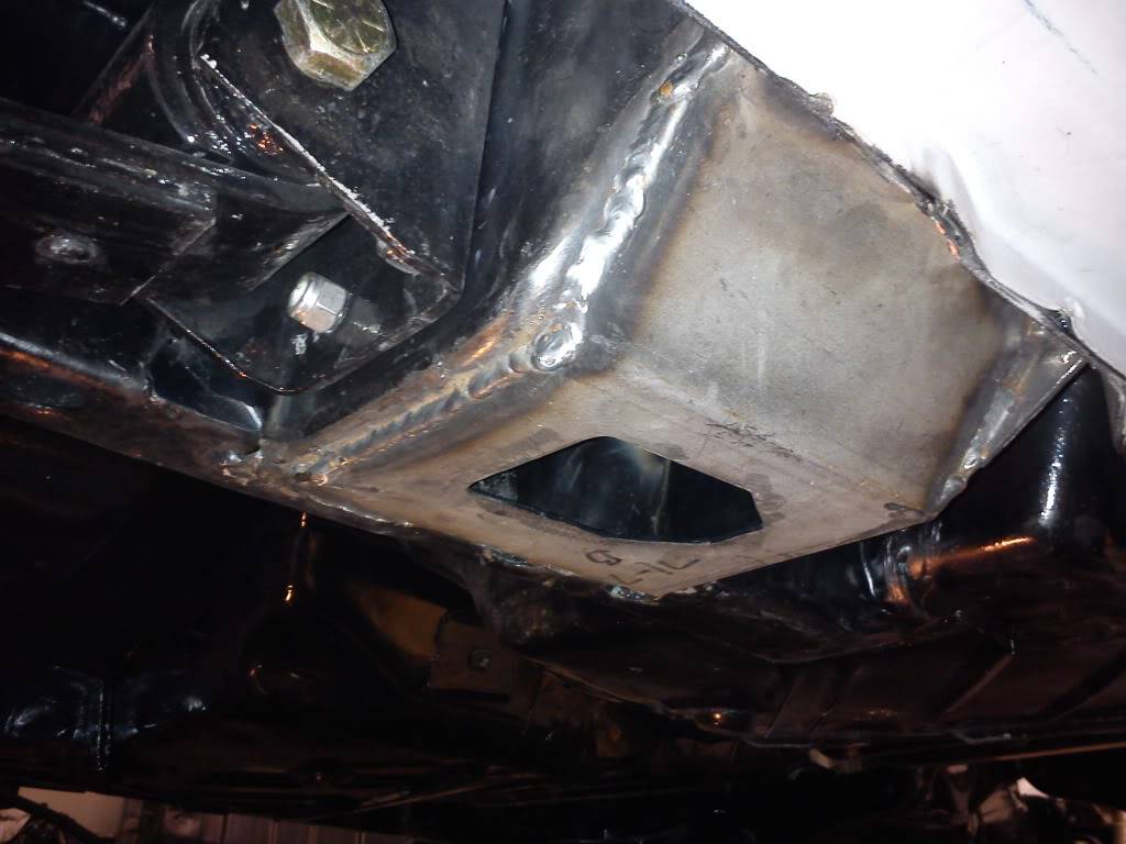

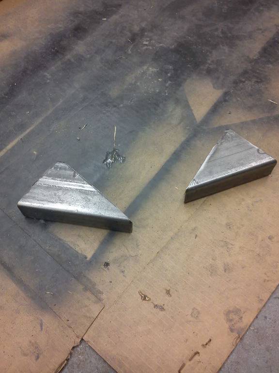

Made these from the left over 1.5"x3" to box the corner of the torion bar brace to front frame rails:

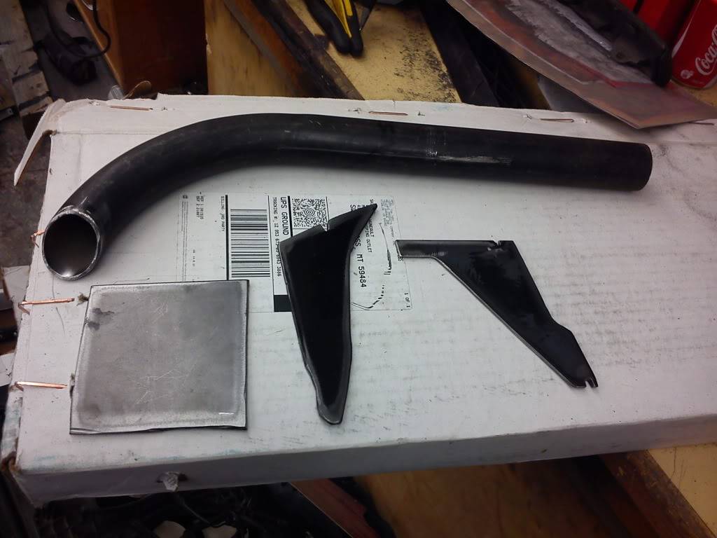

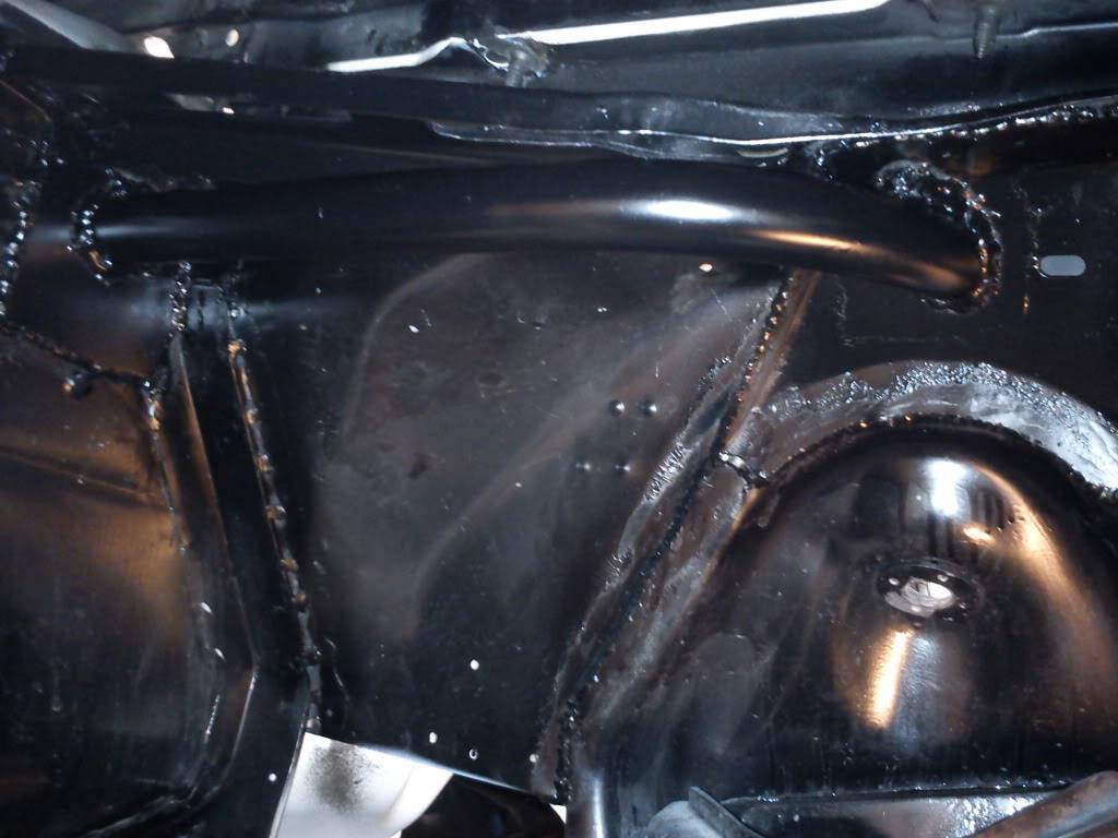

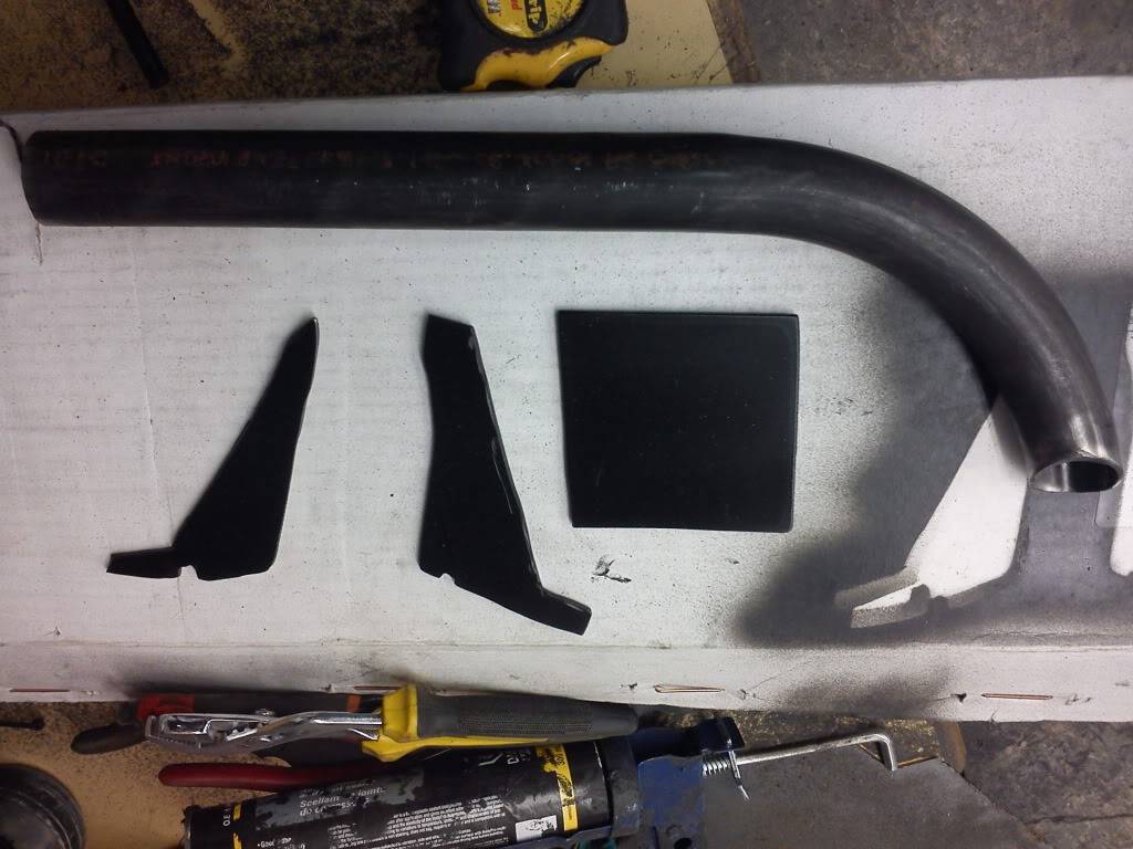

Front rad brace 1.75"x.120 DOM - had it bent up at a local race shop as well as the inner fender braces:

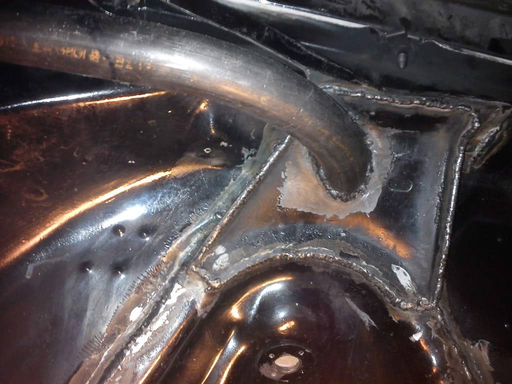

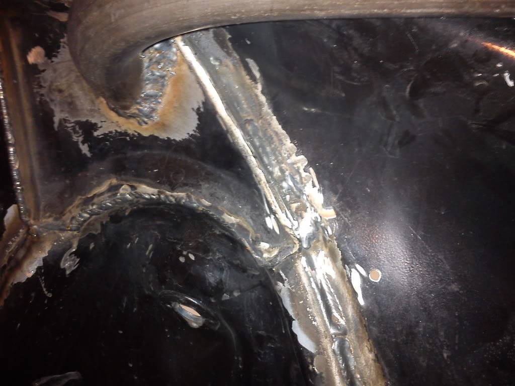

Inner fender braces 1.5"x.120 DOM and boxing in the strut towers:

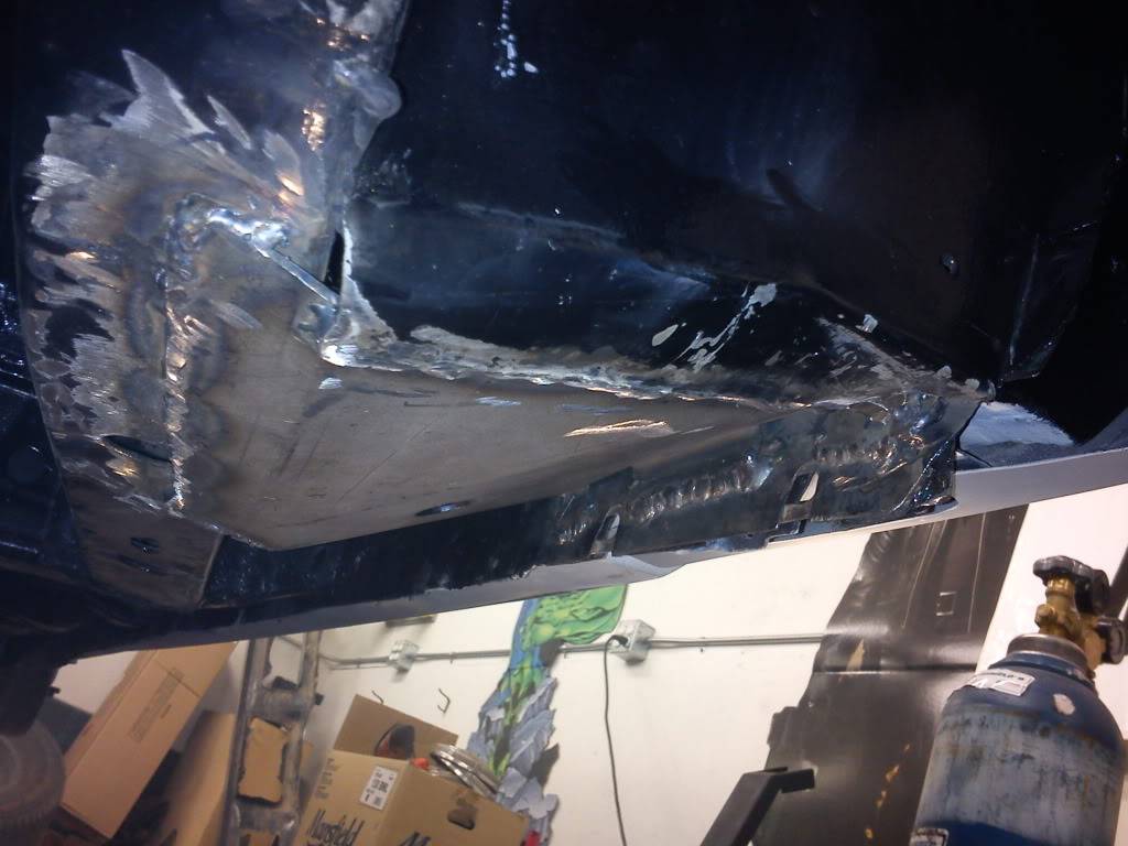

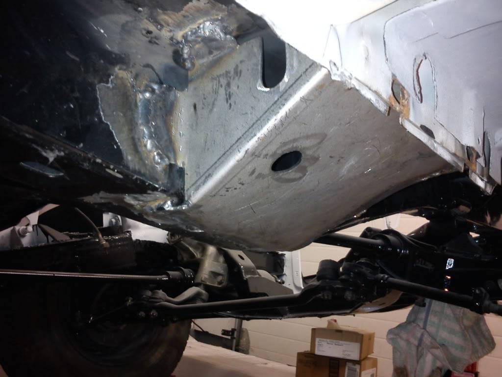

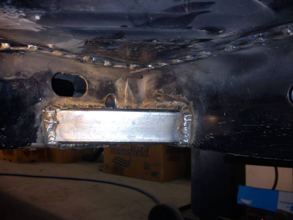

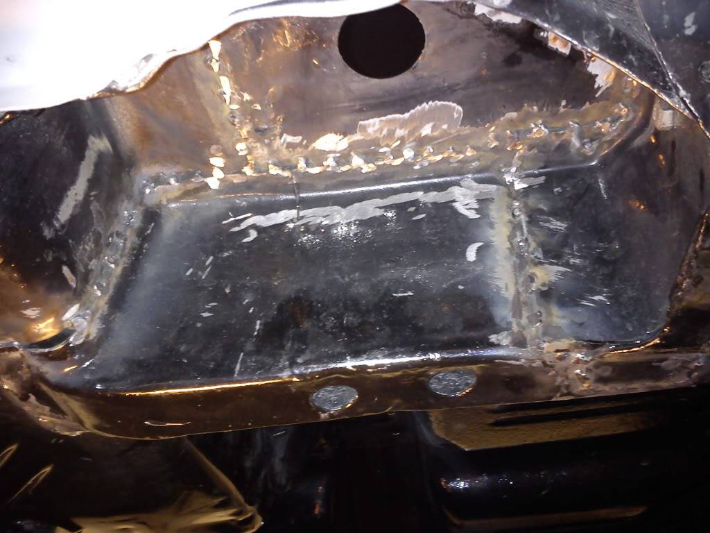

I had bought some torque boxes off a moparts member a couple years ago for $100 for my charger which i sold, so I put them in this car, I was not impressed by the fitment of these boxes as they required alot of trimming and bending, I was not impressed. On top of that, the full set of torque boxes had 2 fronts, and two rears, but the rears were the same size. So I called them and told them i had two right rears - they said they would replace it with the proper one if i sent the one down to them. And they did the exchange and sent me the new one at no charge. And I have to say that this one was miles ahead in terms of fit and finish, all the bends were in the right place and no cutting, 3 months ago I wouldn't have bought from them, but now I would't think twice!

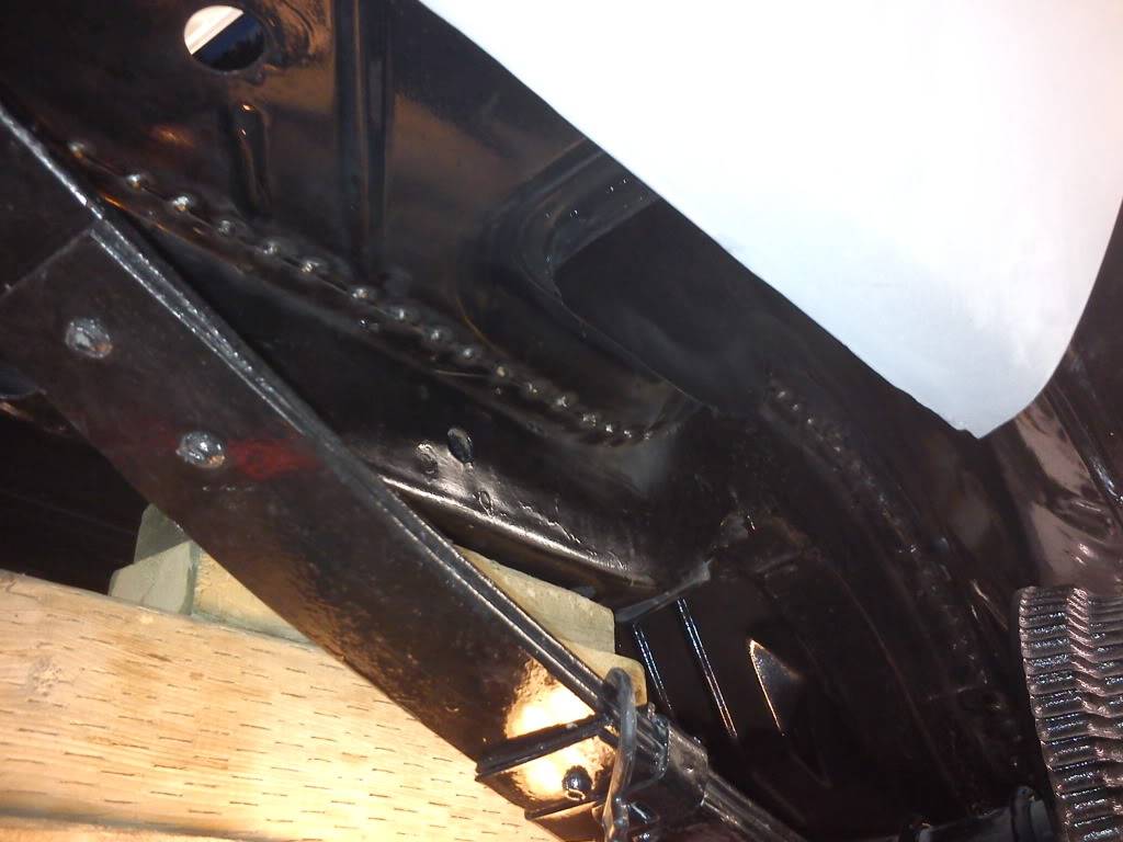

I must have went through 10 tubes of seam sealer! I sealed the hell out of every nook and cranny before i did the por-15, This car is gonna see as much road action as possible!
thanks guys - for your info - the 1.5x3 clear the floor pans with a little bit of hammering - no cutting of the floorpans whatsoever!:headbang:

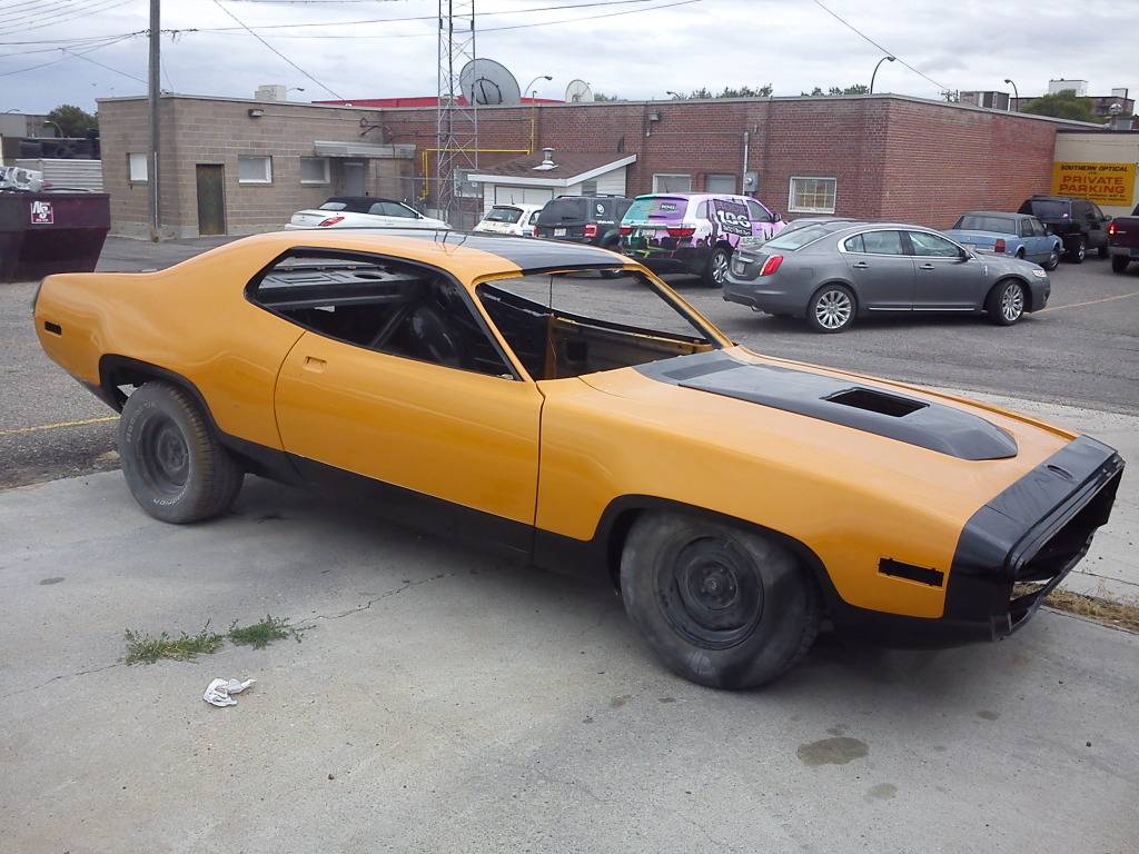

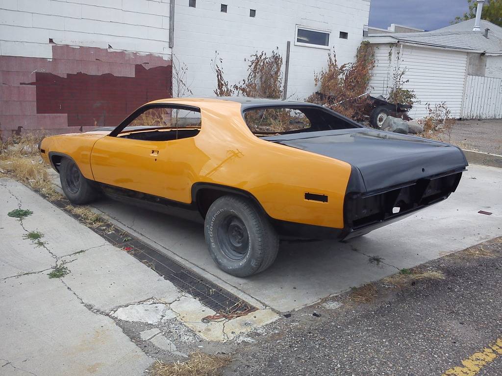

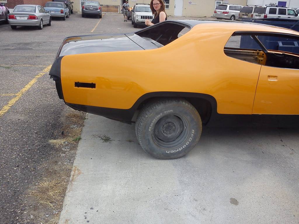

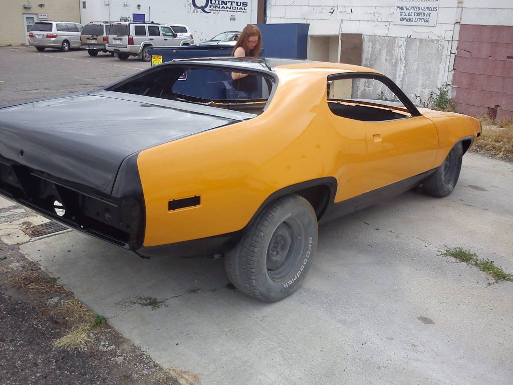

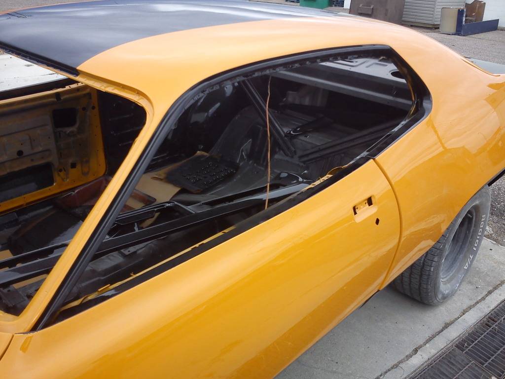

its been such a long time but that time is finally here! I just got my car back from the shop - it still needs a wet sand and then clearcoat but for now I can start to put it together! It'll be awhile again before I get to work on her (being summer there is just so much to do!) But I should have this girl ready by spring! In the next couple weeks I'll probably end up doing some smaller things like painting the dash, welding the k frame ect. I'll keep you guys posted!
Go Steelers!!
Kidding, that's a pretty awesome, unique paint job. I like it, nice work!
I love the color combo it sure looks great!! Your going to have a beauty when thats done.. Good luck with the finish!
Man, that /6 is gonna wail in that bad boy....... :D
Kidding, that is an awesome build. Love the color scheme.

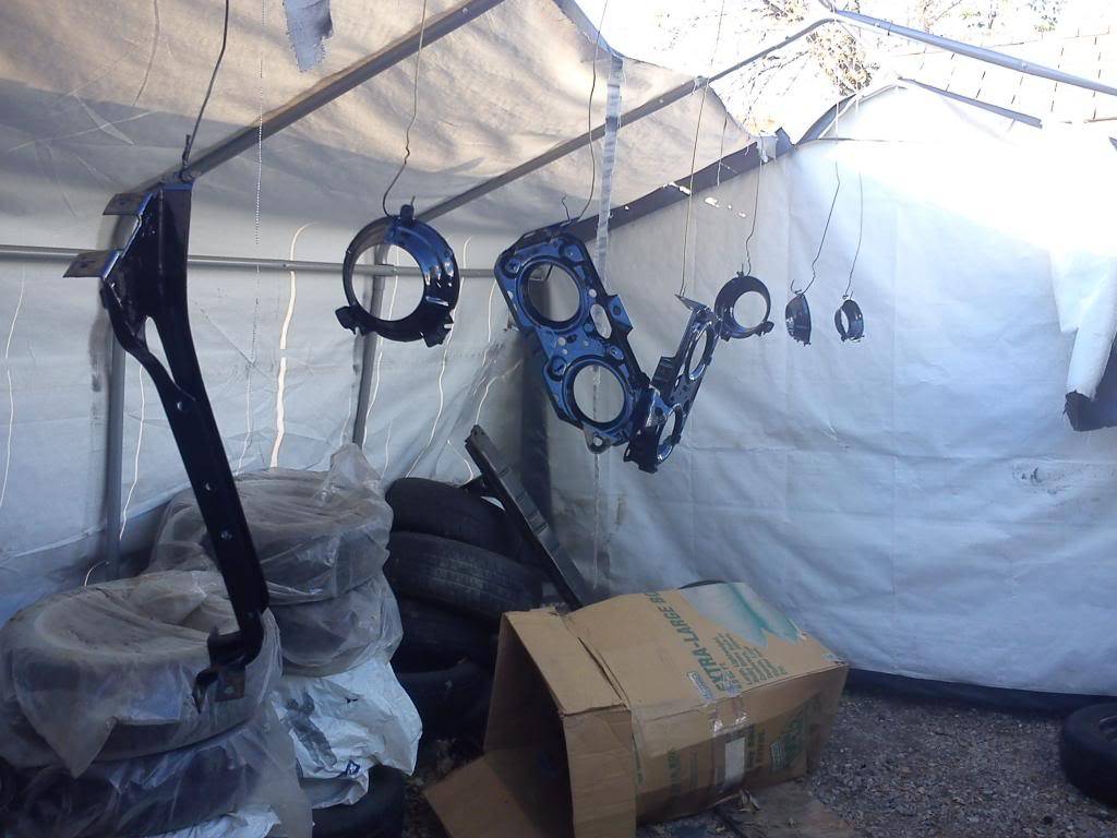

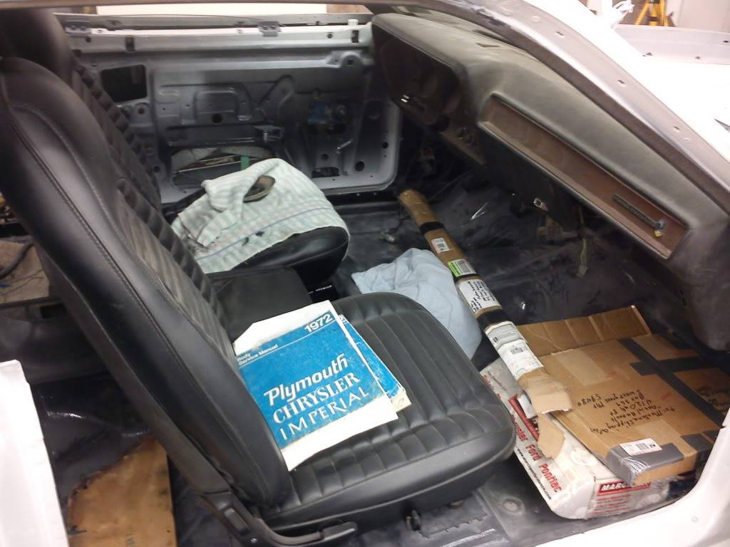

well summer is wrapping up, I only have 2 autox days left this year, and a baby due any day now, I've been trying to get some renos done before the little one gets here, but I thought I'd show that I have started a little bit of work on the old gal, I've painted some pieces before it gold too cold outside with por-15

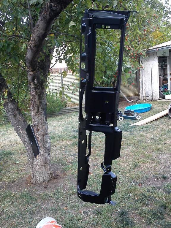

interior pieces I painted with VHT roll bar chassis black (satin), still the best paint out there:

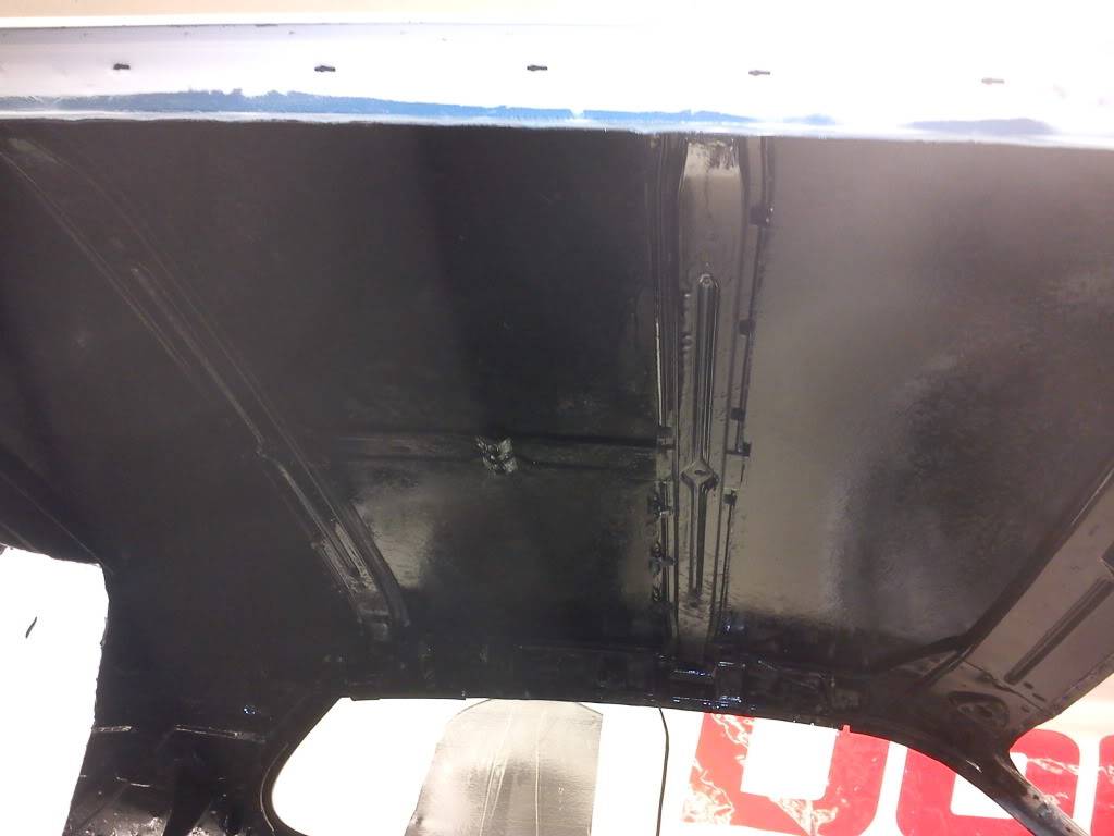

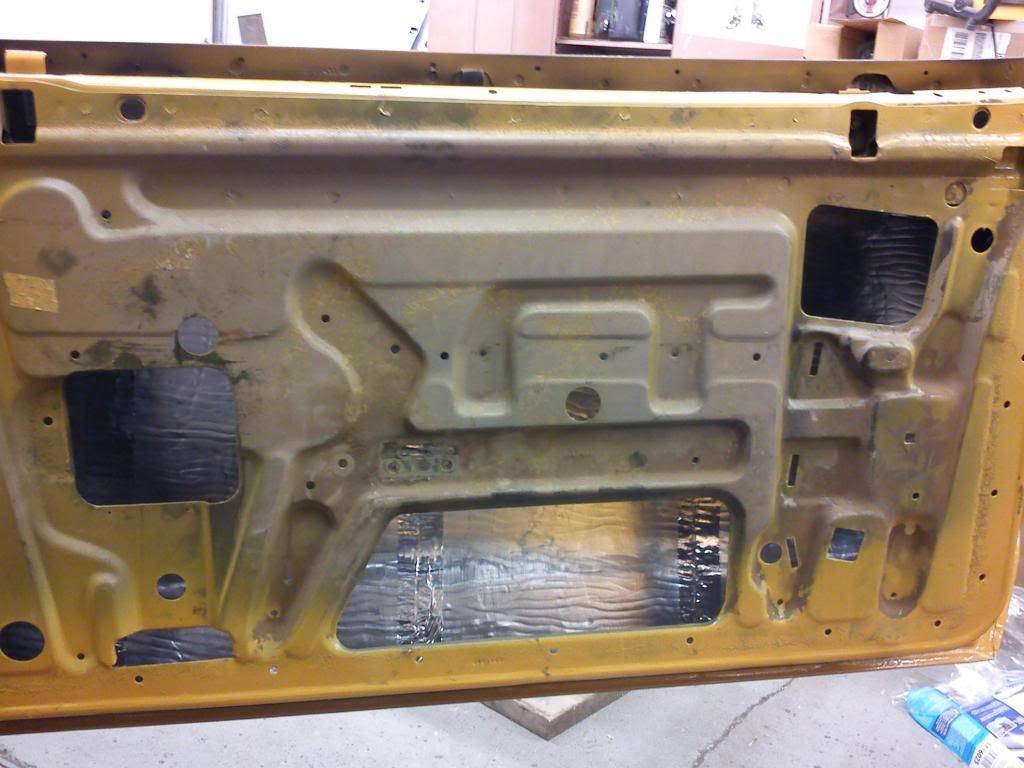

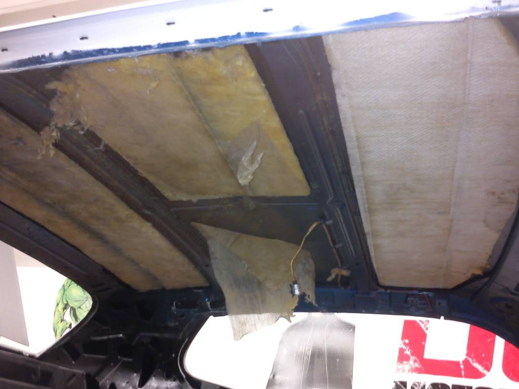

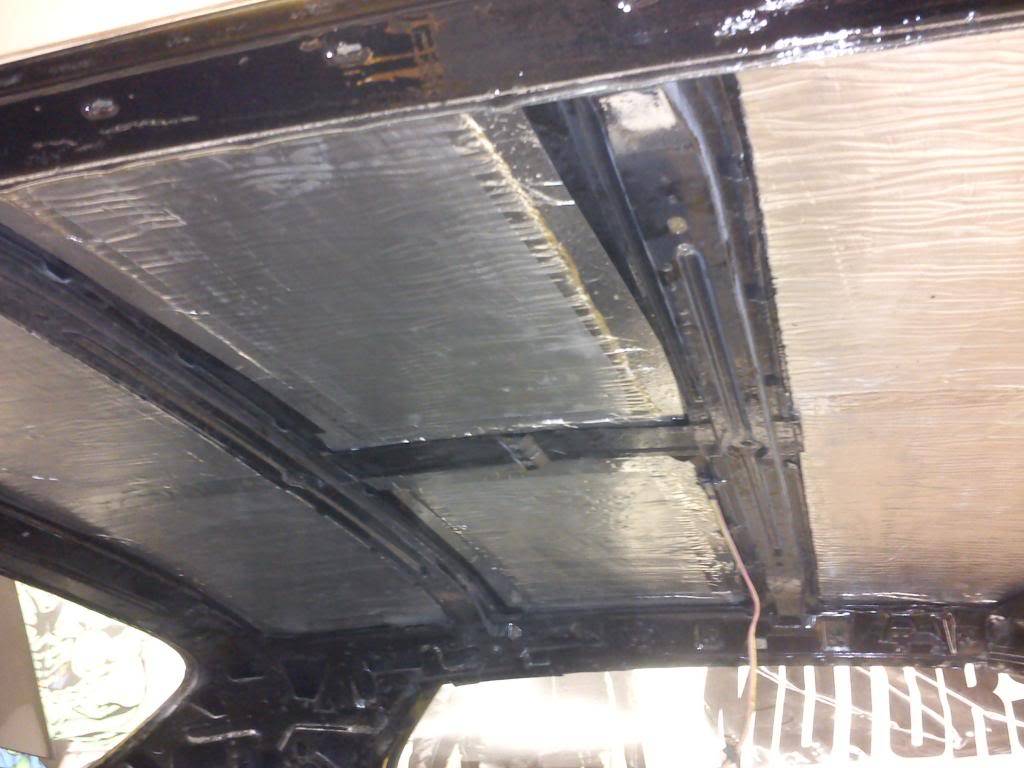

I bought some of that B-Quiet (basically dynamat without the logo) goes on great! I've started on the roof and doors, I sealed the seams with the aluminum foil tape as well:
Then I put ontop an aluminum bubble wrap (foil on both sides) for added sound deadner and insulation seeing how it weighs nothing at all, I'm just using it it on the roof, doors, and firewall...
Looks awesome. What did you use to hold the insulation to the roof? Congrats to you on the new arrival.I'll bet she will be a cutie.
