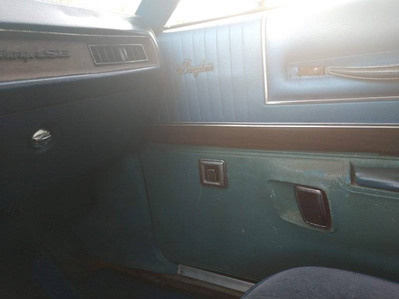

It is GB5: Bright Blue Metallic (Dodge) Int. Door Frames
Thank you very much for the final decode item!!! WOOHOO!!!
Looks like BB5 from here. This spot is the paint between the door weatherstrip and the door panel. Is that area darker than the body?
So I did a check on the old 1969-1974 Mopar Fender Tag Decoder site I was using. GB5, BB5, and B5 in that slot are all the same information. So... who know? But it seems to match what I see on the car. SHWEEET!!!

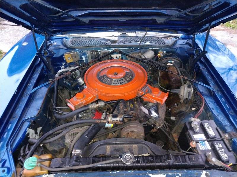

400 4 barrel, AC, PW, cruise.
