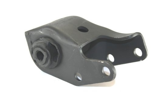

You'll need spool mounts check back in a bit I'll go get some pictures for you
This is what came stock in your car unless someone swapped frames this is the needed part just order mounts for your car with the 318 it's the same stuff post a picture of your frame just to be 100%

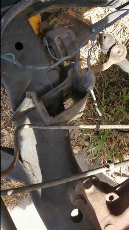

Does this look right?

318 and 340/360 driver's side mount is different.
alright so my first question is the picture of the mount coming from my car the right mount, i have never seen a mount like it before. 2nd question what mount do i need for both sides, are they same on each side?
i am very close to just buying a set of 2 spool mounts pictured above and seeing if it works out
