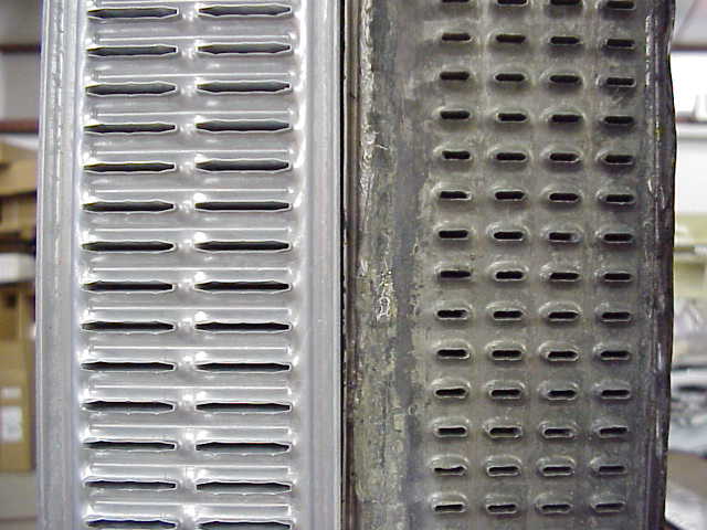

How large is the core support radiator opening? 22" since the car came without AC? I like the larger area 2 core ones since imo, they cool pretty dang well. The larger the tube, the better imo....

If the radiator is original you can bet it has some plugged tubes reducing its ability to cool properly. Myself I would get a replacement radiator. Do you have a shroud? If not you should.
Don't think they even make a 4 core aluminum rad but I bet anyone can guess which one here will do a better job.....
If you want to keep it original, call Bob at Glenn Ray. It won't be inexpensive, but you will not be disappointed in his quality and work. He's in Wausau, WI. Beware of aluminum radiators that should fit your application, quite often need modification.
Come to find out, it is only 19 inches. Yes the opening is 22 inches so i am investigating getting a 22 inch.
Do you have a good radiator shop nearby ? They can boil-out or recore your existing radiator. I'd bet that would cure the symptom.
