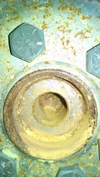

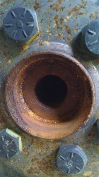

A guy is interested in my 318 that was connected to a 727. His truck is sitting there with a 4 speed ready to go (also a 318 truck).
My crank has to be machined for a pilot bearing. Can anyone look at these photos and tell if this will work?
I'm not going to whodoo him with a big sales pitch just to get it sold, especially since he's 3 hours away.
Brewers has a needle bearing that will press into the larger bore.
