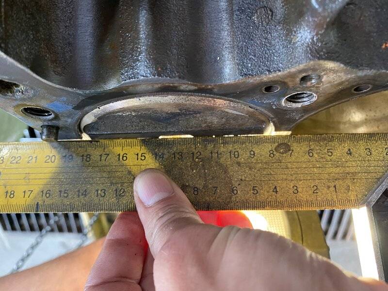

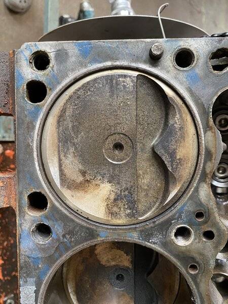

One other weird thing I noticed today is that the pistons is higher on one side than the other. They also pop up past the deck, but .010 on the left side and .035 on the right. Hard to explain, I'll try to upload a pic from my phone. Never seen anything like it, must be an error from manufacturer. Don't know what brand but thinking of taking them out and do a simple honing so then I might be able to find some info on the underside. Anyway, if everything looks good with the pistons I will put them back, even if it's not optimal. 150-154 psi is still good. Fel Pro .039 compressed gaskets.
Pistons look like the old TRW L2316 forged piston. If I remember correctly they were positive deck height, about .013” and the stock 340 pistons for ‘68 were the same.
Different deck height, that’s worth having a closer look at, .035” is way to much and could cause an issue with the edelbrock heads, I don’t believe they are an open chamber head and the piston could contact the quench area with the wrong gaskets.

Engine has been run with this combo and no signs of piston/valve contact so all good about that. Now I have found that cam is 4 deg retarded and I want to change that to 0 deg so will have to check clearance again after that. Anyway, how can pistons be "leaned" to the left?
