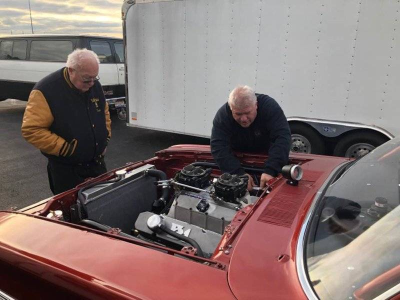

Just like any standard Max wedge port intake. Requires spacers between the intake and the head. Dan Jones runs one. Scott Koffel motor.
Doug
I think I see "pop panels" in that picture. (the things that blow in case of a backfire so the intake is less likely to explode)
I've read that they are prone to backfire, badly, if proper starting procedures are not employed.
Basically don't have the throttle blades closed, and don't over "prime" the intake before you crank it.
More experienced forum members chime in corrections/confirmations please!
I like the look as far as I think it would work well!

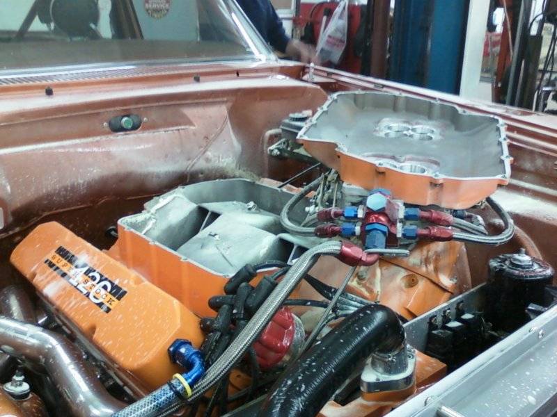

This is what happens when you start them wrong. Good thing it was not in the trailer with the hood on. Yes I got to test my fire system. This one has a non modified plenum. With correct starting technique never an issue since.

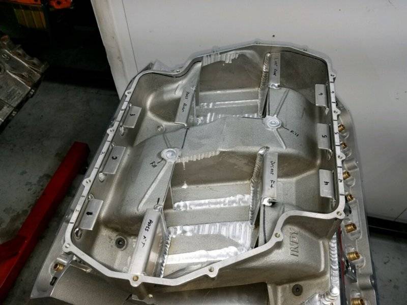

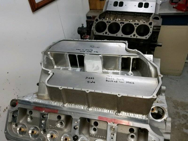

I've never tried it. I bet it helps the smaller cubic inch motor. Not so sure with mine.
Doug
I know of 6 NSS folks running theirs modified like that. Some say they are quicker, some say nothing changed. I believe all of them I know of are 540 and smaller combos in fairly light cars. I would like to see back to back numbers with an unaltered -25, this modification -25 and then my modified modman just to see. The ET I have run and the weight I am at compared to the other cars says I am pretty close in HP. Thats with their Holley setups and me on edelbrocks.
I tried Quickfuel Holleys a while back. 9.04@149. 750 Eddys have been 9.00@150. Dechicco offered to let me test his but mine needed to be cut to fit. So far the stock one seems ok.

Doug,
Looks like the bolts sheared? Or did they all pull out? Or....?
Was I right or close re: starting procedure?
What do you describe as the best practice to start w/no BOOM?
Pulled the threads out. Funny just went pfftt. No loud bang. Procedure; 1st start 3 pumps, let it set 30 seconds, then one more pump. Crank with ignition on. Cold start towel over the carbs then the same deal. Warm start 1 pump, wait 20 seconds same crank. Always throttle cracked about 25%. Usually starts in 2 revolutions or less.
Thanks Doug!
I'm sure that is critical.

I don't understand when you say …. cold start towel over the carbs then same deal...please expand...thanks a lot.
The towel acts like a choke when its 45-50 degrees or less ambient temp. Actually I use a large cloth fender cover. That way you can reach out the window and hold it. Once its running just pull it off. Gets cold up here.
Doug
Yes...it hasn't ever happened, but I have imagined an underhood or otherwise similarly placed towel getting tossed about by the spinning radiator fan, and the ensuing mayhem.
