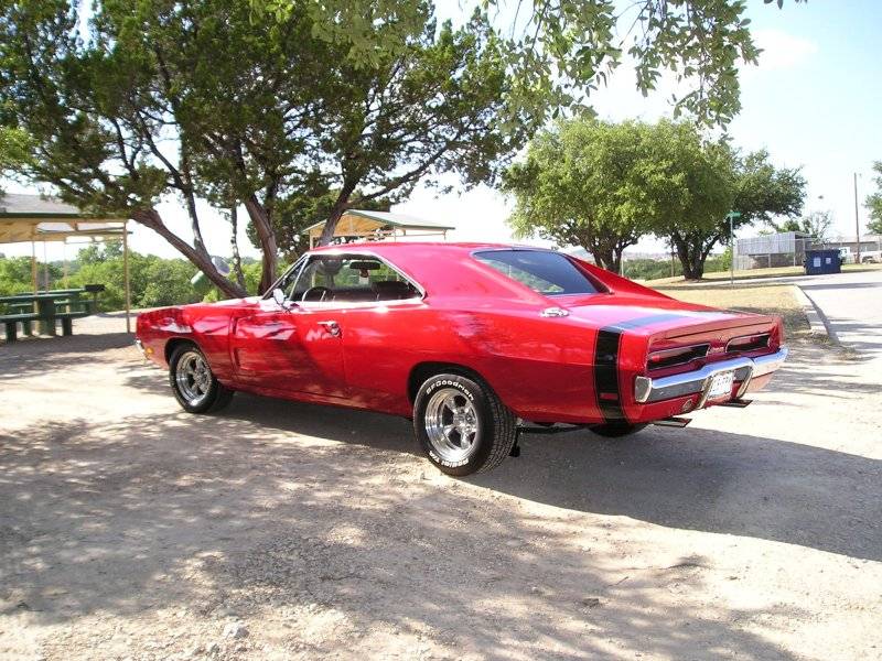

I have a 440 over 40 I'm installing a set of icon 9953 pistons with Edelbrock Performer 84CC open chamber heads. I'm wanting to get the most power I can on pump gas and enough vacuum to operate the brakes. I'd like to get opinion's on which hyd cam I should use?
Beautiful charger!
