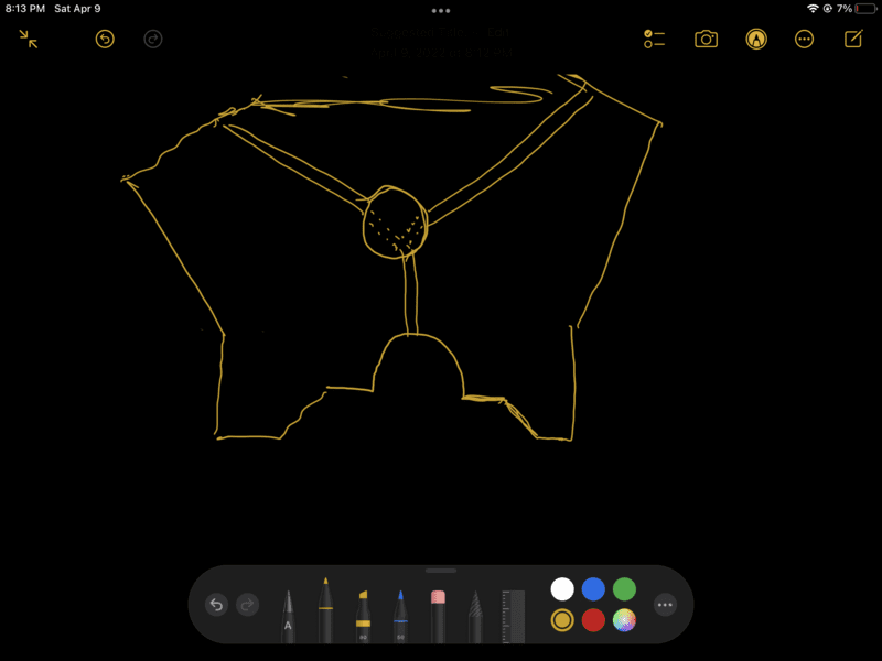

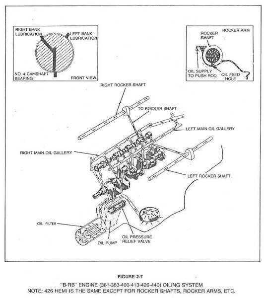

I figure you know this but the oil passage through the number 4 cam journal isn’t straight through. You gotta slowly turn the crank over while priming to get oil up top and it only oils one side at a time.
A crappy sketch but hopefully you see how it works there only one passage through #4 cam journal and it lines up with the oil passage once every so many degrees per rotation.

I used to turn the engine slowly by hand to find it but now when assembling before the heads go on I look down the galley with a flashlight and line them up and mark the balancer.
Pnora, why disagree? If the #4 cam bearing isn't installed properly with the oiling holes lined up, (or spun), it won't oil either rocker shaft
Auggie stated he found the cam bearing misaligned and drilled the holes in the bearing through the passages
If the cam bearing was misaligned and you drilled it for the top holes, pretty sure the bottom hole in the bearing is not lined up either. Just saying. ruffcut
