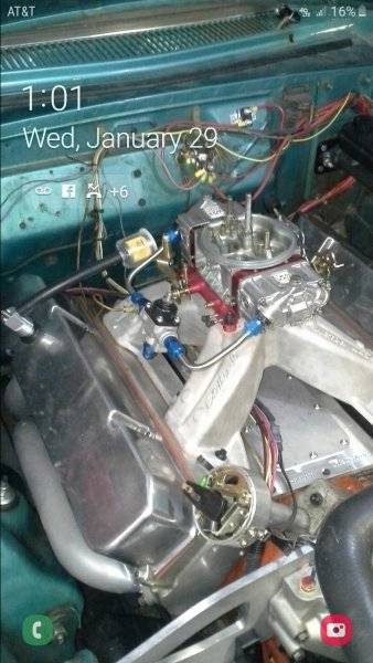

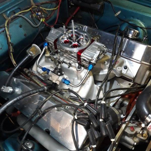

505 cid intake and carb??? Any suggestions?
Here it is on the engine.
