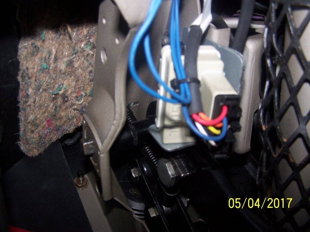

Why is it you have to use the brake light switch? Cant you use the original one from the car? There is so much of this whole swap I don't understand.
Not completely sure but I assume the computer needs the info for some reason. There are 5 wires on it. Here is a pic of mine
I think it has a lot to do with electronic transmission and being able to shift it out of gear as well. I am learning a lot with it and I know 5.7 and Sixpac have a lot of good knowledge.

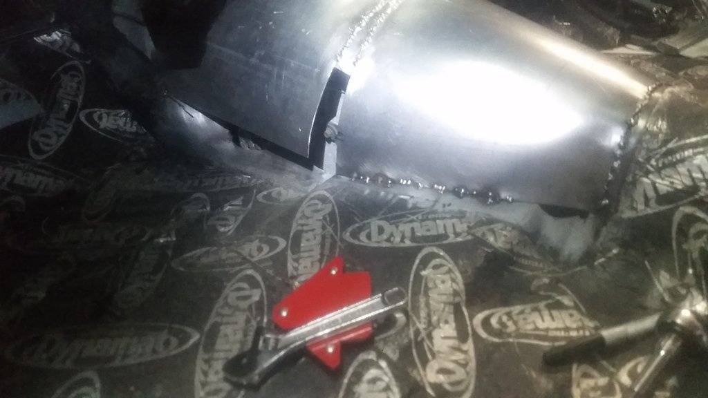

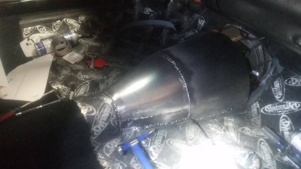

Almost have the tunnel finished. Just went for it. It is a little wider than the original. I took the advice and went to a fab shop and had them pre roll the sheet metal. The fun part has been stripping out the not needed Dynamat. I went to the junk yard and found some brackets for the brake switch. I cut the side off and grafted it onto the old one. Not it mounts in the old location with a new end for the brake switch. So far so good. Now the fun part of the last section of tunnel and making sure it clears the dipstick tube. Don't mind the welds first real welding project.

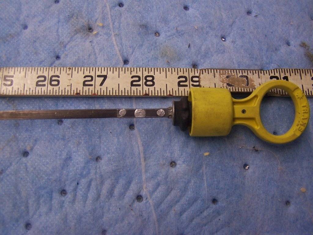

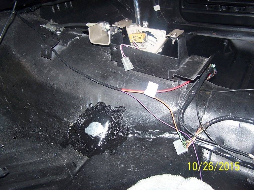

Lookin good Dave, Your tunnel looks to be a little wider than mine so you may not have a problem with the speed sensor that ends up just in front of the cross member. I had to cut a hole and add a bubble to make room for it. Here is a pic of mine. On another note, when you mentioned the dip stick, I was reminded of the problem I had with mine. It was way too long and would have been higher than the hood so I ended up cutting about 8+ inches off. Had to cut and splice the dip stick also. One of the pics on my post 28 shows the length I ended up with.
My tunnel is about an inch ish wider than the shifter connection on that side. I think it should also clear the sensor. If not its hammer time. I started my tunnel a little further back than yours it looks like. That's what happens when you cut too much. I didn't fit the dipstick tube when I put the core transmission in it. Hopefully there not too much cutting needed. Today my goal is to get it in and see the fit. I have been fighting the urge to not pull the heater box, but I think that day is coming.

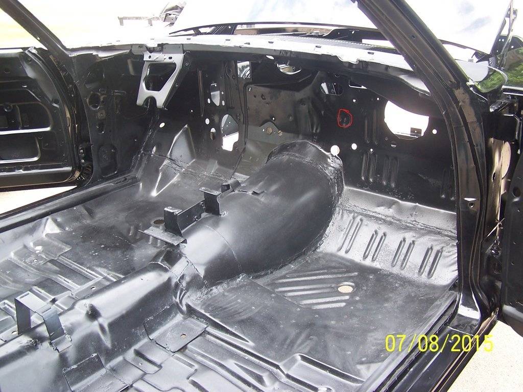

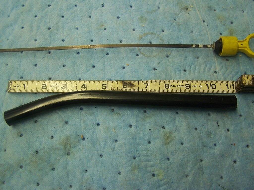

I was pretty sure my instructions called for a 2 1/2" hole. Maybe they changed grommets. I would go with what they recommend. As far as the location, most people punched the hole up higher where the outward dimple is in the firewall. That location also hides it somewhat behind the engine and makes it easy to hide the wiring under the intake. I located mine in the only place I could because of my AC heater box. Your heater box will probably dictate where yours will need to be too. Here are a couple more pics. The red circle shows that dimple in the fire wall. The other pics show I cut 11" off of the transmission dip stick and tube. Don't forget to leave the extra inch for splicing the dip stick.

Splicing the dipstick? Did you cut it from the handle side or the marked side? Couldn't you just re mark the dipstick with the cut off piece?
I cut mine 1" from the handle and lopped 10" more off and spliced it with some small rivets. I guess you could just re mark it.
