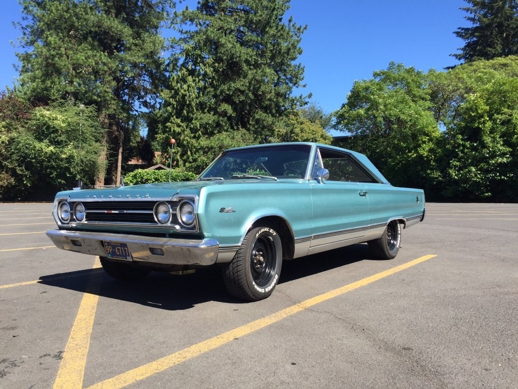

I have 215/70-15 fronts, 255/60-15 rears all 4 on 15x6.5 wheels with 4.25" backspace. I have zero issues with fitment.
Backspacing is the key for the rears. The more the better. There gobs of room inboard, but there is a ridge on the outside inner fender well that prevents a larger tire. I tried 275/60-15's and rubbed pretty bad on a 15x8 wheels with 4.5 backspace, if I had some 5"-5.25" backspace wheels it would probably work.
Thank you, thats what I needed to know. It's not my car but I m helping him out with the sizing. Appreciate it

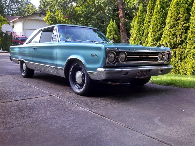

14 x 7 Mecury Marquis wheels with Firestone G70-14 redlines.
Car sits low, and even lower with the new springs.
Minor rubbing on outside of driver's side.
