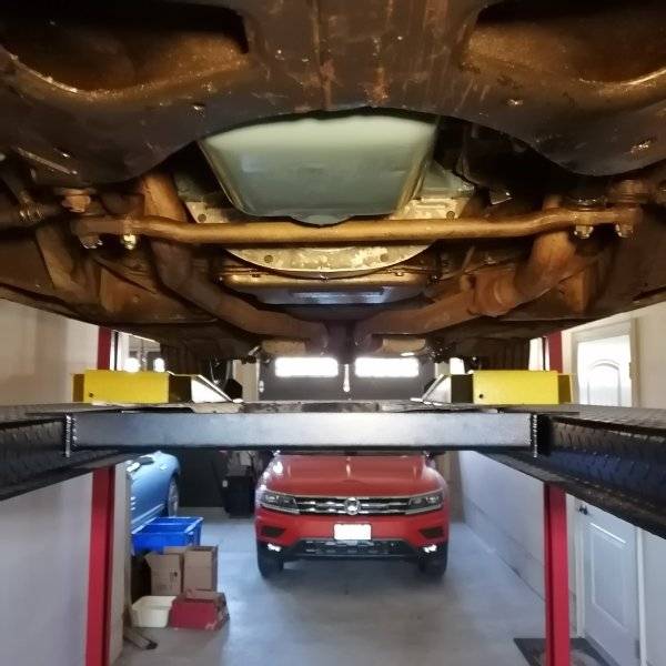

I just had a full dual exhaust done locally. Using the stock 66-67 non hp exhaust manifolds .
$540 done and out the door. True duals, 2.25" pipes WITH an H pipe, some turbo mufflers and turned down at the rear bumper.
Im super happy as I get rid of the headers and flow master mufflers
And the car sounds GREAT

You did well but there is some risk in having a shop do it that you have no experience with.
The tailpipes in particular need to be correct as there is little room between the tank and shocks and of course they need to end up in the right spot in the rear.
Additionally you need to consider the quality of the pipes I have tailpipes from Accurate from 2000 I think and they still look great.

Luckily this shop is owned by a local mopar guy.
And he came highly recommended by several people.
So felt the car was in good hands.
And i was not disappointed.
Repop accurate exhaust was not in the budget.
