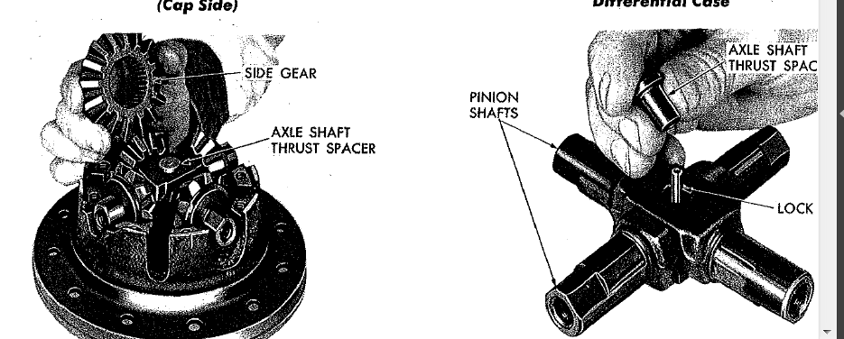

Look at pictures for Axle shaft thrust spacer. Go to My Mopar for a service manual. If they don't have an exact match for your car download a close year model. Most of the drive train will be good for most mopars 60's cars. If you don't have that part green axle bearing time! Or rip into sure grip and drill the hole and buy the spacer. Green bearings for me.
I think the axle shaft thrust spacer and lock may be missing. I will pull it out tomorrow and confirm. So, if it is missing, it is OK to make the change to the green bearings with no issue to the 3rd member?
Thank you for the help and the pictures....very much appreciated.

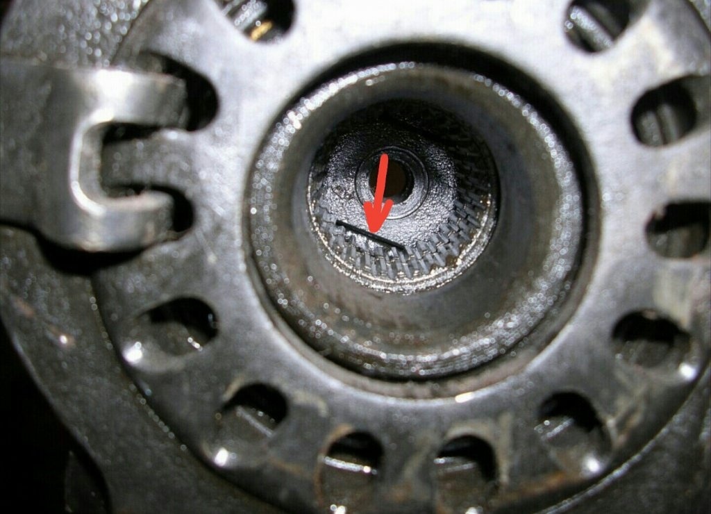

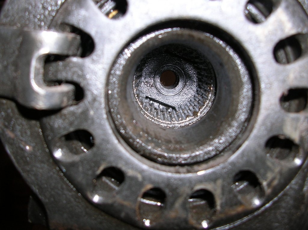

Pulled the differential and have attached a picture....the thrust spacer and lock pin are missing. I may just reassemble with the original 2.94 and get the axle and brakes back on just to get the car going....just another decision...lol
thanks for the help...
