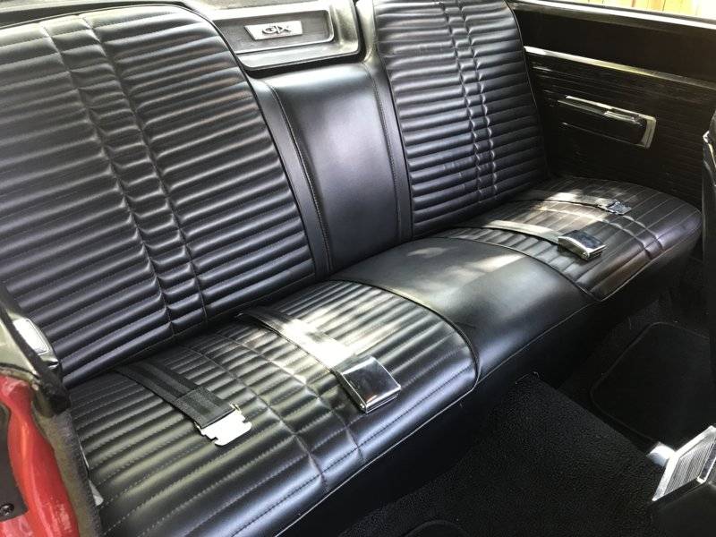

Had a bench seat in my 67 Belvedere convertible, can get you pics of the locations if you like.
Wax trying to find a pic in my build thread.
Are you just looking for what part goes on what side?

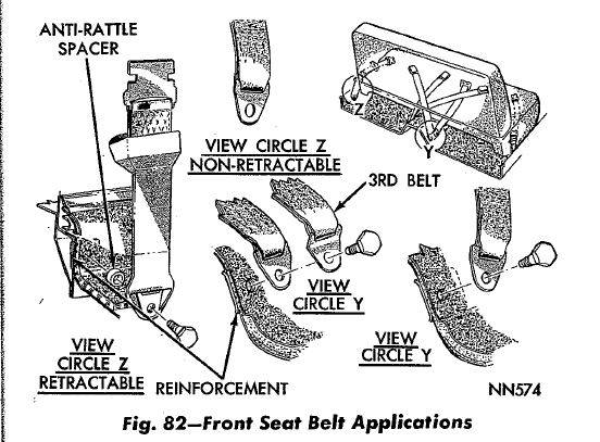

Should have outside bolt holes for the retractors, bolt holes fore the buckles located on the hump behind the seat. Your center belts are attached where the buckle holes are. The ends should be separated by washers and spacers. Do you have the eye bolt/snap clip attachments?

Sorry, I don't currently have any pics of my underside. But, if your floors are original, the holes for the seatbelts have extra metal panels on either end of the driveshaft tunnel to provide support to the bolts. The holes itself are threaded.
