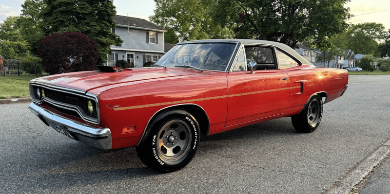

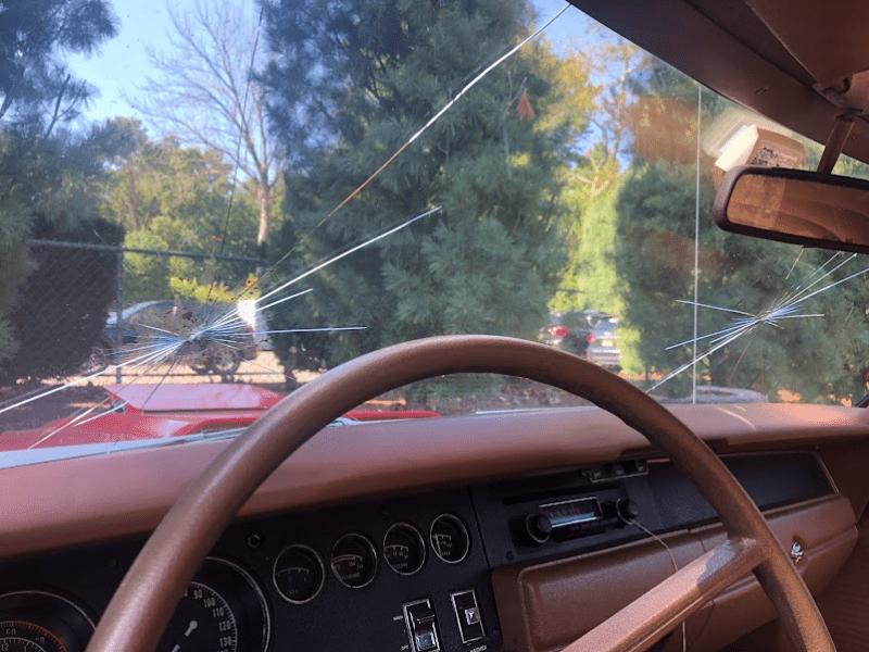

It was a beautiful day in NJ yesterday so I took the roadrunner out. Not a mile from home, 2 black walnuts (each about the size of a tennis ball) fell from a reee branch right as I was passing below and smashed my windshield. The windshield and labor will be covered by insurance by my questions are...
Does anyone know a glass guy that can correctly install this windshield, or is it something that can be handled by a typical hobbyist?

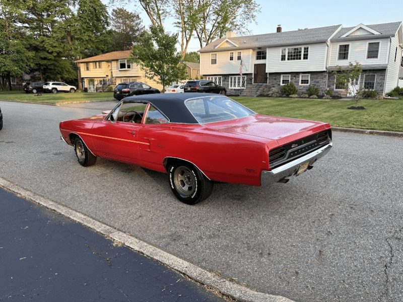

My car came with a black vinyl top but it was removed many years ago, long before I owned the car. This is the time to replace the top if I'm ever gonna do it. Does anyone know a good vinyl top guy in NJ? I was also considering tackling this myself...thoughts? The car is FE5 red with a brown interior, I think the black top would look great on it. Just looking for some feedback.
Windshileds arent that bad. Remove the trim. Unlock the rubber and remove the old glass. Now comes the fun part. Clean up of the body flange and the seal. If you put it back in with no bedding compound it will leak. 3M 8509 has been on back order for months. There may be other products that are similar Such as CRL7708. Do not use RTV, or Urethane. spread compund in the rubber seal. Lay seal in the body. Set the glass in the lower channel. Work u along the side. Then across the top with fiber sticks. Apply bedding compound in the groove before locking down the rubber into the groove. The mess will clean up with mineral spirits. nd it will get messy.
Doug
Windshield is not a fun job, but doable. The glass guys all want to use urethane these days which is a no no on rubber gaskets.

My car came with a black vinyl top but it was removed many years ago, long before I owned the car. This is the time to replace the top if I'm ever gonna do it. Does anyone know a good vinyl top guy in NJ? I was also considering tackling this myself...thoughts? The car is FE5 red with a brown interior, I think the black top would look great on it. Just looking for some feedback.View attachment 1534362

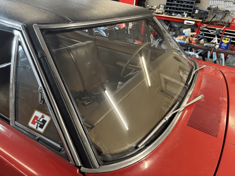

Glass. I was told that new glass is thinner, and harder to seal. I called AMD about their windshields. According to their glass thickness it measures a little thicker than the new offshore stuff but not quite as thick as OEM.
We have glass shops here that do it correctly, no leaks. I will get the glass shop to do the windshield, they will guarantee no leaks and I have butyl on hand. Did a rear window in ours with help, two small leak areas which I can address.

The correct bedding compound will seal it up tight. I did my Jeep Gladiator pick-up a few years ago. Someone had previously used clear silicone. Cleaned it all off, then sealed and reinstalled it. Hasn't leaked a drop in 3 years. Bedding compound is gooey black and never dries. Stays that way forever. Thats what you need. When I installed the windshield in my 64 and my sons 62 Plymouths both aftermarket. They were if anything slightly thicker than the parts we removed.
