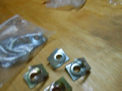

Depending if you have Bendix or Kelsey Hayes calipers, the antirattle setup will fit or not.
Regular parts dealers carry these setups in $10-20.
https://www.rockauto.com/en/catalog...rake+&+wheel+hub,disc+brake+hardware+kit,1736
https://www.rockauto.com/en/catalog...401,brake+&+wheel+hub,caliper+slide+pin,10281
The "Positioners" included on those kits are the expensive part and can be found separatelly into $20-40 rate, AND they are just for Bendix Calipers. They are not used on K-H calipers. Dunno what's s their function really.
Need to know I still don't know the correct position for the antiratttle spring so I had to figure it out to make them useable on my calipers, but doesn't look correct yet. I have K-H calipers.
Diagrams on line which actually shows the bendix system, show a diff spring than the one being sold, even for Bendix

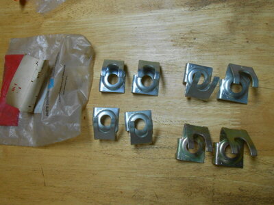

Anti rattle spring installed on my 72 Charger and 71 RR.
Bendix Calipers I guess? They don't fit tight really on K-H calipers. Shoulders around the pins are not thick enough to keep the spring tension over the pad. So on that position it keeps falling down.
I had to pull them up over the caliper pin holes shoulders to make them work.
