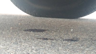

Just got back from a shop where i had some things looked after (1) was suppose to be a front seal they said it was not the problem but a pan gasket and tail shaft seal out on the highway. See smoke off the exhaust pull over the inspection plate has tranny fluid just falling out. would it be possible the convertor would be leaking?

If it's coming out of the bell housing there is either pump or converter issue. The converter can be easily pressurised and tested for leaks while it is out. The vent won't leak unless the trans is overheated or overfilled. Either way trans needs to come out. Me personally, I would pull the pump and check the bushing. It's no issue with the trans out. New bushing, front seal, o-ring, gasket, and bolt washers. Make sure the converter snout isn't worn. Check the converter for leaks. That way it leaves no avenue for addition leak paths from the bell housing. $20 worth of parts if you save the fluid in a clean container.

Ya it leaks alot. More at highway speed. It drips onto the exhaust. Looks really ugly in the rear view mirror. I did pull over looked underneath just pouring out.
Get under it, clean everything off & then see where the leak really is.
