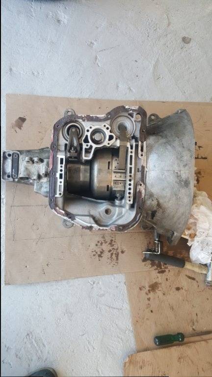

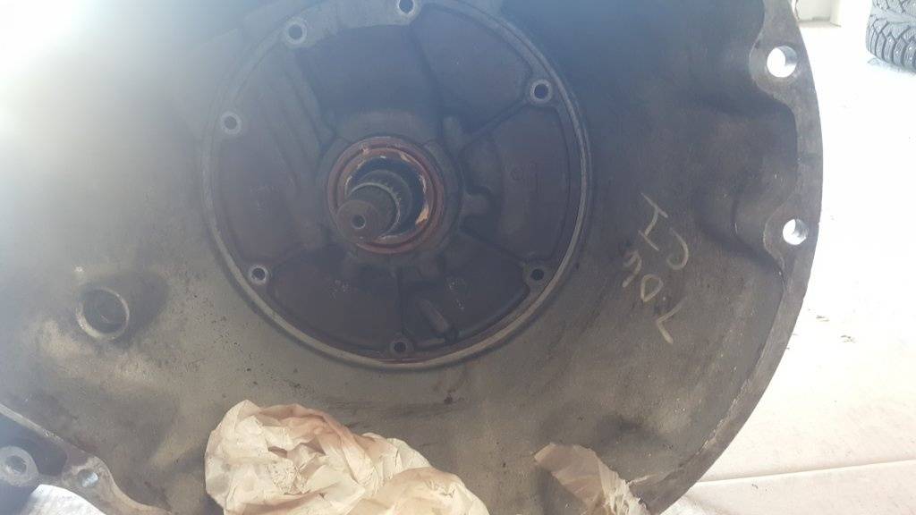

Tranny is out, what is the next step to get it apart.
View attachment 419783 View attachment 419784
You need to pull the pump unit out of the front, they can be stubborn but carefully wiggling you can usually get them to pop out. Can't remember if it was the Chevy's or Mopars that had the threaded holes to help facilitate pulling the pump?:realcrazy:
One of the more experienced guys will chime in.
Look at holes in the pump- 2 are threaded for 3/8" coarse(?) so you can use a bolt in those holes with a slide hammer, alternate between the 2 a couple "bangs" each and the pump will be out, easy peasy. The o.d. of the oil pump has a big o-ring around it. Like Fran says check endplay first so you have a guideline. FSM or similar is mandatory!

As said, record your total shaft end play, first. To 'pull' the pump, you can simply use the threaded holes in it, with a couple bolts that have enough threads, and run the bolts into the holes. When they bottom against the case, turn them in 'evenly', and the pump will push itself out.

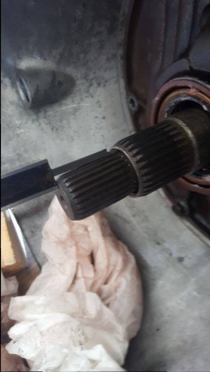

Is this how i check end play, it moves 1.6mm.
I can't be sure exactly what I'm looking at there in the picture but 1.6 mm equals .062 inch which is an acceptable figure for input end play. Typically a dial gage is used.

It is the smaller shaft at the input that is moving 1.6mm and I measure towards the larger shaft that i cant move, measured with a digital caliper several times.
OK - that should be good. Once you get the pump out you can start pulling the clutch packs and then the planetary gear sets out. The governor and output shaft bearing can come off or you can just pull the shaft with them still mounted once the snap ring on the front of the output shaft and planetary train are removed from the front.
