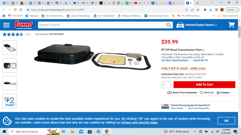

A month or so ago, I installed the RT Off Road $60 deeper pan from Summit, that is in the link above. I didn't use the rubber gasket that came with the kit. I spent the extra money on the newer gasket, that is also listed above. Its steel/rubber and reusable. It worked great on my 904. Now, 400 miles and a month or so later, still NO leaks! The Summit kit is worth the money, IMO.
