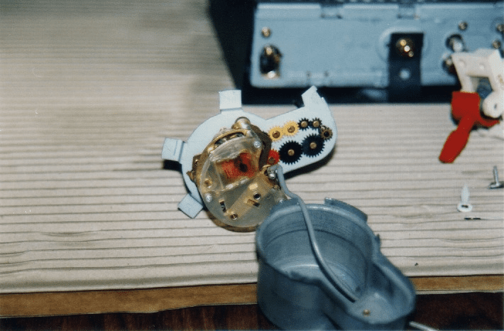

I pulled one apart about 20 years ago. Installed a quartz movement for the clock, as my colleague said rewinding the original armature would be too fiddly. Tach was fine, and I merely adjusted the zero stop position. Be careful with the oil you choose to lube the clock - fluff could be trapped in the gears. I only found my old parts last week...and repacked them. There are quite a few gears in the clock.
Here are a couple of pictures I took about 20 years ago.
See the brown mark - that's where the coil burns out on all of these clocks.

It was about 20 years ago...but you can carefully pull on the hands of the clock. I had a Quartz movement put into my unit. After I saw how bad the coil was, I decided to leave it alone....and get a Pro to do the job. Most jewellers or Clock repairs shops should be able to help out with that. I went to a local specialist in Automotive Instruments....but there are other options.
https://www.clocksandgauges.com/quartz-conversion-kit.html
There is a MoPar clock shown in the video on the link above...so it probably would be OK to contact them to confirm which clock you need.
