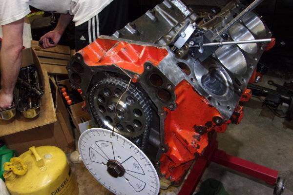

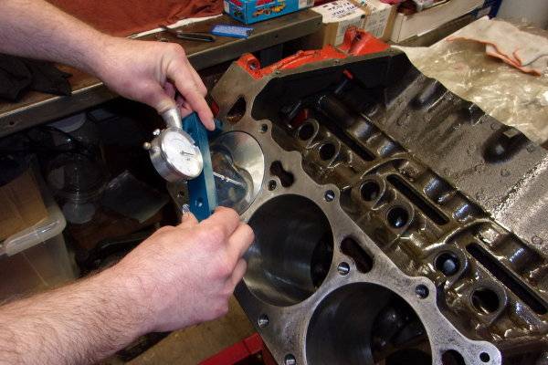

We have been building a 451 for my sons Dart. It will be getting supercharged with a Pro Charger also. They are Diamond piston with a Scat crank and rods. We just got the cam in and degreed yesterday and checked all the cam timing which was right on the money. It calls for a 108 ICL and we have it at 109. Its also getting a girdle and we ill be finishing the shortblock this week. It came out at 9.2 comp right what we wanted. Ron

Yes its a low deck that 4.375 bore and for now we are using Eddy RPM heads. And its getting TTI 2" headers. Also the crank got a second 1/4" keyway they highly recommend when supercharging it. Ron
