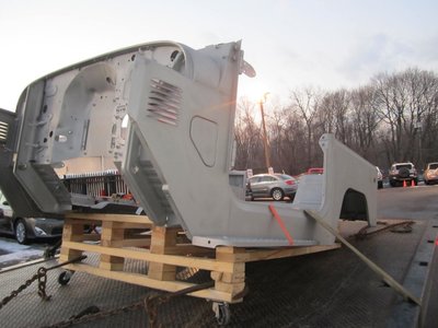

i'm planning on sending my 70 RR to TX for media blasting. I'd like to get some suggestions before I try it. Car is in NJ and just a shell. What are the suggestions? Thanks!!
The picture enclosed is not my car but the dolly is similar but with better support. FYI, I have several media blasters locally that I don't completely trust.

most trailer floors ore 84 Inches wide, and the wheels are 96.
So, No.
I usually use a tow bar attached to the frame where the bumper goes, and attach two wheels that can be bought at harbor freight. Same for the rear, then pull it on and tie it down. Done.
graveyard cars use four jackstands under the four corners, and tie the car down, and that works too.

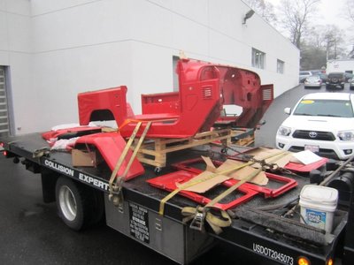

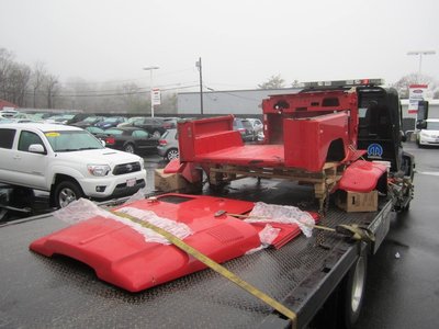

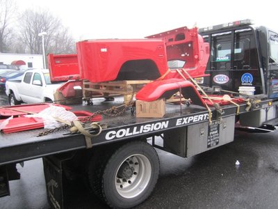

as for shipping on a trailer or a flatbed, just strap it down real good

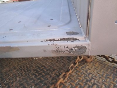

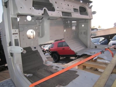

Quick strip is the next closest, but don't know if they do quality work yet. Looked into dipping from a company in Ohio, but timeline with getting the car back could result in a nice coat of rust on the dipped car, since they offer no rust protection. So I think I have transport issue resolved, now need to get it ready for body work. I have faith in the shop in TX, so if another viable alternative doesn't come along to TX it goes.
By the time you get it back from Texas it will be covered in flash rust from the humidity. Keep looking locally.
