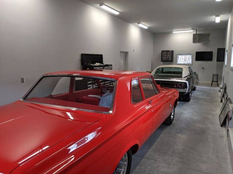

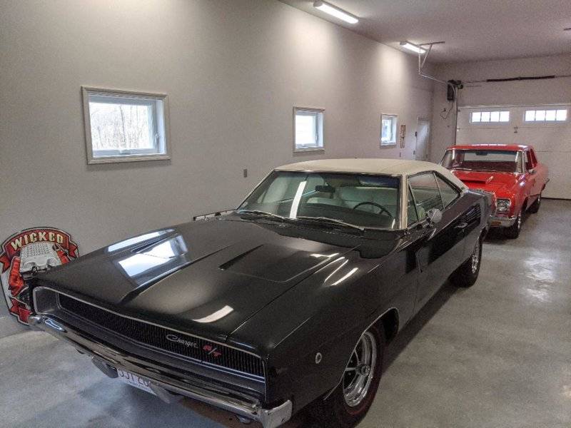

I have seven 4 footers in this 15' X 46' garage bay & they're nice.

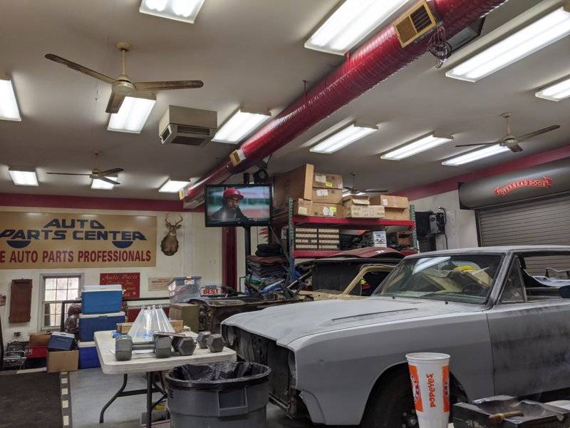

Mine is a rather long story. When I built my shop 20 years ago, I used (20) 4ft, 4 bulb units. They were the old fashion ones with the large tubes and the oil filled ballasts. After about 8 years of replacing bulbs and ballasts, a builder buddy of mine gave me a big trash can full of the smaller T8 bulbs. Then I went and bought 20 electronic ballasts, that replaced the two in each unit. I rewired every unit and installed the T8"s..Was better, for bout 8 years, then replacing those ballasts and bulbs got old. Enter LED bulbs. I bought 80 4ft LED 5000 lumen bulbs from (Bulbs 1000) I think. Think i paid around 7.50 per bulb then. But I bought the direct wire ones, cause I tried a retro fit set, in a unit, and it didn't work. Then I went back in each unit and removed the ballasts and rewired direct. 10 ft ceilings in my shop, except 6 units in the lift bay at 14ft tall...Ugggg. but that was 4 years ago, and they are super bright. Got them on three rows, switched separately. Really only need one or maybe two rows on at a time.. :thumbsup:

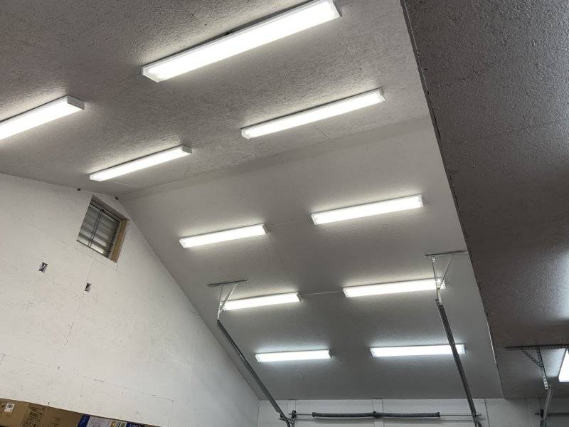

Installed 12 fixtures in my high bay this weekend. 24 5k 4-foot LEDs is bright!
