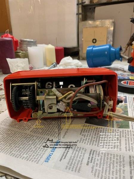

I needed a new alarm clock so i bought a vintage Copal 703 flip clock with alarm feature. Very nice looking 70s clock.
Unfortunately these have an inbuilt light that is permanently on.
You can't turn it off and i can't sleep like that with the whole room lit up. I didn't knew that pre purchase obviously.

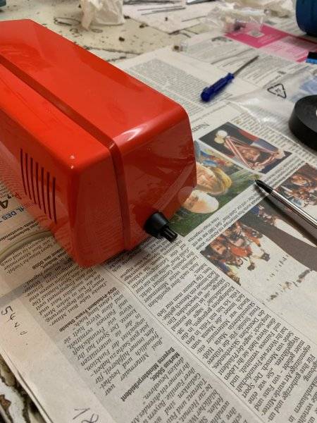

So i decided to try modifying it with a switch for being able to turn on/off the light as i like.
Today i successfully did that.

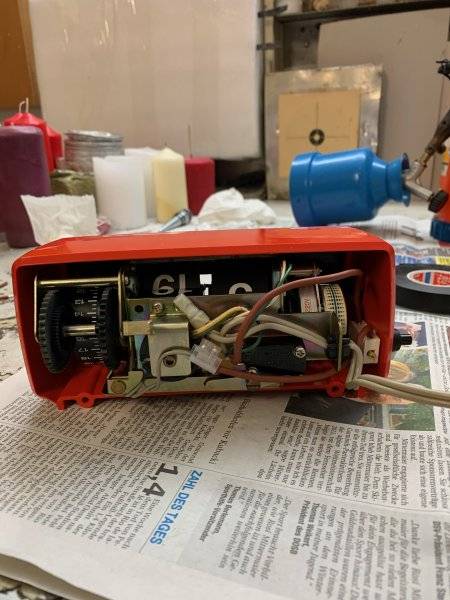

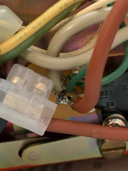

It was actually pretty easy. The hardest part was the 3 wires soldered to the middle pin of the "black box".
I had to unsolder all 3 and then later resolder 3 wires on there. Not to easy because you also cant access that area very well.
But i managed to get that done aswell. :)

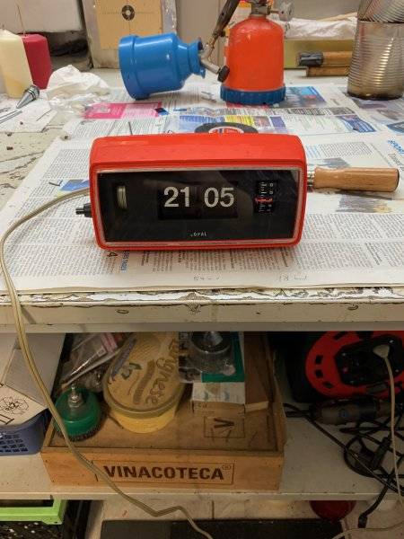

Now i have a very nice looking, actually usable alarm clock. :)
