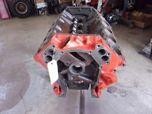

There is a bit of a window in the front of the block by the distributor drive. I figured I might be able to see some part of the gear through that, or at least get a magnet in there?
