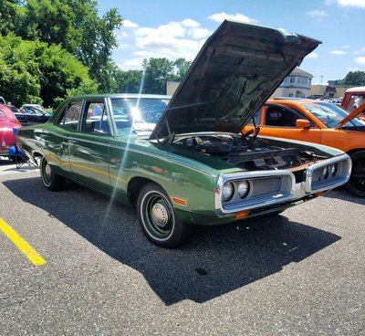

hey guys,
So I daily drive my 1970 Coronet Sedan which has its original 318, and pretty much everything else. I daily drive it and I've run into problems here and there, and I want to start driving it more which means I'll have to increase reliability. So here's my question, what things should I look out for on a car like this, because it's being driven a lot more now than it used to, and also what things should I upgrade or supplies should I keep with me.

That thing really looks GOOD !
