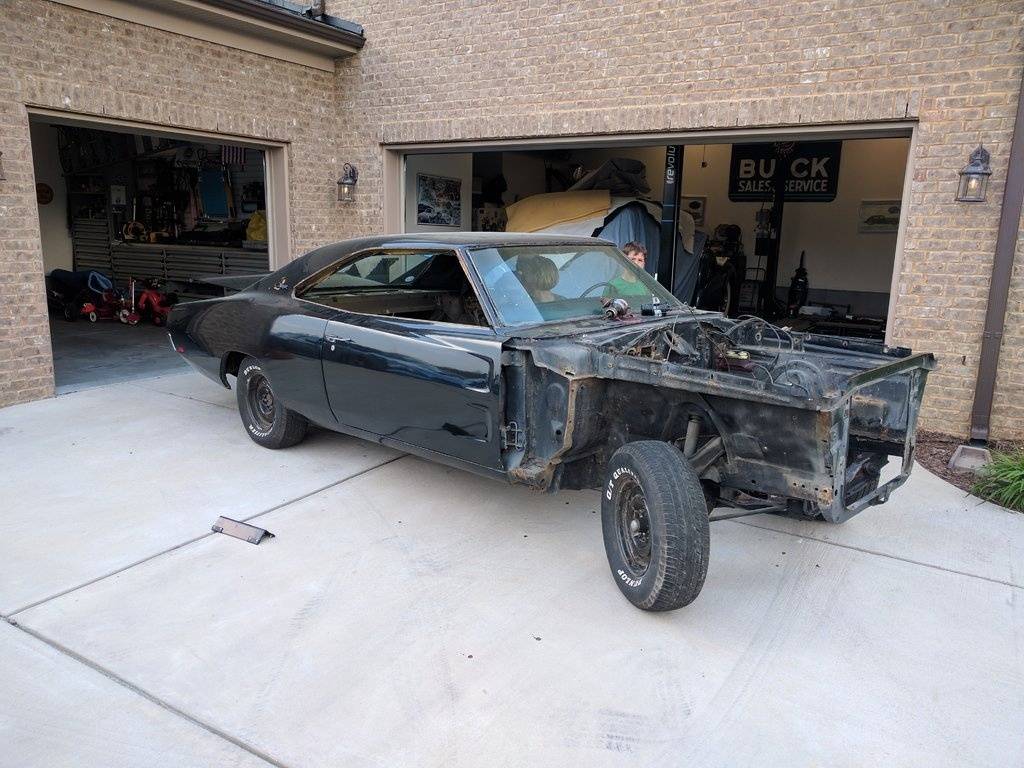

At the spurring of my "impatient" 5 year old son who wanted to know "how old will I be when the charger is done" I began another restoration in November of last year with some light disassembly. Over the past six months I've continued on and off with more disassembly down to what is now a rolling chassis that is nearing being ready to head off to the sand/media blaster and then get the misc. rot spots cut out and replaced.

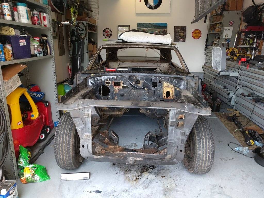

So made some progress the past week or so.
Stripped out the last things.

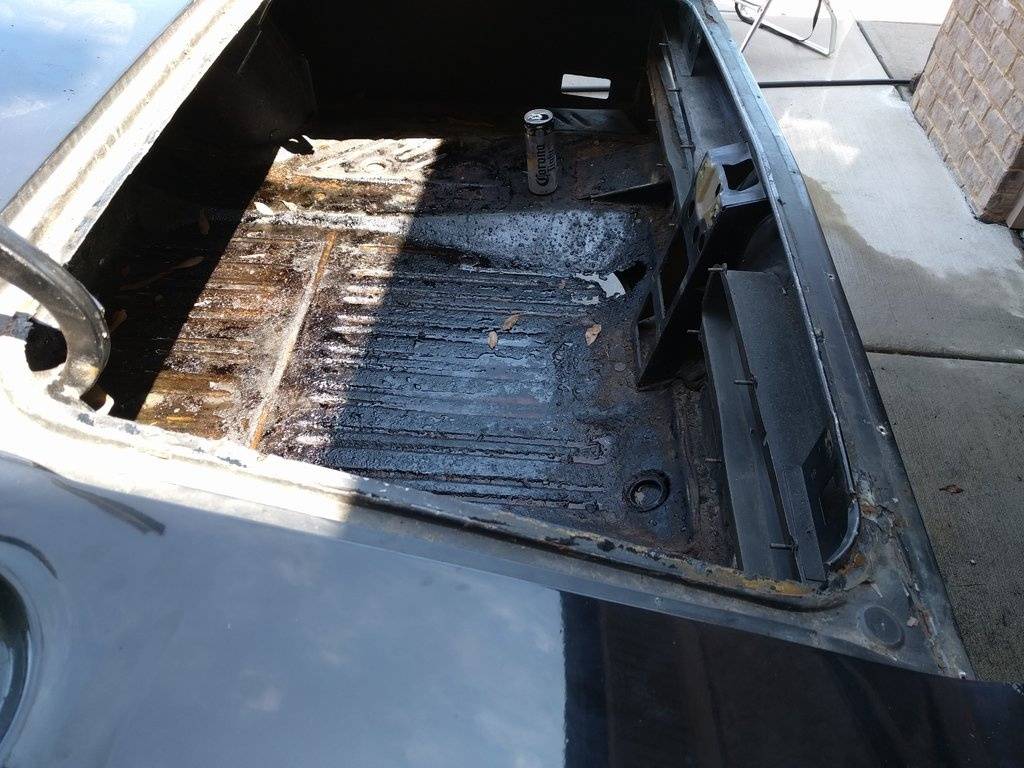

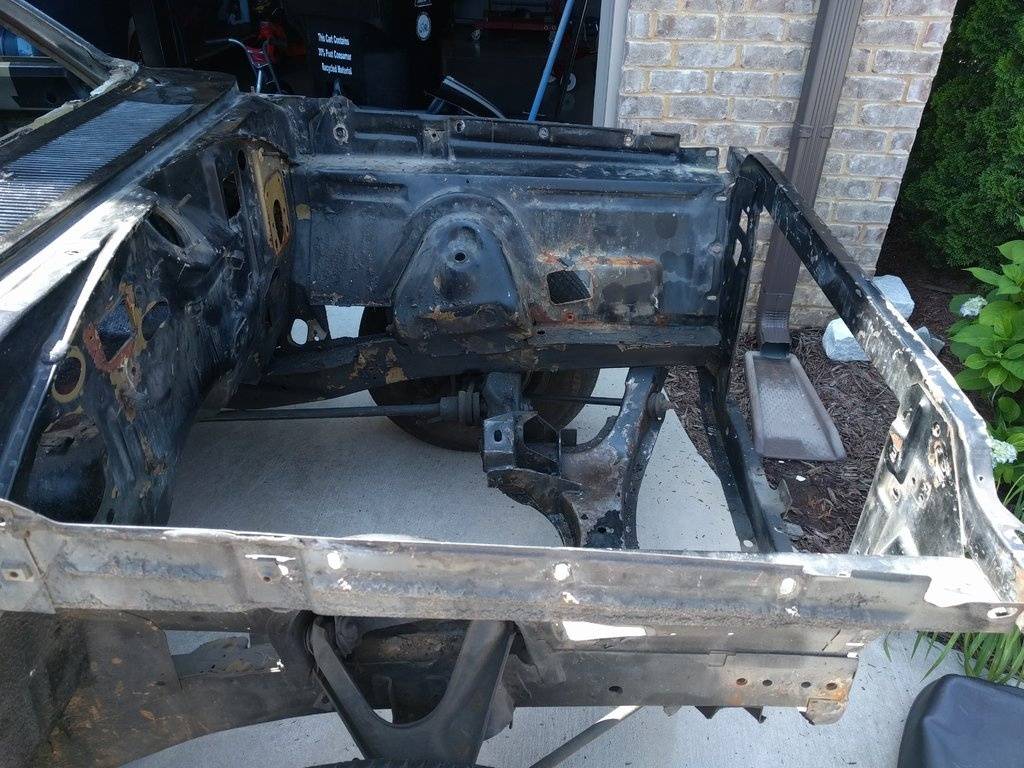

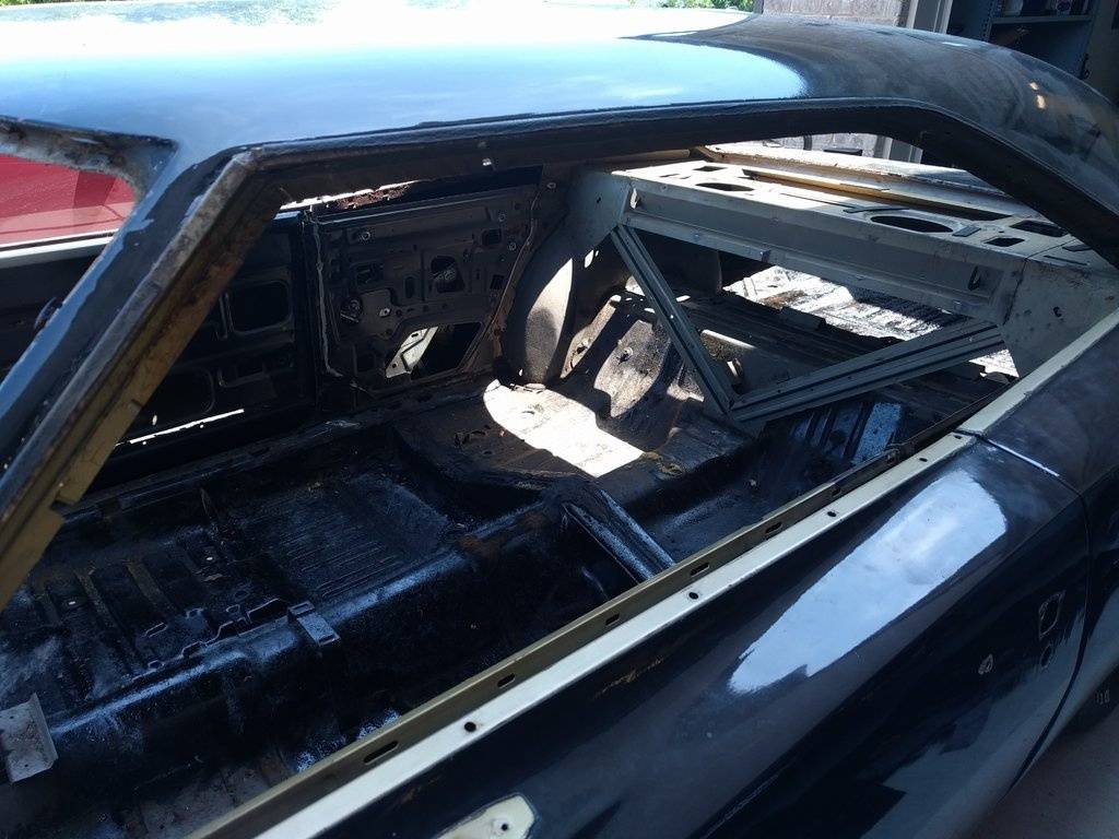

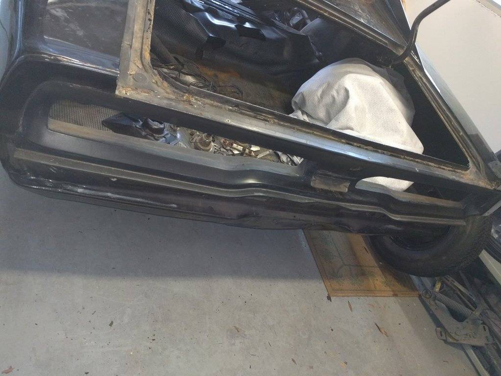

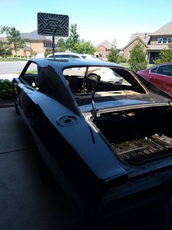

Below you can see some of the Rusted out areas

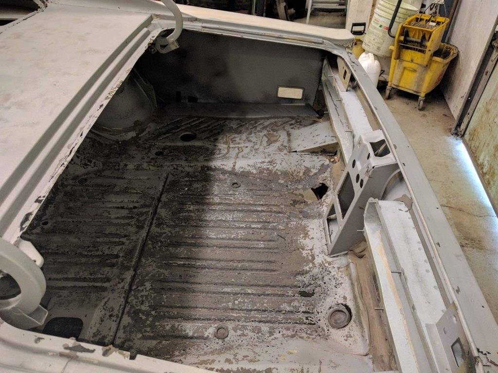

Truck Floor rot
Rear Window area Rot
Battery Tray Area Rot
off to the Sand Blasters and the shop doing the Rot replacement

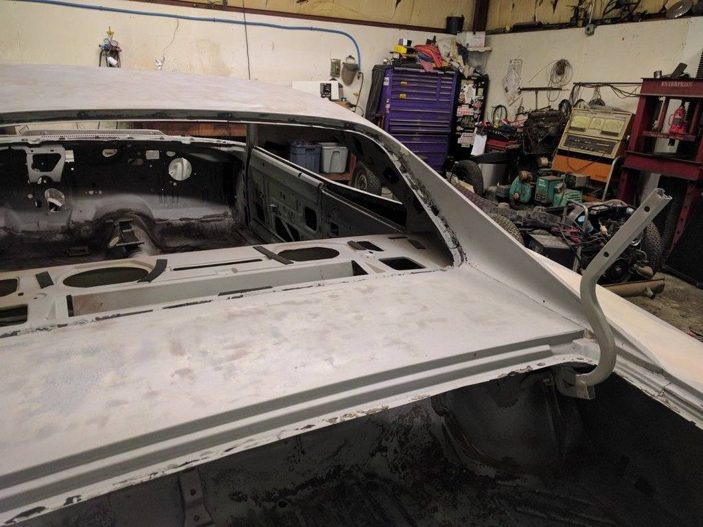

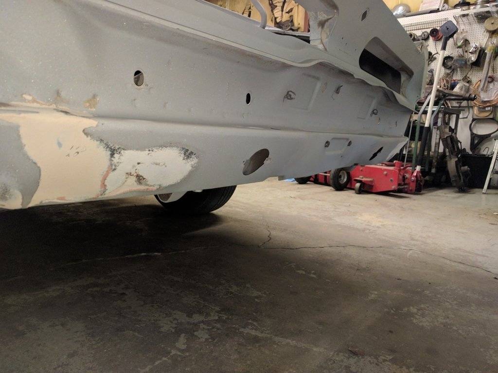

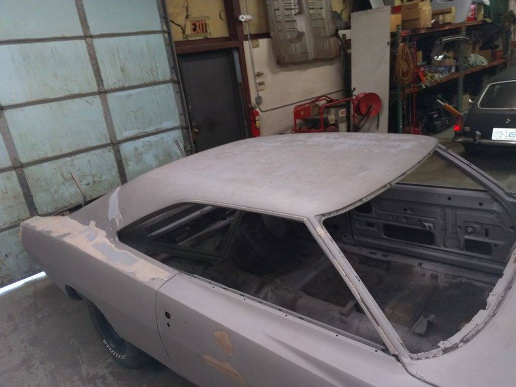

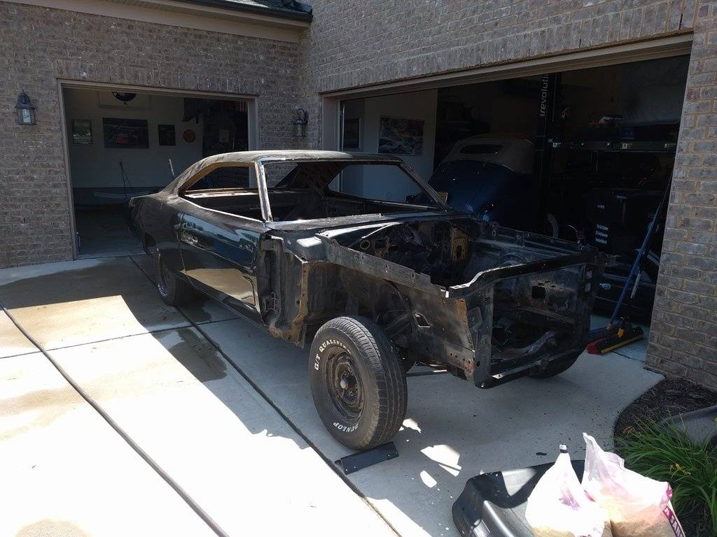

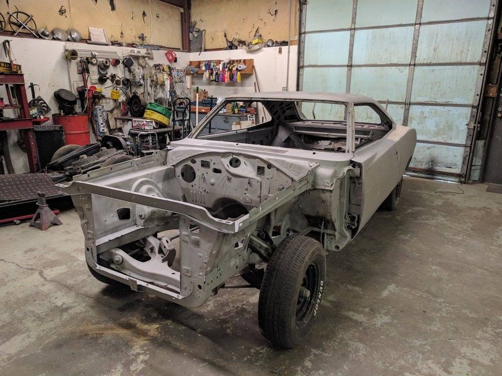

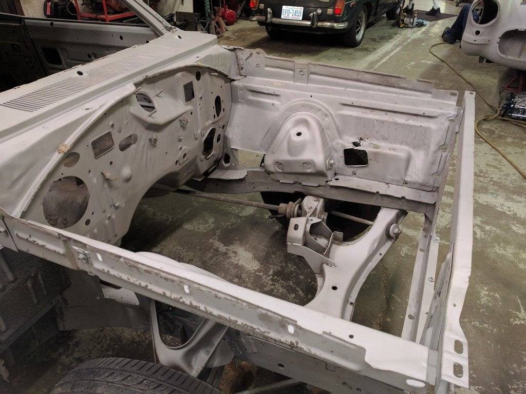

Sandblaster completed their work and the car rolled next door to the shop to have the rot cut out. Overall not much additional rot beyond what we already knew about which is good.

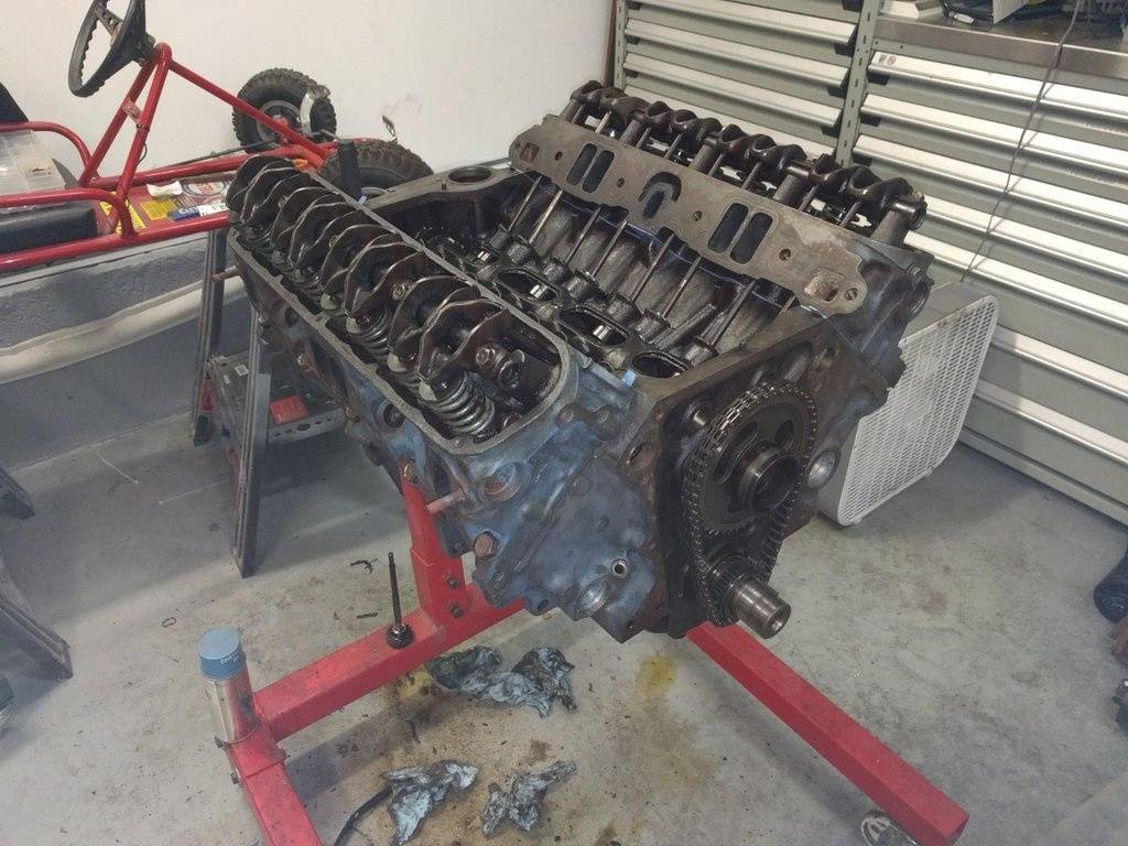

Also engine is coming along. Stripped it down the to the block. Check a rod clearance, all good didn't bother with mains as everything was running well with good OP before the restoration and not a ton of miles on the rebuild. No ridge in the cylinder walls either. Put the heads back on (the first thing to be reassembled). Intake, valve covers, timing chain cover and pan are being baked or vatted or something and I'll have those back next week. Got to have the wire clips on the one valve cover fixed but will reassemble all the rest. Then paint and push it off to the side to wait for reinstall.

How does the inside of the cowl look?
The body looks nice so hopefully that is good too.
But...... I've had a good body with a bad cowl.
Strange what rust seems to find.
You mean down in the air vent area? I didn't actually look, but with factory gold, orange, yellow and 3 black paint jobs I'm sure there was plenty of paint in there. The passenger compartment side of the cowl looked perfect.
Even the little "shelf" of rocker panel behind the fender splash panel, in front of the door was in good shape but starting to pit. The gentleman doing the patch panels said he is going to epoxy that area to preserve it for good.
That is a solid car!!! What rot you have looks to be an easy fix. What kind of timeline did the body shop give you for having it in paint?
Very nice! Looks good
~2 months... to clarify, only the paint I mentioned above and a full primer job top pickle it. Once I get it back I'm gonna do the suspension, put the drive train back in, put the interior items on the firewall, install the dash and front and rear glass...then we go for painting the body. Somewhere in there I need to have the fenders sandblasted and jammed out and the replacement hood underside painted and installed...then paint...

Also I got the intake, valve covers,oil pan and timing chain cover back from the vat. Reassembly below.
I am doing many of the gaskets one side only with RTV so I can take them on an off easily during the course of restoration until I am ready for final assembly, but still allow me to paint the assembled engine while on the stand. In particular I am concerned about the water pump and timing chain cover with the factory AC and alternator bolts yet to be hung off it. The harmonic damper is only on finger tight. I will pull it back off after painting. My goal would be to dress the engine in the car before putting the radiator back in.
Below is the first thing ready to go back on the car. Tough the engine and other components will actually be installed first. That's Seymour's cast gray paint (from Amazon) That thing was covered in 50 years of sludge,road grime,etc and took a lot of engine degreaser and wire brushing to get it cleaned up. I'm pleased with how it turned out. Certainly a nice motivation builder to keep pushing through the dirty job of cleaning all these nasty greasy parts. I don't believe I will find anything worse than that to clean...close but not worse.

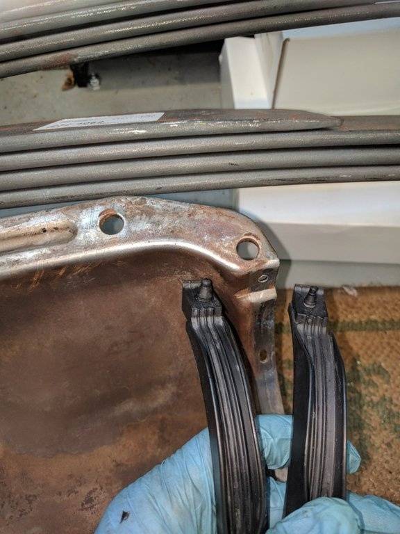

Ok I need help on this next bit. I was gonna put the oil pan on to get ready for painting and came across this. Note the oil seal has two "nibs" (not sure what they are supposed to be called). See below they are different sizes on each side. I have 3 sets of these gaskets and all are the same. the smaller "nib" can be pulled through the hole in the oil pan to seal tightly, but pulls out easily too. The larger "nib" I cant get in the hole ( I hate when that happens), it's too big (that's what she said). So.... whats the trick. I checked the shop manual and the Chilton's manual and both are silent on anything to do with this. Also should i be putting RTV on this gasket (both sides?) or letting it ride?

Those "nibs" are mainly for locating&holding the gasket in place while assembling,go with the smaller ones if everything else is correct size & put some 'gasgacinch' or similar on both sides of gasket when assembling & maybe a dab of rtv at any joint where gaskets meet each other.
Sorry looks like I didn't explain correctly. The "nibs" are different sizes on the SAME gasket. I have 6 gaskets all the same with different size nibs on each side of the same gasket.
I understood, if you try the "too big" ones they'll probably just tear off anyway(try them first though, you've got spares!)
