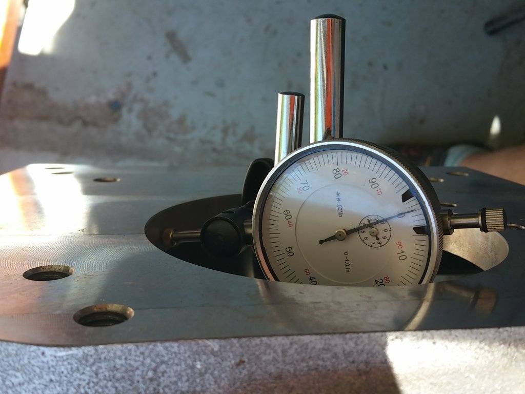

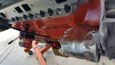

Got the flywheel on and checked run-out. Need off-set dowels.. Also test fit the starter..

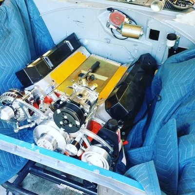

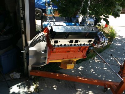

Well I got the Engine in, but the Oil Pan is hitting the Cross Member..
Going to mark the pan where it is close to the cross member, pull the engine and clearance the pan, while it's out, I am going to use the empty block to put the trans in to check clearance and measure the driveshaft.

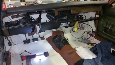

Dash is back in, and now it is time to start wrestling with the Spaghetti
Are you putting stock harnesses in? I have a stand made for my dash. Going to assemble everything on the dash then install it. I hate laying on my back being unable to see what I'm doing. I should be able to do 95% of it that way.
Going with the American Autowire Muscle Classic Update. It is not fully plug and play so I didn't want to lay it in yet. Left the dash open to make it easier to work around.

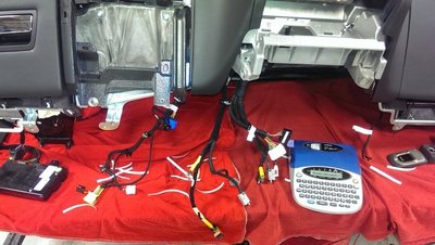

I should post pictures of the Maserati Dash I had to replace. What a PIA...

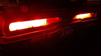

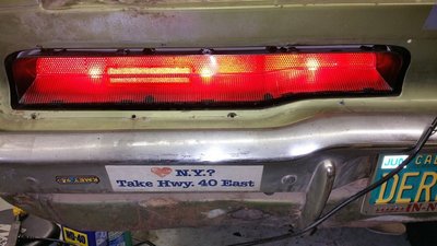

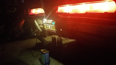

So I started the wiring, wired up and tested the rear lights.
Charger Tail lights.jpg Charger Brake lights.jpg Charger Tail light with NY stkr.jpg
Not Fun... I have done a lot of wiring work and dash work.. Worst set-up I have ever seen!
