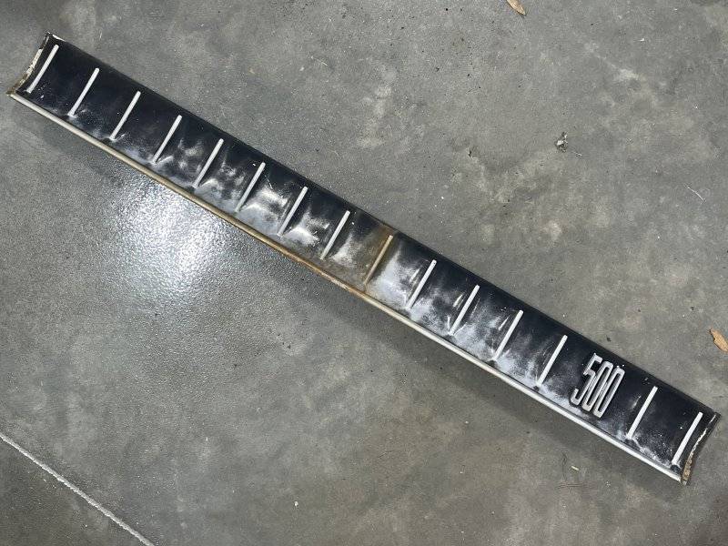

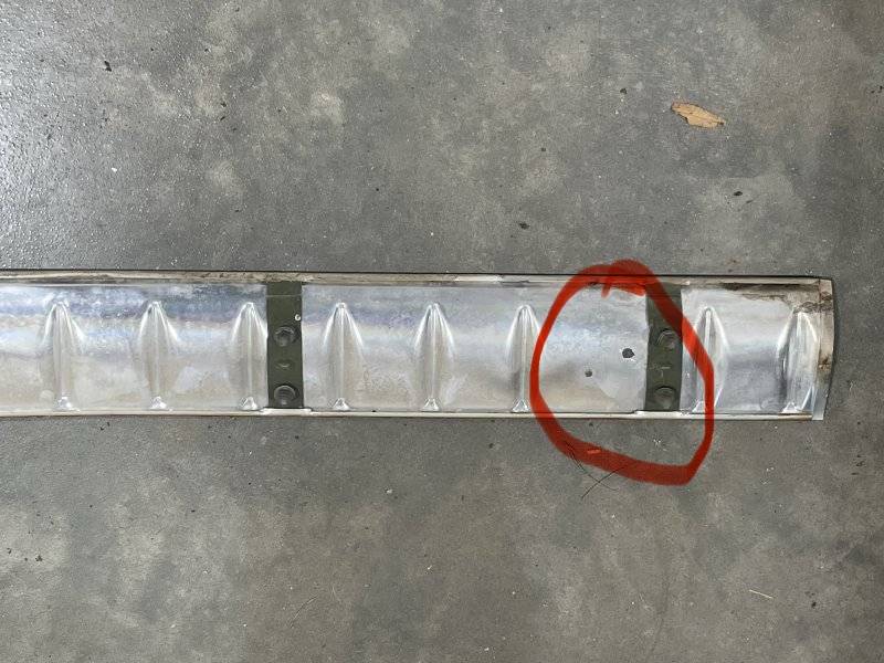

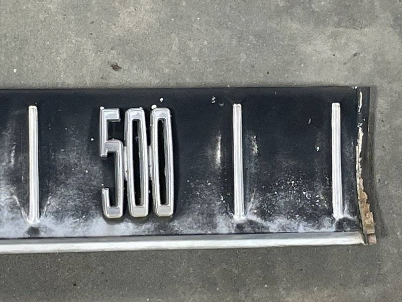

I have a nice tail panel, it’s for sale, and I see the black dots on the back that need to be ground down to remove the 500 emblem. My two questions are,
1. Are the locating pins on the R/T emblem in the same location as the 500 pins?
2. Is the R/T emblem held on with pins that go in clips?
The R/T emblem has pins and the inside pin is farther inward than the entire 500 emblem, so drilling is required to install the R/T emblem.
Yup. the locations are different..But the R/T emblem will cover the 500 emblem holes... Unfortunately the Repo R/T emblem fit like crap....The contour is wrong & it leaves a couple pretty unsightly gaps....
The fact that the R/T emblem will hide the hole is very helpful.
The other question, as presented to me by a member interested in it, arises because he said the R/T emblem he has mounts with clips that the pin goes in. Maybe that is a reproduction and why it sits cattywampus.
So, I bought a repo many years ago, the posts are longer than a original emblem... If you attach the emblem with some kind of clip the posts are so long they would contact the body panel and push the panel out from when it is supposed to live...
Anyway what I did was grind away the posts down to the step which is the stock height... Then I drill the remaining posts to accept 10-32 screws...
After doing all, that the emblem fit like crap, so I started looking real hard at restoring my original emblem.... But then I happened to see an NOS tail panel emblem on Ebay.... The original & the NOS emblems fit perfect... And yes, I drilled & tapped the NOS emblem too...
