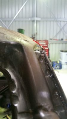

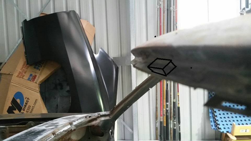

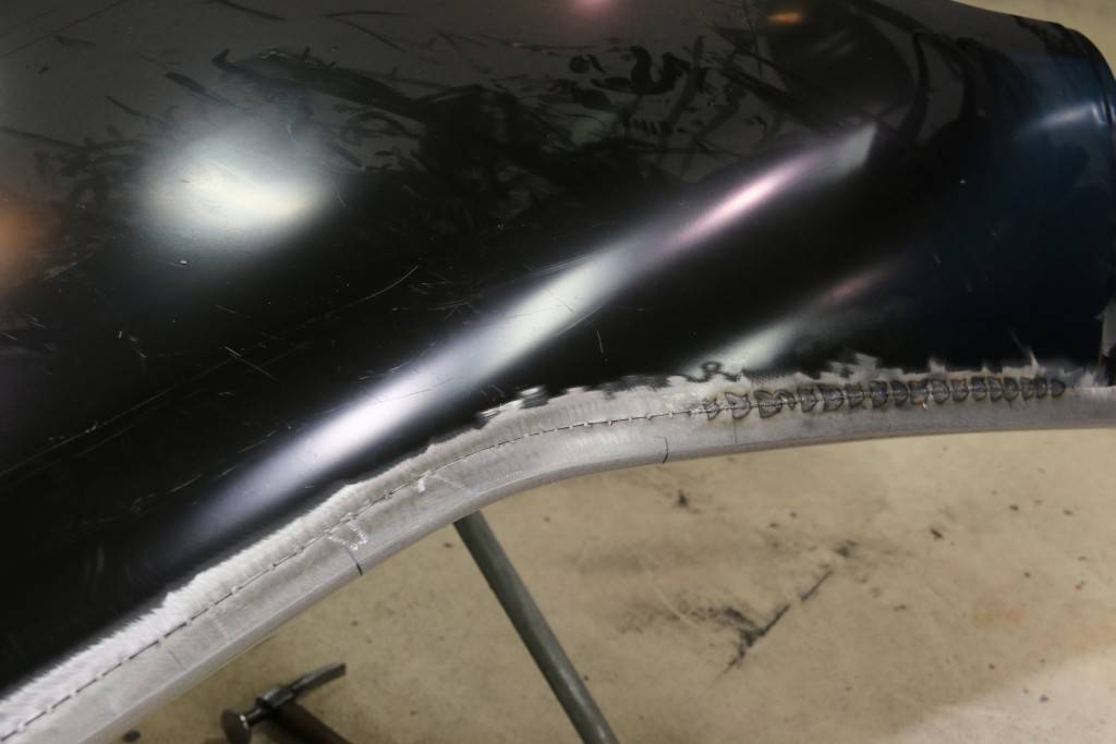

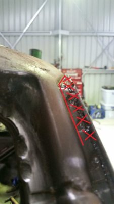

what do you guy reckon on the 2 options for removing the drip rail?
option 1: cut off the drip rails and weld the 2 x joining surfaces together?
option 2: cut 50mm or so off the roof and add/weld a strip which joins to the u channel of the drip rail?
also with flush mount windows i am not reusing the old windows as i dont have any so when the time comes i will get some custom made ones but to bring the height of the sheetmetal up higher so the glass is flush would it be better to remake the window flanges or just weld in spacer blocks? spacer blocks would be hell of a lot easier.

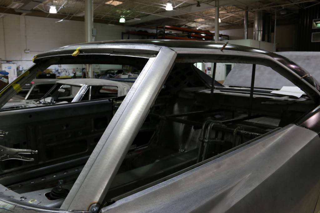

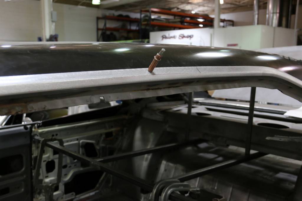

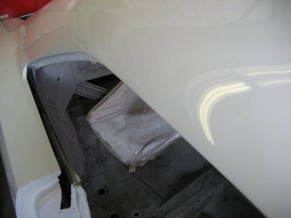

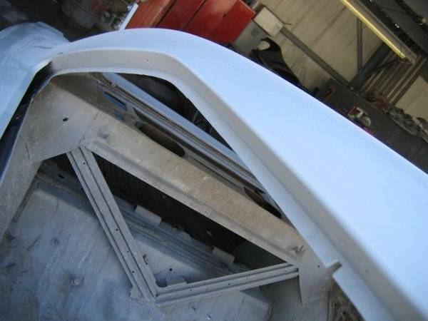

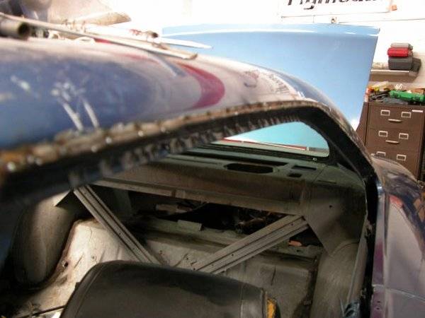

you can see in the attached photos what the roadster shop guys did, but i dont quite understand how they accomplished it, but the sort of look i am going for.

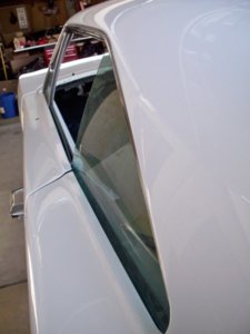

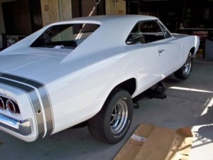

I shaved my driprails on my 68 Charger about 9 years ago - - - didn't do flush glass because I liked having some window trim to break things up --- I literally took a grinder and cut the rails off and then used a small strip of metal and covered the seam that was left behind where the drip rail / roof skin mated together.

I had a tough time visualizing one of our cars without the drip rail... but damn that looks good.

The window gasket channel screws up from the opening - so it is not effected by removing the drip rails -- the drip rail trim is no longer used - I also deleted the belt molding and didn't have a vinyl top so none of the trim looks "out of place"
The appearance looks a bit different because you don't have the visible window gasket strip then the drip rail strip "stacked" in appearance from the side... this way you only see the gasket track.... I polished it so it looks better and looks more streamlined. If my car was a grey or silver I would have had the trim powder coated black so it "disappeared" - but with the white the brightwork brings out a lot of contrast and looks better than blacked out trim IMO
looks great, the small strip was it a solid round bar or folded plate?
