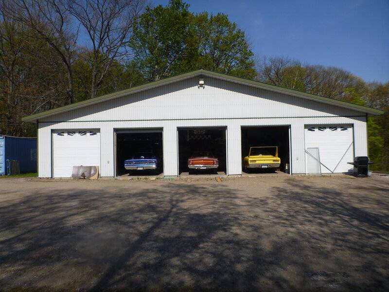

I built a 28’ deep 40’ wide pole barn a few years ago. 10’ ceiling and storage trusses with a staircase. I don’t regret it one bit. It’s sided and shingled to match the house. Went up in a week start to finish.
You’ll never say you wished it was smaller.
Thanks, could I trouble ya to send a photo?

Whatchu talkin' 'bout Willis, you also have an aircraft hanger!
I figure that your garage has got to be 50-52' wide.

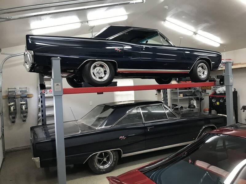

I did a 30x30 stick garage a couple years ago. 10’ walls with scissor trusses. Ran them from to rear so both bays could have a lift. I don’t have any attic and the entire building is insulated and drywalled. Also did my garage doors so they follow the roof up. I have one 4 post and I can have a car up and get the garage doors open. I also shifted the bay doors over so I had a nice workspace on one side. That side also has a man door. 2 windows in the rear across from the garage doors to get air flow.
Waa...waa...what RC? I have no plane hanger, sounds nice to have though.

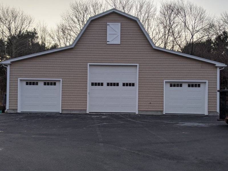

Trust me when I say that you'll want 10' wide garage doors. Now, if you're at 36' wide, you might as well go to at least 40'. It'll look better proportioned. Draw it out on graph paper to see the proportions.
My garage above has two 10'-0" wide X 8'-0" tall left & right & a 12'-0" wide X 12" tall door in the center. The 12'-0" wide gives enough room to walk through the opening without getting too close to a vehicle.
