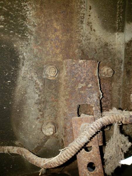

Drivers side bracket always bolts in, as it's an option installed on the line.

Drivers side bracket always bolts in, as it's an option installed on the line.View attachment 1484569
You are a life saver thank you lol, I didn’t know that the bracket bolted on which would make sense but lots of things changed on the California cars so nothing would surprise me and being an emissions year car

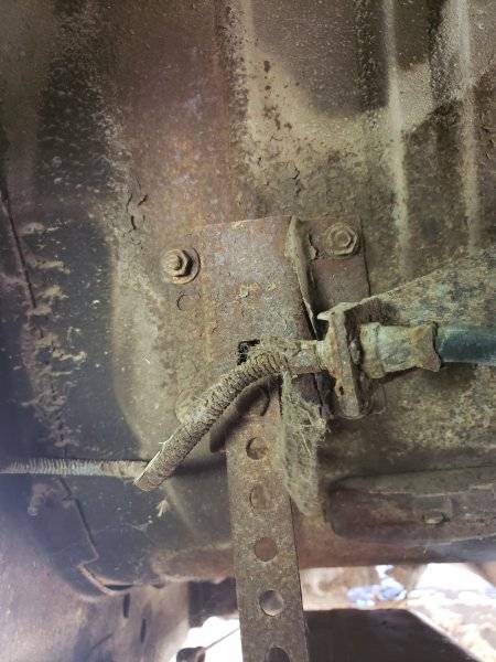

Here's some pix of factory dual exhaust hanger, I'm thinkin' it might be reproduced. Under your backseat, on the floorboard will be 4 dimples that correspond to the outer bracket which is where you drill your holes. Pix are from a 71 R/T.

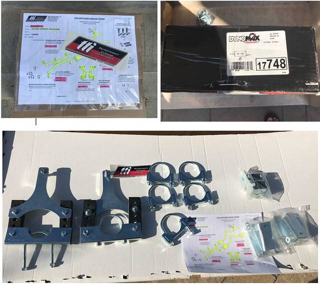

I purchased the full 2.5 exhaust for my 72 Charger. Here are some of the parts.
Ah alright so I see the brackets I need but with my kit I have the factory style hangers with one over the axle and the other on the floor but the bracket looks to be the same for the floor
Thank you for the picks they will definitely help with getting my exhaust situated, luckily my floors are in perfect shape and original so I want to drill once lol

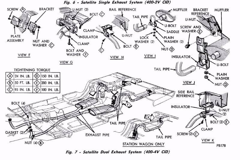

Single vs. Dual exhaust, nothing to do with California vs. federal production.
Figured I just wasn’t sure exactly because I personally haven’t seen many of the California cars in original orientation like mine was when I started but now I know what I was missing other than hangers and now I know a bracket for the floor, thank you for the diagram though it’s much appreciated
