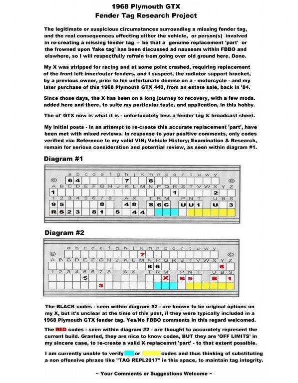

I have attached a couple of photos that outline the nature and purpose of this, my latest post.
I know the info I am looking for, is a little sensitive in nature, so if you are not comfortable in posting or sending me such info, I completely understand.
Should this be the case, please simply round off your numbers, to disguise and ensure the security of your actual numbers. Either way, the results for
me will be a big help. I will look forward to any such information you have along these lines, that will help me create a new & accurate '68 fender tag for
GTX...
With this additional data, I am hopeful upon my later review, to more accurately determine, the average number of cars that were produced on a daily basis
at the Lynch Road plant, back in '68. I can then also estimate with more accuracy -when my car rolled through the Lynch Road plant... using my partial VIN
instead of the usual (and unfortunately in my case) unknown 'Series' number, for this purpose.
To recap... after reading my comments below, I am asking for '68 Mopar owners who have identified that their rides were built at the 'Lynch Road' plant
by the method described below - to kindly share the 4 assoc. data fields [highlighted in red] blocks beneath my comments "MORE RESEARCH REQUIRED".
To date, my estimation of daily production, based upon only one known fender tag, dated May 9th 1968 - seems a little high to me.
More data, would be helpful in this regard.
Thank-you In Advance.

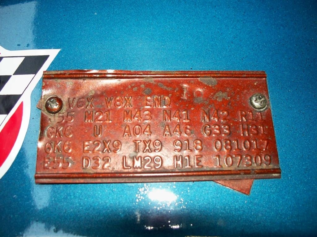

Make sure to bend the top left of the tag a little then straighten it after you put in one painted screw then the 2nd screw should be unpainted.
once its gone
you can only create a fake tag
unless you somehow have a copy of the original tag available.
Is that correct for 68 Lynch Road tags?
I have no idea, just have seen them like that many times and heard the explanation, made sense to me. Not sure if it was common practice in any or all factories.

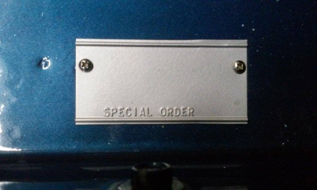

Mine was missing but I did have the build sheet. Galen Govier certified my Sport Satellite. Since it is only a "fake" GTX, I didn't care that it didn't still have the fender tag. But I thought it would be cool to fake out the Chevy and Ford guys, so I found a "SPECIAL ORDER" tag online (I think they were used for fleet cars like taxis and police cars) and that is what I put on my fender.
Anyway, I think that SO numbers are stamped into the radiator cross brace in 1968.

As a follow-up to this post, please refer to contents within attached photo - to avoid word wrap issues, should Murphy kick in here. lol.
Since laying out this amended (and hopefully corrected) tag info - I have since checked out the rad mounting bracket and observed a
number on the top driver side...A8RA11710, which is nothing like I was expecting to see. Certainly not a 6 digit VON, from what I know
about such things... Concerning this latest rad # info; the additional contents attached, and my known pref. for diagram #1 - your comments are always welcome :)
A11710 is the SO number. It starts with "A" because the car was built for sale in Canada.
Thank-you a tonne, my friend. I will now peel back the ds weather strip on trunk lip edge and compare #s to determine if the rad core support belongs on this car. There is hope, I can get this figured out yet... Will keep you posted. Now, if I can only zero in the the SPD, this could be worth doing correctly.
