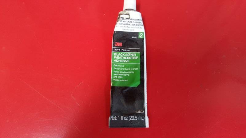

Use the black felpro gasket and glue it to the valve cover with 3M black weather strip adhesive. Let it dry.

Set the cover on the head immediately and only finger tighten the hardware till the gasket maker just starts to ooze out. Let it dry for one hour and then hand tighten with a 1/4 drive socket. You don't need to tighten them any more than if you were useing screws for fasteners and a screwdriver to tighten them.
Let the sealer cure for 24 hours before running the engine. Guarantee this will work if you follow the directions to the letter.
I even pulled these once for inspection and place them back on and they're still dry.
