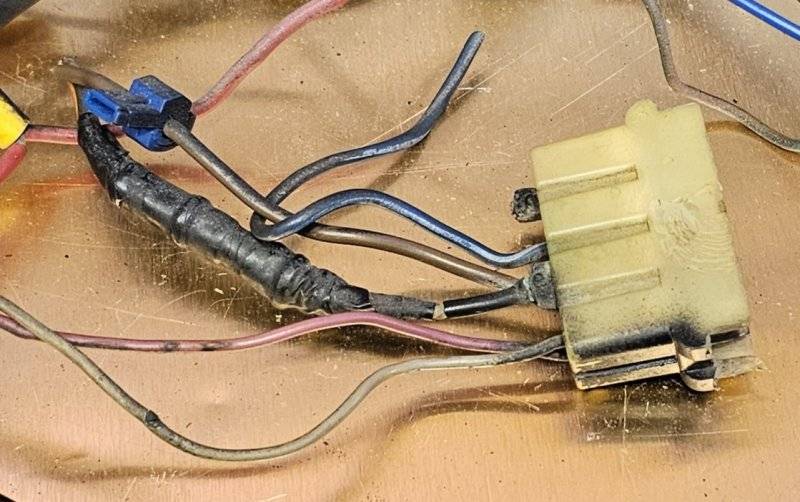

I bought 3 ballast resistors each time fixed the problem temporarily. Bought a FBO ignition, to bypass the ballast resistor... wouldn't stay running again! Well I know the wiring was pretty shotty so I just decided to by a new harness. This was my first time doing this... needless to say, I'm guessing I found the problem. Works great now!
The tabs were even broke on the connector so it was just sitting in place. I probably kept bumping it causing it to be loose and lose the connection.

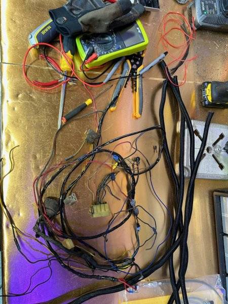

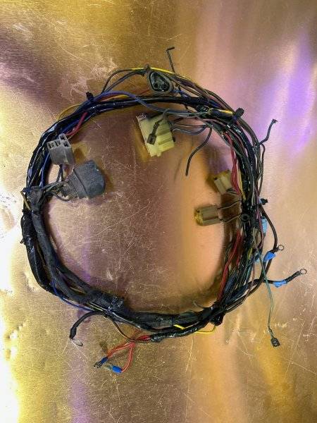

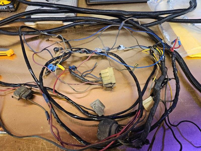

Don't know what's all going on here. Just a mess. I think they got it good enough to run and sold it... (To me). Now I'm going to do the dash. I'm sure that's 100 times worse.

Yep! That's a mess.
Dash harness is not that bad. Mark the old harness as you take it off. Ive done 3 and not that bad. Have fun :D
FYI,some dash harnesses have extra wires do to different option. 1970 super bee and charger same dash harness but extra wires for charger headlights. M&H harness is plug and play. Make sure that it is in stock or you could wait a good 6 months.

Cheap at twice the price. That old harness would make Smokey Bear blush. It was a fire hazard!
Well it is now a Christmas Wreath. No burial required!
Looks like typical butchered, old car wiring. Do yourself a favor, avoid having the "hottest car" in the area[ due to an electrical short derived fire] and REPLACE from front to back. Keep the old molded plugs but boot the rest.
