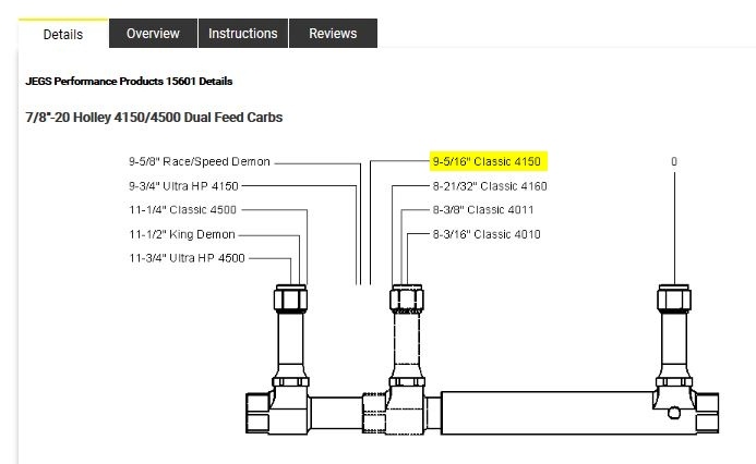

One must consider which fuel line kit on the market today, is best suited for my mildly modified 440 street application. Quality, is also important, and something that I am willing to pay for. There are many vendors out there flogging such products, and likewise, an endless stream of buyers, who have posted BAD experiences - involving poor quality, leaks and fuel port alignment issues, given the wide variety of measurements stated by vendors. I suspect a person must be ‘extremely’ careful in their kit selection, given all the confusion, when dealing with variable duel port (center-to-center) distances and the lack of some kits, to properly align, adjust & professionally secure their fuel line kits - to a model 4150 (Double Pumper) - not to be confused with the longer HP version.
I am leaning towards JEGS #110824 Fuel Line Kit as illustrated.
I have also tossed in a photo for fun, illustrating many of the various (center-to-center) measurements reportedly out there today. No wonder, so many people have had problems. Perhaps, I should just build a custom fuel line kit from scratch, using quality parts - although I shouldn’t have to go to all that trouble to avoid the: (9.25; 9.313; 9-5/16; or 9.50 )center-to-center kit selection confusion, surrounding a Holley 750 cfm ultra double pumper carb. Many kits say they are 4150 compatible, but are not 9.313 (center-to-center) - which I believe, is the correct measurement. Some are saying, not even Holley's fuel line kit, for a 4150 model carb fits correctly, on an ultra double pumper. Really? No worries, I'm no longer considering their fuel line kit product anyway, for my own reasons.
