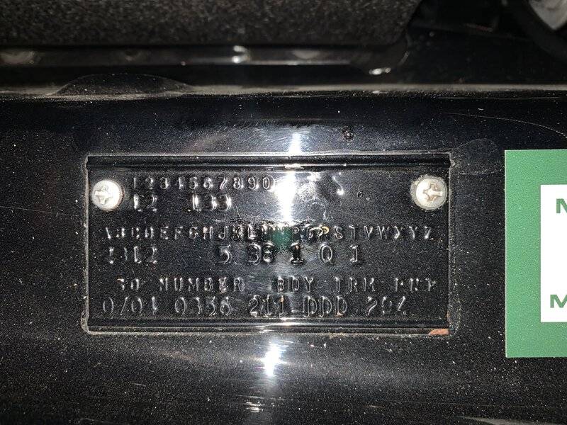

Hey folks! I’m working on decoding this fender tag, and have come into some obstacles. I have decoded half of the codes, but need some help. Here they are:
A=2
B=3
C=1 manual 3 speed trans
D=2 power brakes
J=5 front heater with defroster
L=3 bumper guards front and rear
M=8 windshield washer dual jet
P=1
R=Q
T=1
Let me know what you know! Much appreciated!
Fourth digit 1 in the vin is Lynch Rd plant
A is the engine 2= code 502 225 1bbl 145 hp
B is the trans 3= code 343 Torqueflight 6 cyl only
Heater looks right code 385
Need more time on the rest.
Thanks guys! Any more help would be appreciated. I guess I was wrong about C=1 if it had an auto trans..
