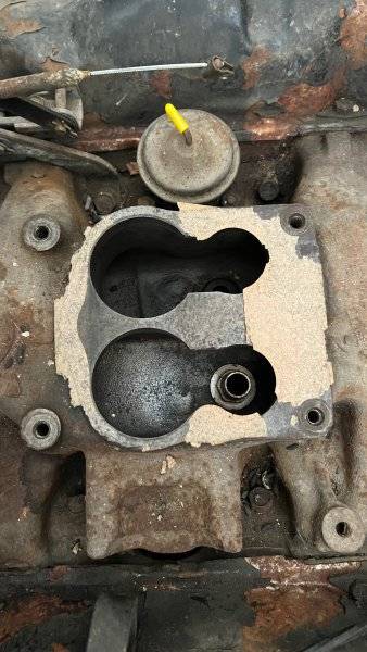

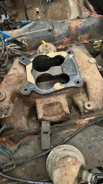

Looks like somebody has already done a 2bbl to 4bbl conversion. Any idea what intake this is? It's a spread bore 4bbl that still has the EGR setup.

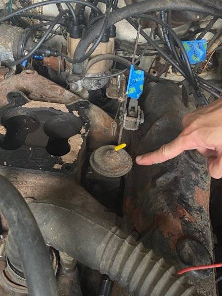

Since the old quadrajet is in rough shape and missing some bits, I grabbed a reman Edelbrock 1406. Right now, the linkage hits the EGR on the intake. If I use a square-to-spread bore adaptor, it should move vertically enough for the linkage to clear. I could also delete and block off the EGR, potentially.
Also, looking at the linkage, any idea what is going on here? It's real loose and floppy, but I think it's actually the right setup, since it was hopefully running the 4bbl at some point?

Not sure what intake that is but yes make a block off plate and get rid of the EGR. Its not needed. Spread bore to square bore adapter plate yup looks like you have most of it figured out.
Thanks so much! Adapter plate is on the way! We'll get this motor running, then it's on to trans and brakes!
