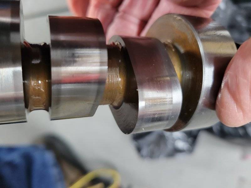

I am taking the solid roller out of my Hemi and going to a hydraulic roller. I am not a gold member here, so can not post a picture of my camshaft lobes. I have been told that the wheels on a solid roller get out of round over time, a few thousand miles, 3 to 5? Then what. Have a picture of what the lobes look like if you care to pm me your email address.

Glad that you corrected me on the PM! Here's my cam picture. See the chatter marks? What do you think?
