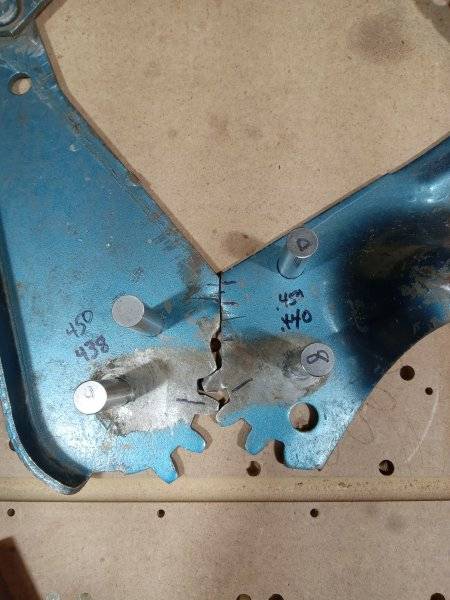

I have the same problem with my hood hinges. What I have found is the teeth have worn out leaving slop in the teeth. Which you see when you close the hood and one side stays up. I have a few sets of hinges and they all seem to be worn. I am currently working on this and will more than likely involve welding up and re-cutting the teeth.
Here I cut a sample. Notice how the teeth are much better
