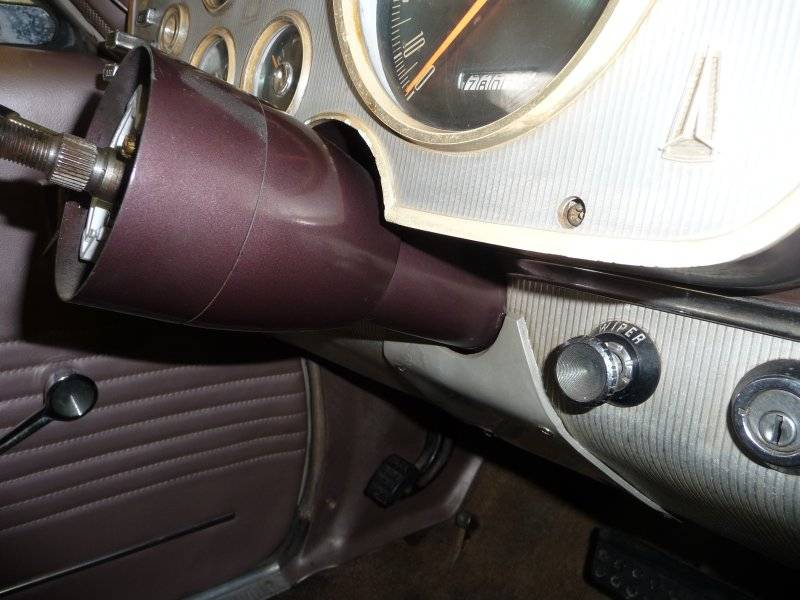

My steering columm and dash cluster pod are the orginal paint ( luminous Cordovan) . By the Luminous Cordovan is a Burgundy Metallic . So how close wil the modrn paint match the orgial color ??

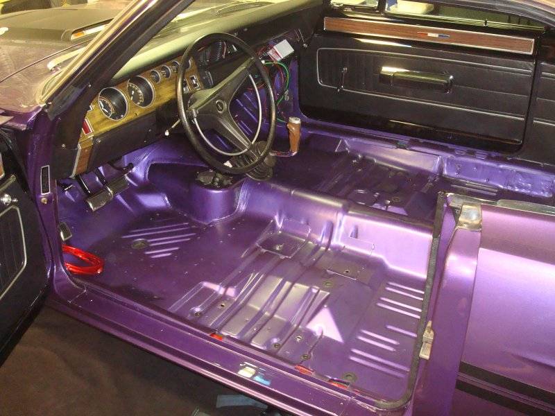

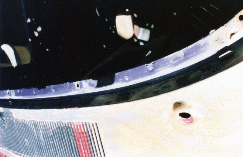

Interior shot is the same base coat with a matt clear to keep the paint sealed and clean. Windscreen is unmolested from original.

Kid, what type of paint and brand did you use on your steering columm and dash gauge pod ? This is the color I could use the most information about, any help would be great. Thanks Pictures ?

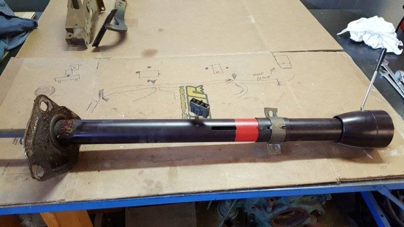

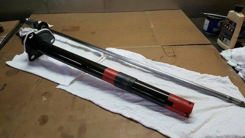

Mine was a brown in color. I cheated and used a spray bomb of Rustoleum brown I found in the paint cabinet.
Before
After

The only place I've seen this color is on old paint chips (internet pics and the look different ) and on my steering columm and dash cluster pod.)

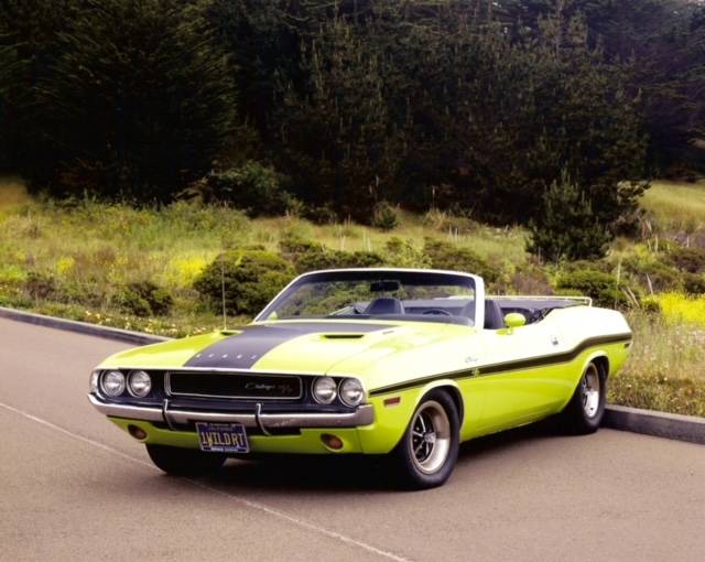

Check the reflection on the side of my Challenger...
Realize, this is a fairly light color, darker colors reflect and show depth a lot more..
