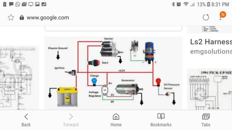

If the engine was on a stand - what would the electrical wiring look like? The absolute bare minimum? Also would use this same setup to test "junk" motors on a stand.
Any help would be appreciated. This damn car is frustrating the hell out of me. I just want to eliminate ALL car electrical and get it started - then I can go from there.
It would look like my tractor with or without an ignition switch. Toggle switch to coil, coil to distributor and a push button to the starter oh yeah and the block grounded. This will give you an idea, just leave generator and regulator out.

hot wire to positive side of coil, hot wire to touch starter Bendix small wire, assuming battery cable is connected to starter that's how I used to steal the old mans car in the 70's

very long story but tried that... worked earlier this year... but now that I got it back the car does not have FIRE and need to eliminate the electrical part(VERY VERY LONG BAD STORY)... The motor did run and run good just need to know it still does
It would look like my tractor with or without an ignition switch. Toggle switch to coil, coil to distributor and a push button to the starter oh yeah and the block grounded. This will give you an idea, just leave generator and regulator out.View attachment 668730
the distributor does not have points, do I need something else hooked up?
that's about as minimal as it gets, unless u wrap a rope around the front pulley
electronic ignition run hot wire to distributor
I am going to check today... but maybe the distributor got fried... when he drove it away... it was hot wired to the coil... only went 7-8 blocks away... but don't think he unhooked the wire when he parked it... read somewhere last night in all my many hours of research... if leave the wire hooked to the coil longer than 15 minutes or so, it could fry the distributor.. maybe that's what happened.... not sure... but would explain why no fire
