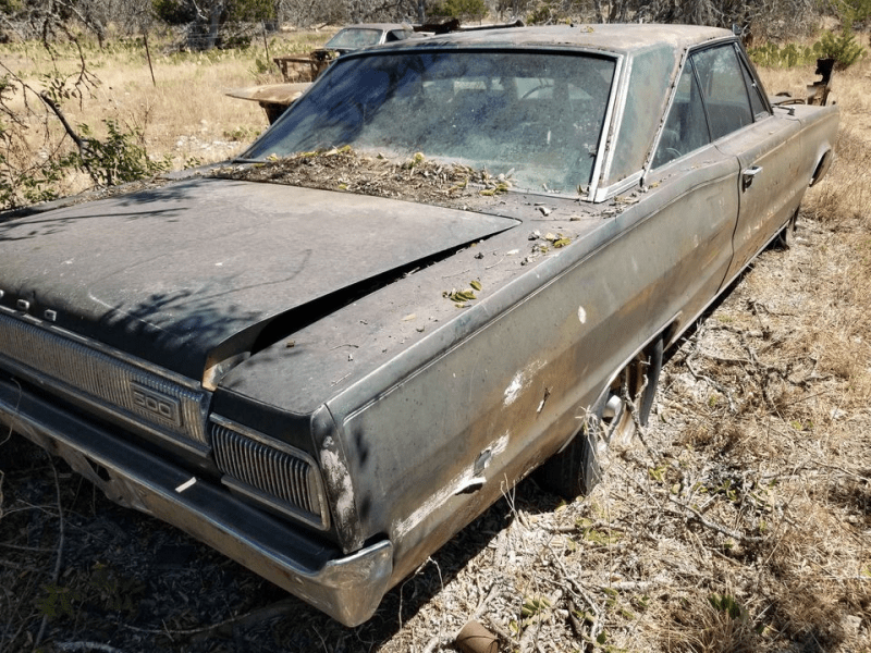

There is a car posted on several Mopar related facebook groups, for sale in Texas. Ad claims it is a 67 Coronet R/T. Build sheet picture shows WS23. Seller states VIN on car matches and that fender tag is still there although there aren't any pictures of those (that I have seen anyway). The problem is the car is badged as a 500, and does not have any outward signs of being an R/T. No badges, no R/T hood. In one of the comments the seller said it was a dual badged car or something like that. I know Chevy did that all the time (RS/SS), and I know the later Mopars did some weird stuff, but I have always believed that an R/T of this vintage was an R/T, plain and simple. The car is likely too far from me to be a feasible purchase, but part of me would sell my 68 R/T project to get into a 67 R/T. Any chance this 500 is really an R/T or is it possibly just a VIN/Tag switch that was done a long time ago. For those with FB I am attaching the link to the page (or at least trying to).

It has the R/T grille center.
...and no lower body side molding that a 500 would have had
but
you can see peeling bondo in that exact area
and
there appear to be no holes for the quarter panel R/T emblems.
Looks like it had the hood scoop. By all outward appearances, I'd say it is an RT.
Someone likely stole the emblems, then put on a 500 tail panel.
The quick check would be if it had a the 500 side trim holes filled.
Good catch on the hood scoop shaded area.
500 rear wheel opening trim may have been integrated with the body side trim.
..and if it was, the OP car doesn't have that.
If you're interested, ask for a pic of the VIN. Be sure to say "on the car" not the title.

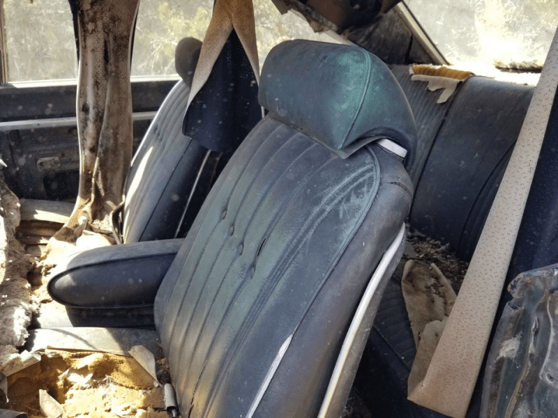

No engine in the car but he has a 67 440 hp that goes with it. Interior shows column shift, no console, AC, and headrests. I think for my sanity that it is a good thing that I am going off grid tomorrow for about a week, taking my rifle camping. Or I might spend too much time dwelling on buying another car sight unseen. So it sounds like it is more probably an R/T and not a 500.
I have never seen an R/T with fender mounted turn indicators. They were standard equipment on 500's. However the lights on the car do not look like Coronet ones. More like Plymouth bullets. Coronet ones were flatter and mounted more forward in the middle of the fender. It has an R/T grill centre piece on a 500 grill with factory black-out. Has R/T wheel well and sill moldings. Why would anyone try to disguise an R/T as a 500? Most people go the other way; making an R/T out of a 500.
Fender turn indicators not available on 67 R/T. Yes they look like plymouth bullets.
It has the correct wheel well trim and rocker trim.
The pinstripe looks like it is in the correct place and with angled ends like factory. But that paint color is oddball.
There is no dual model RT 500. Separate models. More like someone fishing for a sucker. Or have no clue what they are selling.

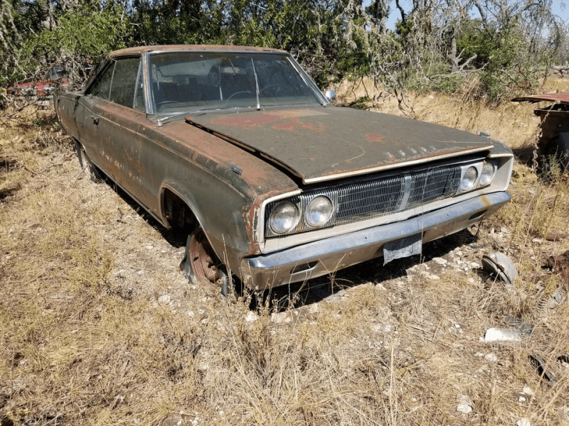

Here’s a 67 RT untouched I believe, been sitting for awhile in my neighborhood. Got the rocker trim and wheel well trim.
